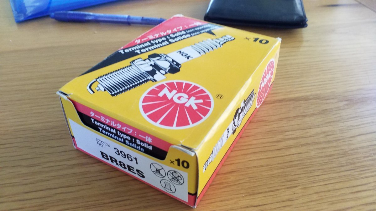

jackc Posted July 27, 2024 Posted July 27, 2024 (edited) 1 hour ago, Tony said: Received this email from Bert Flood:  Good morning. There are 2 types of spark plug,dependant on model 14mm MOD 99 -897055 12mm MOD17 -297656 I hope this answers your question. For your reference,the illustrated parts catalogue is available to view at :- Technical documentation | Manuals | Rotax Aircraft Engines (flyrotax.com) Kind regards Adam   My motor was one of the last ones produced as a complete assembly 2 years ago. Edited July 27, 2024 by jackc Add image 1
