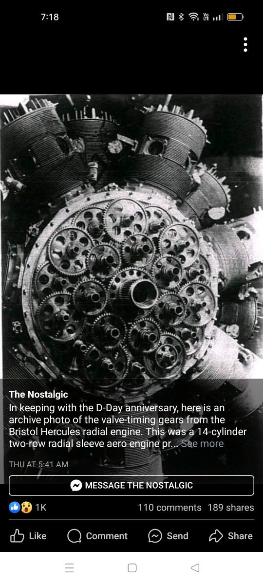

onetrack Posted July 20, 2024 Posted July 20, 2024 A friend is a former Bristol radial mechanic, he was in the RAN, and the RAN still ran Bristol Pegasus powered Sea Furies up until 1963. Despite their complexity, the Bristols were exceptionally quiet, and the Japs called the Bristol Hercules-powered Beaufighters, the Whispering Death, because the Australian Beaufighter pilots could sneak up on them at low level. 3
Ian Posted July 21, 2024 Posted July 21, 2024 (edited) The gears are for supporting the sleave valve engine design rather than the current poppet valve. https://en.wikipedia.org/wiki/Bristol_Hercules https://en.wikipedia.org/wiki/Sleeve_valve They have better volumetic efficiency and because you can have better combustion area design and no hot valve you can run them at higher compression rations on the same octane rating. The main drawbacks were the complex drive mechanisms, cooling the junk head and the tolerances required between the sleve and cylinder block. Modern machining techniques solved the latter and I've always thought that modern electronics and active cooling could solve the former points pretty simply. Does anyone a few million to waste on developing a new IC engine? They're quiet because the valves motion is radial not slamming shut and opening like poppets. Edited July 21, 2024 by Ian 1 2
facthunter Posted July 21, 2024 Posted July 21, 2024 They are a double sleeve valve arrangement and also twin row of cylinders A small link rod moves each sleeve in an elliptical motion. In cold conditions there's a lot of oil drag when starting, which can break the link rods. Bristol freighters had them too. . Exhaust noise is dependent on valve timing to a great extent and POWER output. Pressure when the port opens. . Two strokes unmuffled are VERY noisy and they have no poppet valves in most cases. Clunking noises when starting some radials are from the dynamic balance weights on the crankshafts at slow RPMS. Nev 2
Ian Posted July 21, 2024 Posted July 21, 2024 I think that the Bristol and all of there aircraft engines were a single sleeve arrangement. From the wikipedia article https://en.wikipedia.org/wiki/Bristol_Hercules#Design_and_development "The rationale behind the single sleeve valve design was two-fold" Some earlier British cars used a dual sleeve arrangement and there was a patent fight at some point from memory. The lower noise might relate more to the rate of the valve opening as it would be sinusoidal openings to a cross section rather than rapid release of a poppet. I'm not sure if I've even seen one in practice. The oil drag at low temperatures is an interesting point. I wonder whether modern oil chemistry solved this to any extent. Another engine design that is mind boggling is the Deltic which was derived from the aircraft engine the Junkers Jumo 204 which even today remains more efficient than even modern Lycoming diesels. The deltic was both light and powerful. https://en.wikipedia.org/wiki/Napier_Deltic https://en.wikipedia.org/wiki/Junkers_Jumo_204 https://en.wikipedia.org/wiki/Brake-specific_fuel_consumption 1 1
facthunter Posted July 21, 2024 Posted July 21, 2024 I think the double sleeve is a later development. It's far harder to do and IS more efficient. Quicker port opening. Very high exhaust port temps are common on early sleeve valve cars causing distortion. of the Blocks. . . I use Wiki a lot but sometimes it's annotated as requiring more confirmation.. Sleeve valves won't be making a comeback. Think of the load the pistons put on the cylinders when the conrods are at an angle. Those little link rods have to handle that. Nev 1 1
Ian Posted July 21, 2024 Posted July 21, 2024 The double sleeve was actually an earlier development and used on some European cars. If you look closely you can examine the pictures of the cutaways on the wiki page and see that it's a single sleeve. The design of the dual sleeve was very different at a fundamental level so I'm not sure how you'd go from one to the other. It doesn't really make sense to change the design from a single to a dual sleve especially given the fact the single sleeve was a later development. Not sure about the failure rates, however they were a complex engines compared to poppet valve. 1 1
