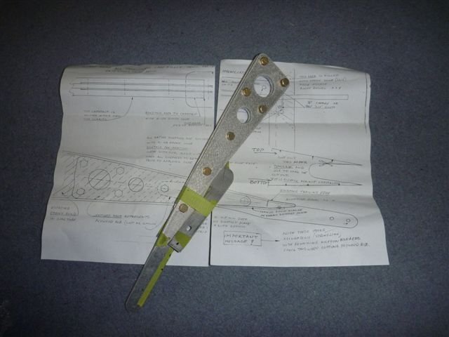

phonetic Posted 10 hours ago Posted 10 hours ago many thanks possible to scan the doc or take a high res pic of the doc instructions or where to find

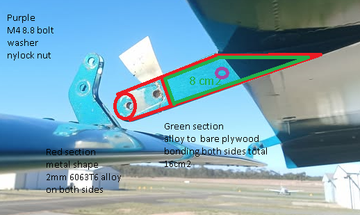

BrendAn Posted 10 hours ago Posted 10 hours ago 1 hour ago, phonetic said: Wow thats insane. im better taking a the risk pay $770 and submit Modification and Repair Approval Process MARAP proposal, saying SINGLE 25mm of broken 7mm birch plywood can be repared with a lap patch using metal carbon fiber ect as the remaining hangers are pefectly sound. Can use AI to ask what is the shear and peel rating of a lap patch using metal epoxy plywood, maybe get a Enginering student to write up calculations. I cant see a laser or CNC cut bit of metal costing beyond $500 ?? Or go to a sheetmetal frabricator locally, I supply the 6063T6 sheet. here is the damage again is the aircraft is now a economic writeoff but i think that would have involved cutting away fabric to change the complete hanger. it would be a lot of work.

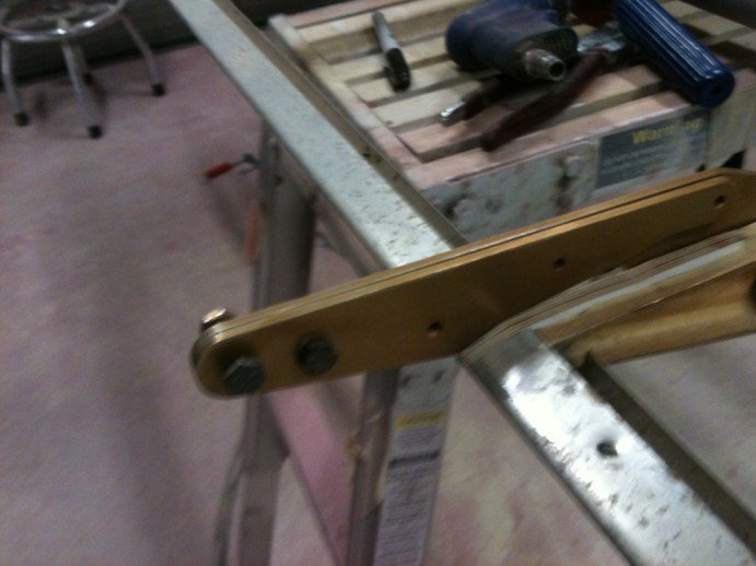

phonetic Posted 10 hours ago Posted 10 hours ago 1 minute ago, BrendAn said: but i think that would have involved cutting away fabric to change the complete hanger. it would be a lot of work. cut enough fabric to get access to rib use a right angled stubby chuck dril for holes & fasteners , the fix uses flat cut metal going by pic , rather than in the USA Kitfox used a bent drilled bit of metal, Im hopting only bolt hole damage not the whole rib and hanger damaged migh get a less intrusive method 1
