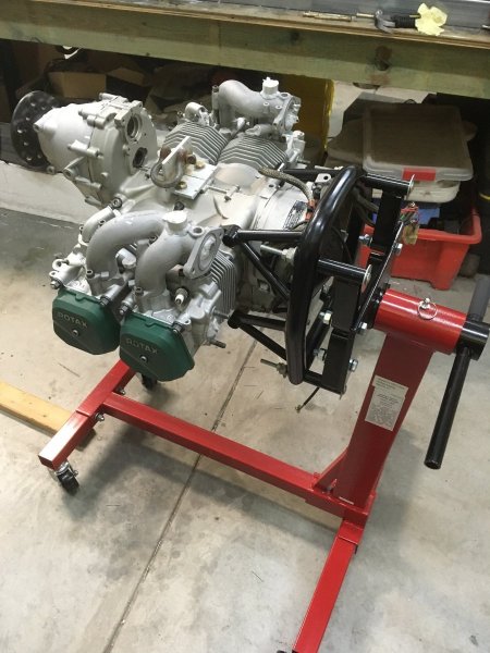

Kyle Communications Posted August 23, 2023 Posted August 23, 2023 The engine hasnt been run yet. My cousin is a racecar engine builder and he rebuilt the engine for me. It is also fully balanced and has a big bore kit fitted. He is also a Rotax certified engine repairer as he is a pilot and instructor as well. He told me he used the ford lifters as they were the best. The main thing is the cam grind. He did the cam as well. The lifters must rotate as the engine turns over otherwise the cam lobe of lifters will wear. This is my engine 2 2
Kyle Communications Posted August 23, 2023 Posted August 23, 2023 The cam lobe shape at the top has to do with how and why the lifters rotate. Edge had a issue with their hot cams that were not doing this until someone worked out that this was the issue

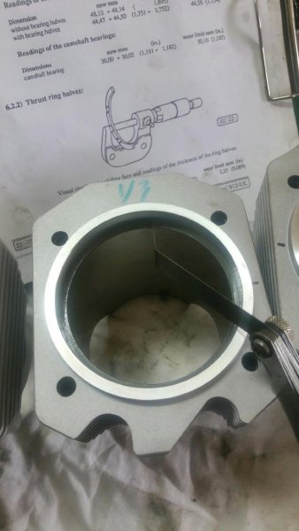

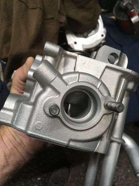

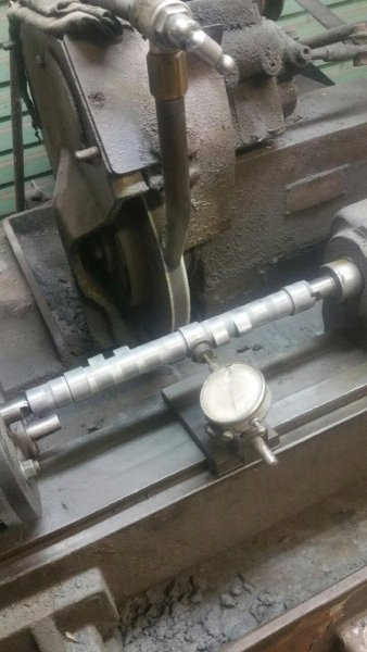

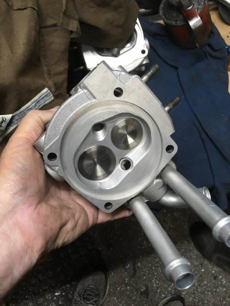

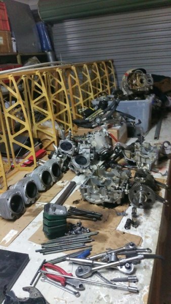

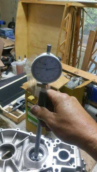

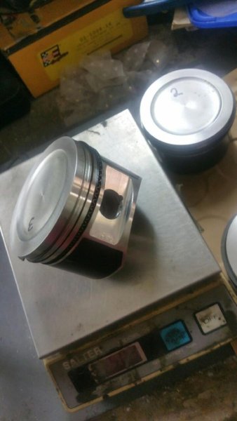

Kyle Communications Posted August 24, 2023 Posted August 24, 2023 49 minutes ago, Area-51 said: They are definitely rotating! Are the lifters standard rate leak down or fast rate? Any EDM port to the lobe face? What brand lifter are they? I am not sure. I trust Jim's experience and vast knowledge on what to put in engines and how to rebuild them. He does all the machining himself and also the cam grinding. The cam lobes must have a slight curve at 90 deg to the cam lobe. This is what makes the lifters rotate that little curve and it cant be too much or too little either it has to be just riht he tells me. All I know is they are lifters for Ford engines. He also has a engine balancer and a heap of gear there. He is always flat out doing engines for the racing guys that when you give him a job to do for a relative you have to be patient as he does it as he gets the time. Some pics of the rebuild from when I got the engine. It was a 2000 hr 2015 engine that had been well maintained out of a Tecnam at a local flying school. You can see the cam being reground 4 1

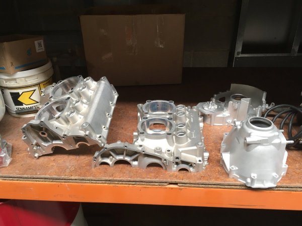

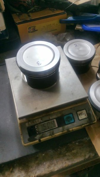

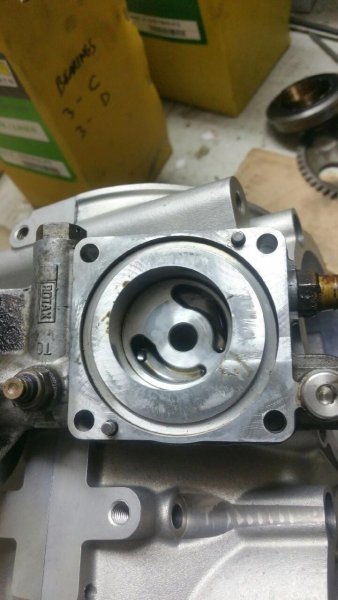

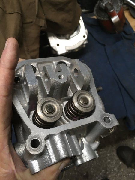

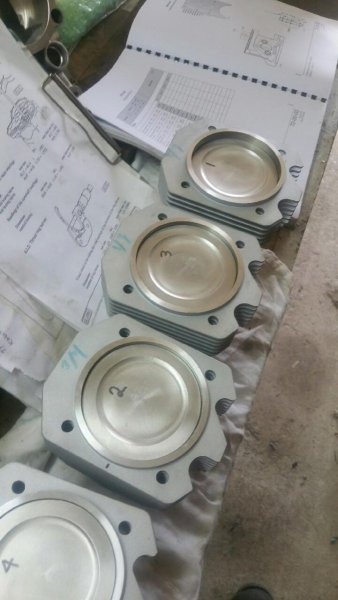

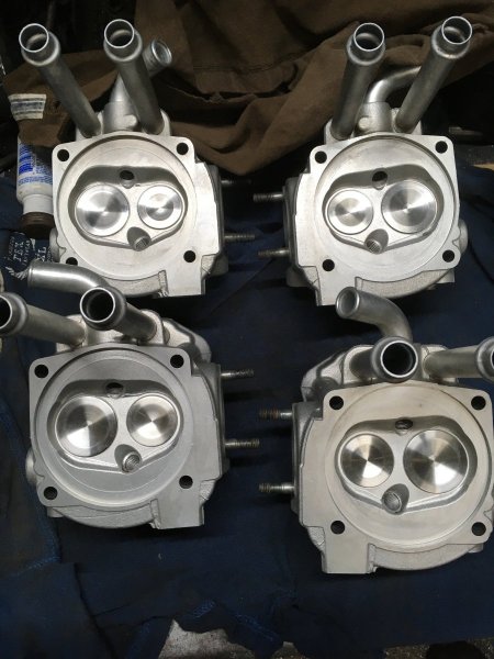

Area-51 Posted August 24, 2023 Author Posted August 24, 2023 2 hours ago, Kyle Communications said: I am not sure. I trust Jim's experience and vast knowledge on what to put in engines and how to rebuild them. He does all the machining himself and also the cam grinding. The cam lobes must have a slight curve at 90 deg to the cam lobe. This is what makes the lifters rotate that little curve and it cant be too much or too little either it has to be just riht he tells me. All I know is they are lifters for Ford engines. He also has a engine balancer and a heap of gear there. He is always flat out doing engines for the racing guys that when you give him a job to do for a relative you have to be patient as he does it as he gets the time. Some pics of the rebuild from when I got the engine. It was a 2000 hr 2015 engine that had been well maintained out of a Tecnam at a local flying school. You can see the cam being reground Lucky you! Should run really nice. They are a really simply and sweet engine. 1
