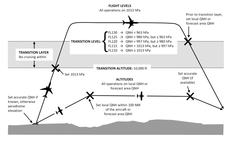

old man emu Posted June 26, 2023 Posted June 26, 2023 If the Transition level was FL115, the area QNH could be as low as 997 hPa, in Australia the weather on the ground would be pretty nasty. Think of the August winds. The transition altitude (TA) is the altitude above sea level at which aircraft change from the use of local barometer derived altitudes to the use of settings based on 1013.5 hPa. When operating at or below the TA, aircraft altimeters are usually set to (QNH) Above the TA, the aircraft altimeter pressure setting is normally adjusted to the standard pressure setting of 1013.25 hectopascals. The transition layer is the airspace between the transition altitude and the transition level. According to these definitions the transition layer is 0–500 feet thick. Looking at things from above the transition altitude, an aircraft flying at the 'transition level', in this example FL115, would not have adequate separation from traffic flying on QNH at the transition altitude. Instead, the lowest usable "'flight level'" is the transition level plus 500 ft. Consider the TA to be a line in the sky. Below it, QHN prevails. Above it 1013.25 prevails. The connection between "transition altitude" (TA), "transition layer" (TLYR), and "transition level" (TL) is TL = TA + TLYR

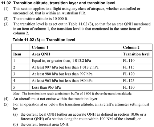

KRviator Posted June 26, 2023 Posted June 26, 2023 You can cruise at the Transition Altitude, or the Transition Level, but not within the Transition Layer. AIP ENR 1.7.2.1.4 As you've already noted, the layer thickness may vary depending on actual QNH, which will affect whether you can cruise at FL110-FL130, but like, for example, where Class C overlays Class G at 8,500, you can cruise at 8,500 and you're still in G.

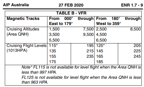

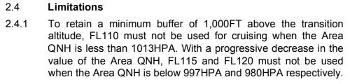

RFguy Posted June 26, 2023 Author Posted June 26, 2023 (edited) seems there has been continuous change of this chapter in the AIPs in 2017 there was a section descibed as "Limitation" .. - and it implied NO to my question - IE that you cannot cruise at FL110 if the upper boundary was FL110 for the day. BUT !!! but not in the 2022/- This has been replaced with TABLE 5 - B Table 5 indicates that FL115 is available unless QNH < 997 So this is different - ish Edited June 26, 2023 by RFguy 1

RFguy Posted June 26, 2023 Author Posted June 26, 2023 (edited) Change is OK. The section of the AIP on this (1.7) from 2017 was a bit of a dogs breakfast. the usual translation from legislation to plain language. The CASA legislation is full of "statement followed by a plethorea of exceptions to that statement " ! that's sort of how the previous AIP section was written. This is better . multiple passes of it and I can be fairly competent of interpreting it as the upper boundary layer (spelt out by the Area QNH) is NOT part of the transition buffer layer. IE if the buffer is FL100 to FL115, (Area QNH >=997 and < 1013 then you can cruise at FL115. Edited June 26, 2023 by RFguy
KRviator Posted June 26, 2023 Posted June 26, 2023 52 minutes ago, RFguy said: seems there has been continuous change of this chapter in the AIPs in 2017 there was a section descibed as "Limitation" .. - and it implied NO to my question - IE that you cannot cruise at FL110 if the upper boundary was FL110 for the day. BUT !!! but not in the 2022/- This has been replaced with TABLE 5 - B Table 5 indicates that FL115 is available unless QNH < 997 So this is different - ish Could be because they're replaced that chapter with a pretty new graphic in the latest AIP? 1
Kieran17 Posted June 30, 2023 Posted June 30, 2023 (edited) The unavailability of FL110 for cruise when the Area QNH is less than 1013 is due to the Transition Layer becoming squished in with the low QNH. If the Area QNH is less than 1013hPa, the vertical distance between A100 and FL110 is less than 1000ft (squished). If the Area QNH is 1013hPa (1013.25), the vertical distance between A100 and FL110 is 1000ft. If the Area QNH is Greater than 1013hPa, the vertical distance between A100 and FL110 is greater than 1000ft (fattened). Due to the squishing of the Transition Layer when the QNH is low (Transition Altitude and Transition Level less than 1000ft apart), cruising at FL110 is not available with an Area QNH less than 1013hPa. This squishing continues to happen as the Area QNH lowers, at less than 997hPa, there will be less than 1000ft between A100 and FL115. Example QNH table below: For QNH 1013 the Transition Layer is 1000ft thick. The higher the QNH goes, the thicker the Transition Layer becomes: at QNH 1017, the Transition Layer is 1120ft thick. As the QNH lowers, the Transition Layer becomes compressed, so a 'correction*' is applied. At QNH 1012, there is only 970ft between A100 and FL110, therefore, cruising at FL110 is no longer available and a 500ft 'correction buffer*' is added to the Transition Layer to ensure there is at least 1000ft between A100 and the next available Flight Level (FL115). The compression continues as the QNH lowers, and at QNH 996, there is 990ft between A100 and FL115, so the next 'correction*' value kicks in, FL115 is no longer available and the next available Flight Level is FL120. So, on a low QNH day, if the Area QNH is less than 997, cruising at FL115 is not available because there is less than 1000ft between A100 and FL115. If there were no corrections* applied to the Transition Layer, by the time the QNH reaches 979hPa, altitude A100 would be 20ft above flight level FL110. (*not an actual term, but I couldn't think of a better one) QNH Compression Correction Transition Altitude Layer Thickness Transition Level 1017 1120 0 A100 1120 FL110 1016 1090 0 A100 1090 FL110 1015 1060 0 A100 1060 FL110 1014 1030 0 A100 1030 FL110 1013 1000 0 A100 1000 FL110 1012 970 +500ft A100 1470 FL115 1011 940 +500ft A100 1440 FL115 1010 910 +500ft A100 1410 FL115 1009 880 +500ft A100 1380 FL115 1008 850 +500ft A100 1350 FL115 1007 820 +500ft A100 1320 FL115 1006 790 +500ft A100 1290 FL115 1005 760 +500ft A100 1260 FL115 1004 730 +500ft A100 1230 FL115 1003 700 +500ft A100 1200 FL115 1002 670 +500ft A100 1170 FL115 1001 640 +500ft A100 1140 FL115 1000 610 +500ft A100 1110 FL115 999 580 +500ft A100 1080 FL115 998 550 +500ft A100 1050 FL115 997 520 +500ft A100 1020 FL115 996 490 +1000ft A100 1490 FL120 995 460 +1000ft A100 1460 FL120 994 430 +1000ft A100 1430 FL120 993 400 +1000ft A100 1400 FL120 992 370 +1000ft A100 1370 FL120 991 340 +1000ft A100 1340 FL120 990 310 +1000ft A100 1310 FL120 989 280 +1000ft A100 1280 FL120 988 250 +1000ft A100 1250 FL120 987 220 +1000ft A100 1220 FL120 986 190 +1000ft A100 1190 FL120 985 160 +1000ft A100 1160 FL120 984 130 +1000ft A100 1130 FL120 983 100 +1000ft A100 1100 FL120 982 70 +1000ft A100 1070 FL120 981 40 +1000ft A100 1040 FL120 980 10 +1000ft A100 1010 FL120 Edited June 30, 2023 by Kieran17 Added Transition Level and Altitude to table 1
