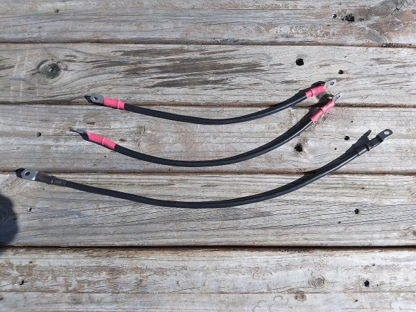

KRviator Posted April 20, 2023 Posted April 20, 2023 To answer the OP's question - I used 0 Gauge cable from Jaycar and crimped terminals on the RV for both starter current and engine ground and used a double layer of heat shrink over the ends, one about 6" long, the other 3" on top. Suitably supported with Adel clamps, I've not had any issues in 5 years and nearly 200 hours. 3

danny_galaga Posted May 10, 2023 Author Posted May 10, 2023 (edited) Oh my god, such an epic struggle to get a few cables made. My auto electrician would have been fine, but the size cable I want to use they don't carry. They would have to order ten metres minimum. How about the motorcycle shop down the road? Good point. There s a row of them. First one I asked, he really wasn't listening. What bike is it for? I tried again to tell him I need cables made. But what bike is it for? Geez, ok it's for a BMW f650. Sorry we only do British bikes. DAFUQ? I said 'what I'm asking is can you make up some cables for me'. No sorry. Second shop had some stuff kick around but he didn't know what any of it meant. He had no idea what I was saying. He didn't know what the sizing meant. I said imagine it's for a Harley Davidson. I don't know what that means... I got him to show me the cable he had. Looked a bit small. Passed a boat shop and thought that should be right up their alley.they were nearly as vague as the second bike shop. I didn't tell any off these guys it's for an ultralight as I get mixed results. I might as well have been asking for a window winder for a space shuttle. In Swahili. In all cases they are greeting the customer ready to say no, instead of being ready to help. This is why I buyso much stuff online nowadays, I can't be arsed explaining myself to disinterested people. Of all ages in today's case I might add. It's not just a youth thing. So I'm about to order some 3 b & s cable online and then I'll take it to my sparky . Edited May 10, 2023 by danny_galaga 2 1 1
