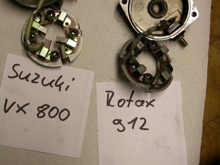

That's a two brush starter. What did you do for the third brush? Or were they ok? Can narrow down those kits to a f650 or vx800 starter. If you need to change the brushes for instance, there can be different compounds. That can make a huge difference. For instance, the only difference between a 12v 40mt truck starter and a 24v 40mt truck starter was the brushes, and you didn't undercut the commutator bars.
I'm sure the starter only has 2 brushes.
Possibly my last engine was an old one.
Try matching something from ebay.
The starters appear to be Yamaha.
The Yamaha unit was identical.

Apologies. I could have sworn I saw 3 somewhere!
3 brush is in earlier type generators. The 3rd one is smaller and only "decides" how much current to the field coils and that  controls the output. Maybe big truck starters have extra brushes but I "think" they would be an even number with more than 2 poles. and field coils.   The windings are often strips rather than normal wire.  Nev
Most car and truck starters have 4 brushes. Some of the smaller Nippon Denso car starters had 3. Maybe I was mixing up that memory with something I'd seen recently! I never knew why 3 when I was an apprentice but I'm thinking it would be a way of increasing resistance for a lower current draw on existing 4 brush designs. Why not two then? Haven't the foggiest 😄
Oh actually, I think maybe two on one side and one on the other because one of the poles (I want to say +) might run hotter...

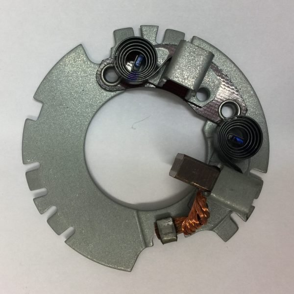

Cheez they couldn't look much crappier. See the copper in the brushes.? Have a look at older DELCO starters. for quality. RR at one stage used DELCO electrics.

Yeah that pic seems to be an aftermarket part from Turkey. Delco were ok. My own personal opinion was that Bosch were the gold standard in quality. Nippon Denso weren't bad (and as we are noticing on this little journey, quite ubiquitous on small engines).
At the bottom of the heap in terms of design and or quality were Lucas, prestolite, magnetti Martelli and Hitachi
There were niches of course. CAV made really good quality truck starters, albeit complicated. Bosch next in truck starters, then Delco. Delco weren't bad mind you. Just a bit simpler. Easy to overhaul though.
