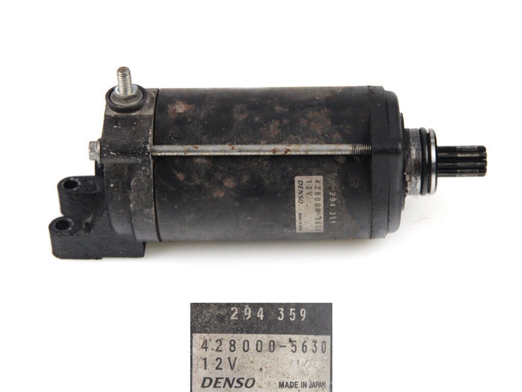

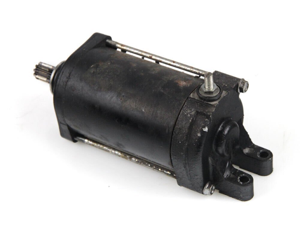

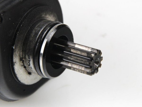

So going with my hunch, I started looking at pics of Denso motorcycle starters. Those superfluous lugs are a clue they normally bolt to a crankcase) I hit on the BMW F650 starter. It will need further investigation, my friend has a BMW F650. I can have a squizz, but not sure if I will have enough access.  It certainly makes sense, since the F650 is also a Rotax engine. Single cylinder, so it would need ROUGHLY the same amount of force to spin as the 912. As well, someone else here pointed out that the F650 radiator cap is the same. What this is adding up to is that Rotax, naturally enough utilise what they are already getting for other engines they make. Of course the F650 has been around a while, so there may be a few iterations of the engine, which could include the starter. So even if it is the F650, we need to determine what years it used the same starter (if of course it is the same)
The below link is for an AFTERMARKET F650 starter. Before anyone jumps the gun, I'm showing this link because it has quite a few pics from different angles. It is my preference to buy the same genuine part that Rotax buys, but paying the automotive price. I probably wouldn't get a cheap aftermarket starter.
https://www.stein-dinse.biz/product_info.php?language=en&products_id=524427#prettyPhoto
Too see exactly the same starter, it's useful to look for genuine second hand ones on ebay:
https://www.ebay.com.au/sch/i.html?_from=R40&_nkw=bmw+f650+starter&_sacat=0&LH_PrefLoc=2&Brand=BMW&rt=nc&Brand%20Type=Genuine%20OEM&_dcat=177959
Particularly this listing
https://www.ebay.com.au/itm/394431030976?hash=item5bd5ebe6c0:g:jbIAAOSwnQFjzr7C&amdata=enc%3AAQAHAAAA4BBbngib0YSE%2B6CMmjsCmTpUvXc9UZlt%2FfgQCtHur%2FN9tqAkwgwYcHrHWpcLICJlLUbPp3XbvdKtGA8KIW8R6raYzZcfQYI0gQP49M%2BQY7usc%2BqH%2BZgmY0sZwBeQTl%2BNZc0ab28Ev9pQvqeWGiUBDs7neO3lXe04bVr5ghxLIJleIFF8myKupAhmW1pZ09HT0OJTyX8IxFAibhoV%2BbPQavFTrJVmbVjI%2FPEtKbpSloRToz3CqwbwFicn6kkY7jWDj8A7psox9wg3rixECg3cM6Dl8EyZMoU3uWE%2BNtcoEv0E|tkp%3ABk9SR9K2rIXtYQ
Of note, they clearly show the Denso part number ( 428000-5630 . Also 294 359 ) which is useful, should this turn out to be the correct starter. Again, gun jumpers, please I'm not intending to fit a second hand one unless I knew where it had been (only from a known 912 engine, not from a motorbike thats probably been submerged in rivers a number of times in its life 😄 ) If I'm reading the listing correctly, it's for models from 2006-2012. Italian listing, so not sure how well they translated it. They could mean only 2006 and only 2012, but that seems unlikely.
Note that the Aircraft Spruce link also has some handy drawings with dimensions.
Note that I'm attaching the pics from that ebay listing for posterity since ebay listings disappear after a while.

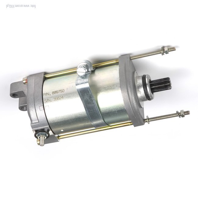

The last pic (the clean, silvery one!) is of the genuine starter, for comparison from Ecclestones site. I am specifically only looking at the late model starter, as I believe the Black starter wasn't as powerful and should be upgraded anyway.
NOTE NOTE NOTE NOTE!!!!
I'm NOT saying this is definitely the same starter, but it's looking plausible. Something as simple as the wrong number of teeth on the armature could blow this out of the water (This starter has 9 teeth).
Does anyone know anything else?

I think it's impossible to know what (little) differences exist, while things may appear to be the same. How's it going to affect your Certified aircraft or LSA status?   Nev
I should say, this is obviously for us Experimental, or 19 rego guys. I've had luck with the solenoid so far. Kyle seems to have found what fuel pump Rotax source.
There's only so many things to measure on the starter, if I can get my hands on one. I might try and find a U/S one from the wreckers cheap to measure up. It's unlikely they are modifying the starters to suit their engine, but I concede it's a possibility. Most likely thing would be to machine the face plate for some reason. Still unlikely because they would have to pull apart the starter to machine it, and all that extra labour to potentially make it slightly weaker than it was before. Better to design the starter mount around an existing design. Same with the fuel pump- why reinvent the wheel? And I'm guessing it will be the same for the stator, and maybe rotor.

They may look the same... you need to strip both units down and measure armature resistance across the windings and compare sizing of copper wire used, and then compare the size of the carbon brushes. The cases may be identical but a heavier rated unit will use heavier gauge copper and deeper brushes.
Or just request load operating specs of each unit from Denso if available.
Some manufacturers use shallower or softer brushes; so the life of the starter can be reduced some 50% at times; or the brushes just burn out from excessive cycle times.
9 out of 10 starter failure is related to armature brushes only.
If a solenoid is used then its generally the copper plate in the solenoid burnt out; poor copper quality is the cause here; not the same as 50 years ago...
Replace both solenoid and starter as a unit; not worth saving the $ as the non replaced unit will fail when you are most needing it.

The German site is informative, but I'm thinking I've nailed it with the F650. When you have similar machines or within a range people making starter motors don't make different specs for every single machine out there. Classic example is the Bosch car starter, from about 1960 to 1990. The same starter was used on Holden's and Ford's, Ramblers and Triumphs. Only the front housing was different. The carcass was the same.
I'm confident that Suzuki starter, f650 and Rotax 912 have the same carcass. And I strongly suspect the Rotax 912 IS the f650.
