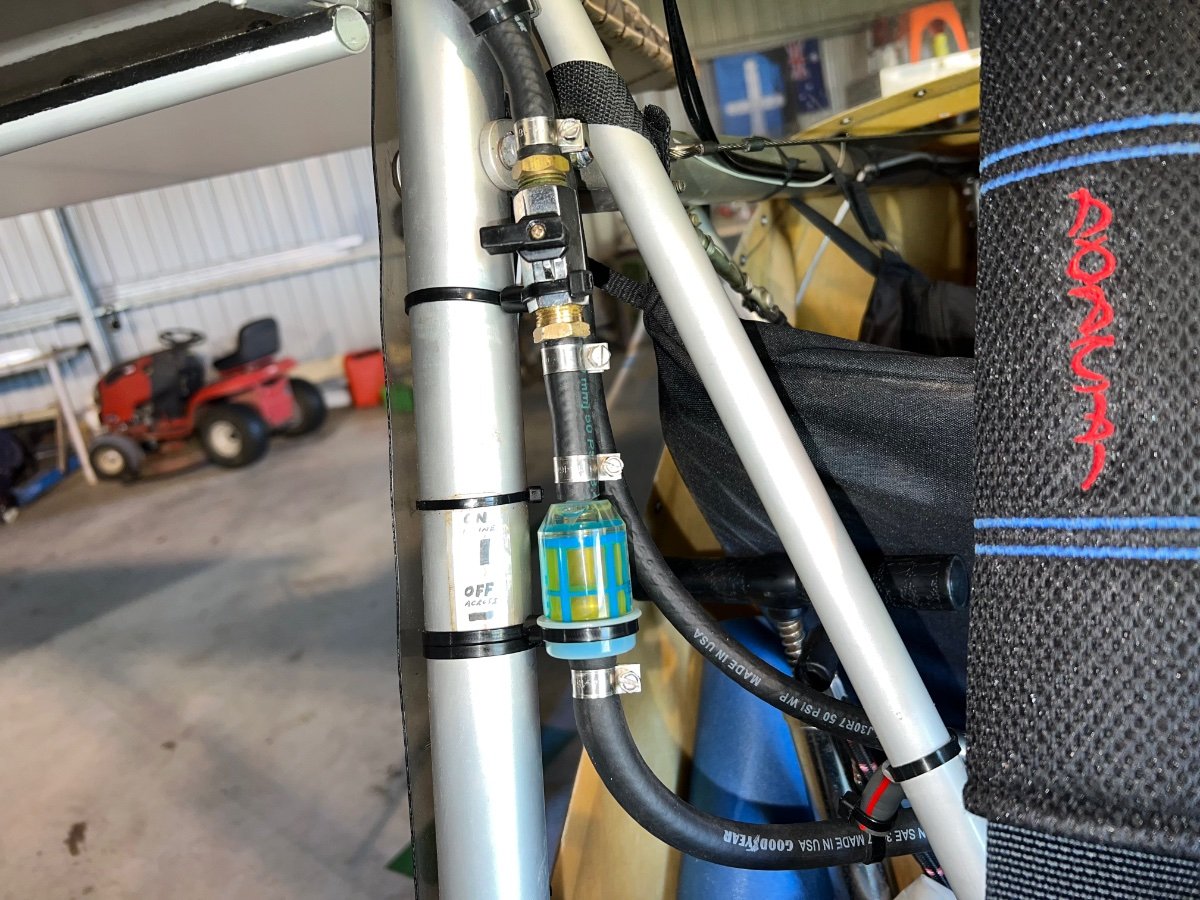

Marty_d Posted July 24, 2023 Posted July 24, 2023 Has anyone had luck sourcing fuel on/off valves? Inline that is, just for a safety "off" in the cabin in case of fire etc. Admin - For Aircraft :: Fuel Equipment :: Fuel Line Tap WWW.CLEARPROP.COM.AU Fuel Line TapFeatures Made of high quality material durable for long term use 6mm inline fuel tank tap 90 degree rotation ON/OFF switch Specifications Material metal Inline tap size 6mm Total length Approx...

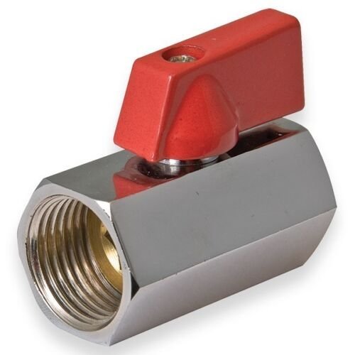

Blueadventures Posted July 24, 2023 Posted July 24, 2023 (edited) 3 hours ago, Marty_d said: Has anyone had luck sourcing fuel on/off valves? Inline that is, just for a safety "off" in the cabin in case of fire etc. I use these 3/8" BSP female ends. Placed between tank and fuel filter. No issues. Edited July 24, 2023 by Blueadventures 2
skippydiesel Posted July 24, 2023 Posted July 24, 2023 On 05/07/2023 at 5:00 PM, Marty_d said: I spent a while in Repco the other day looking for suitable 25mm ID hose for the radiator runs. Couldn't find anything and everything was hellishly expensive anyway given I'd need to buy several to get the right bends in it. Just in terms of the Gemini radiator hose Skippy - was searching online for that but it always seems to be 30 - 34mm, not 25 as we need for the Rotax connections? What other options are there - looking at this (Aeroflow silicone heater hose) - handles up to 180 and it looks like it's got some spiral reinforcement. Can't find any data on bend radii though. Would something like that be suitable for the 25mm sections? Just a follow up: Checked out the Gates radiator hose catalogue - If you stick with relatively small capacity engined cars, you are more likely to come up with 25mm ID hoses. The catalogue will have a picture, PN, ID and length, vehicle & position. Some examples: Gates PN: ID: Length: Car : Position 02-0058 25 255 Barina Lower 02-1029 25 710 Accord Lower 02- 1032 25 500 Accord Upper 02- 0961 25 325 CRX Upper 02-0963 25 510 CRX Lower 2
Marty_d Posted July 24, 2023 Posted July 24, 2023 1 hour ago, Blueadventures said: I use these 3/8" BSP female ends. Placed between tank and fuel filter. No issues. That looks like the go. Many are 6 or 8mm but the line at that point is 3/8 (9.5) - that one would allow those barbs.
