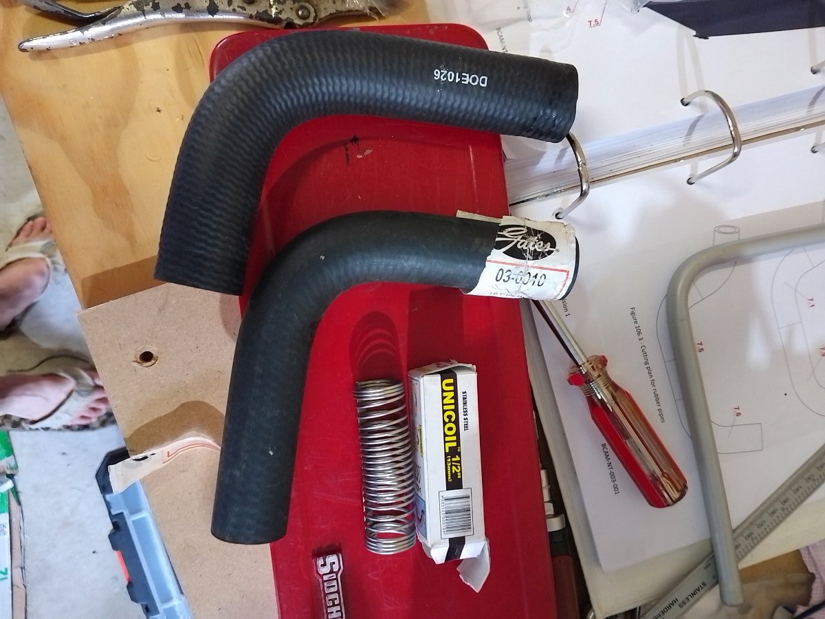

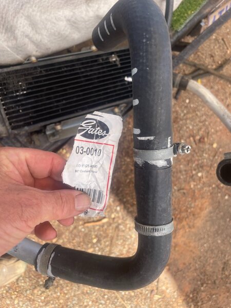

danny_galaga Posted March 14, 2023 Author Posted March 14, 2023 (edited) On 12/03/2023 at 2:09 PM, Blueadventures said: Go into auto shop and compare with what they have and not part number of similar hose. So even though I had the part number for the actual radiator hose the kit factory uses, I wasn't very happy. The hose is about 27mm ID and the expansion bottle and Ali pipes in the kit are 25mm ID. People are living with it, but I think it's not great form to be trying to seal that difference by tightening hard or putting the clamp on the barb. So I took a leaf out of Blues book and compared other hoses in 25mm. Did it online but I identified two Gates universal hoses that allows me to at least get the back of the motor done before I install it in the plane. I also bought a SS spring to put in inside one that bends slightly past 90 degrees. Had to modify the spring because they sold me the wrong type, which was to go on the outside of hoses. A little win, and those Gates numbers will go in my list ☺️ Edited March 14, 2023 by danny_galaga 2
Blueadventures Posted March 14, 2023 Posted March 14, 2023 (edited) Good move. I.D. and O.D. Should match. I would not except 27mm i.d. onto 25mm o.d. Edited March 14, 2023 by Blueadventures 2

skippydiesel Posted March 14, 2023 Posted March 14, 2023 (edited) Hi Danny_ Galaga - preformed hoses , as per your photo, should not need any additional reinforcing, to prevent collapse. I would suggest you are adding unnecessary weight & cost. Edited March 14, 2023 by skippydiesel

danny_galaga Posted March 14, 2023 Author Posted March 14, 2023 (edited) 30 minutes ago, skippydiesel said: Hi Danny_ Galaga - preformed hoses , as per your photo, should not need any additional reinforcing, to prevent collapse. I would suggest you are adding unnecessary weight & cost. The radiator hose is 90 degrees, but the angle it is bent to is maybe 80 degrees. when you do that, it pinches a bit. May not make any difference, but i feel better if that spring is in there. The hose itself is a tad lighter so I would say the extra 30 grams of the spring or whatever it is is balanced out by the lighter hoses 🙂 Edited March 14, 2023 by danny_galaga 1 1
