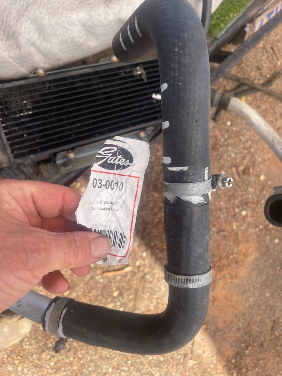

On 05/08/2025 at 6:28 PM, Moneybox said:
Yes Skippy, I'm pretty sure I bought a couple of 90° hoses but I can't find the invoice.
I bought four of these 25mm hoses as well. If Sandra finds the invoice I'll post the list but anything not marked for the plane has just gone into a file of assorted invoices never to be seen again.
Obviously it varies between different setups, but for inspiration this is my list of hoses for my Bushcat
03-0010 as per moneybox
01-0007
02-0951 x 2 (datsun 120y)
all of these were cut to suit
01-0007
All of the above are Gates coolant  25mm ID.

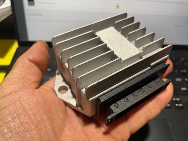

Regulator/rectifier:
CARR5115 from vectriqparts.com.au

Radiator hose, section 106:
Note: gates 03-0010 and 01-0007 are 25mm ID and will replace the rear two bends and the right hand side short straight piece near the starter. 25mm is a much better fit.
2 X 02-0951 (Datsun 120y lower radiator). Leftover 70 something degree bend from above 01-0007 goes on right hand radiator tank outlet.
