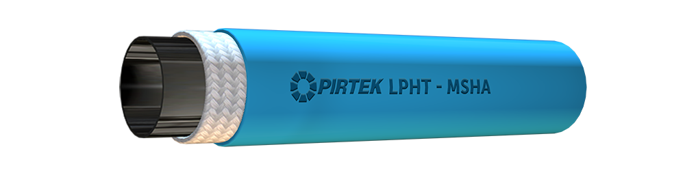

On 08/03/2025 at 9:36 PM, Blueadventures said:
I have seen this hose used for Rotax 912 oil lines.  Owners said no issues and replaced with same again.   An experienced Rotax and aircraft service person used it.lpht.thumb.png.11e64db472684089692b516fcc1f225a.png
As advised earlier:
Repco Australia only stock those Gates products deemed to have automotive applications - they do not stock 8GHT hydraulic oil hose.
8GHT hydraulic oil hose, can be had from a hydraulic service company called Hydrolink (there may be others)
8GHT is not supplied by Repco. You will find it in a hydraulics service/parts supply😈

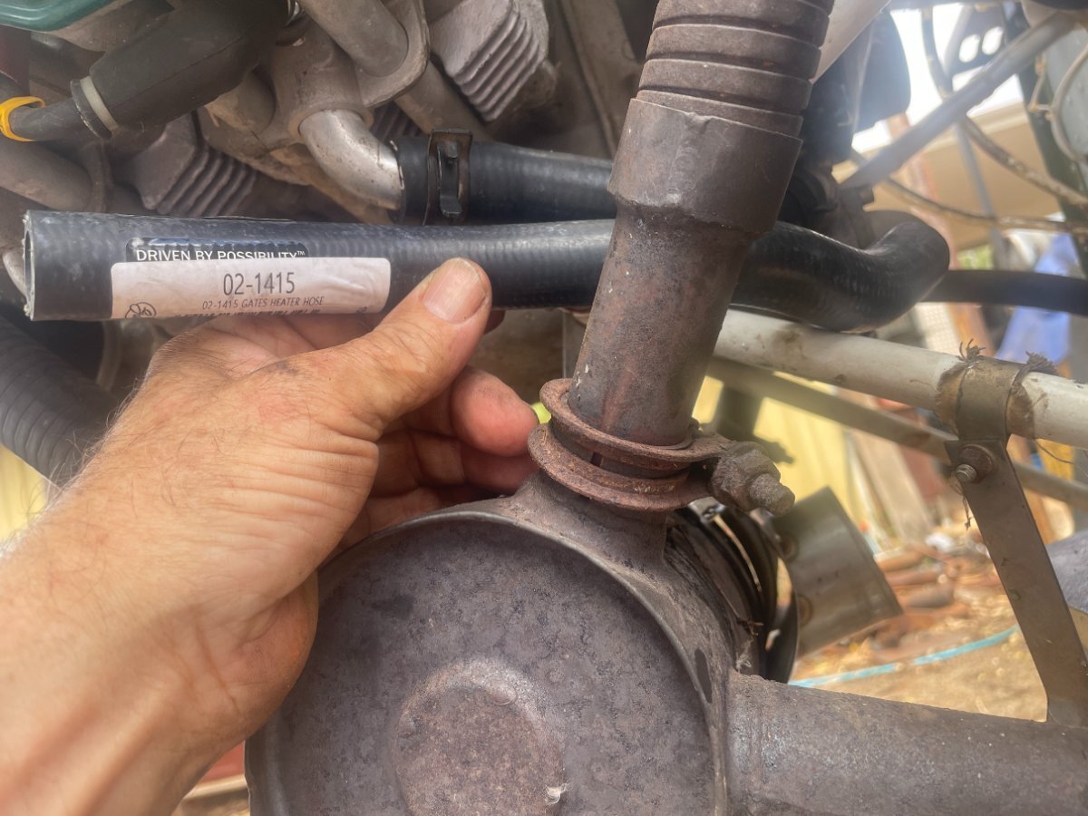

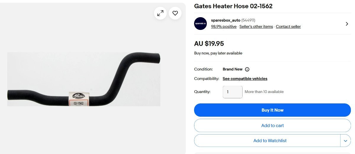

I took Skippy's advice and went for Gates hose but I just searched automotive catalogues for the best shape.
I bought a few different ones because none of mine are straight. Every hose just had to have something cut off for a perfect fit.
Hi Moneybox,
I hope the coolant hose you have selected has a 17mm or smaller ID??
If not you are relying on the hose clamp to both make a seal and for security - not good!
Ideally the hose should be a tight fit, on the 17mm OD  spigot, thus making a good seal against leaking. The clamp, done up firm (not over tight) is just for security.

Easy to Google both these Gates hoses to see they are 17mm ID.

Did you purchase other 17mmID Gates coolant hoses or just the 02-1562 & 02-1415?😈
Yes Skippy, I'm pretty sure I bought a couple of 90° hoses but I can't find the invoice.
I bought four of these 25mm hoses as well. If Sandra finds the invoice I'll post the list but anything not marked for the plane has just gone into a file of assorted invoices never to be seen again.
