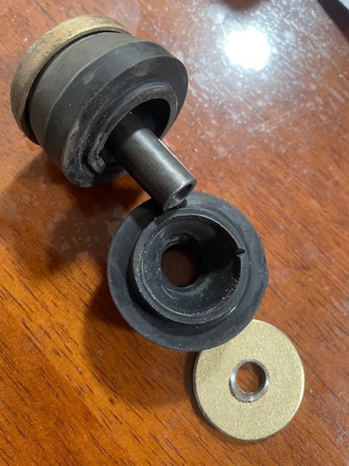

I just received a quote for the 8 engine mount rubbers from Bert Flood.
860695 Shock Mount Set ( $925.90 + GST ( In Stock )
Now I've worked out why they call them Shock Mounts 🤣
  • Haha 2
What a joke, talk about rort of the century! Just eight cup-shaped rubber pads and eight cupped, pressed washers. They're worth about $200 in total.
See a rubber mount manufacturer, they will more than likely be able to knock them up for you.
There's nothing special about the mountings, they're as simple as they come. Their correct technical name is centre fixing isolators, have a chat to Mackay Industrial (Derwent Industries).
The main thing that needs to be established is the Duro (Durometer measure) grade of the rubber. The Duro governs the rubber hardness/softness and it's important the correct Duro is used for the application. Too soft and the rubber will chew out, too hard and too much vibration is transferred to the frame/fuselage/chassis.

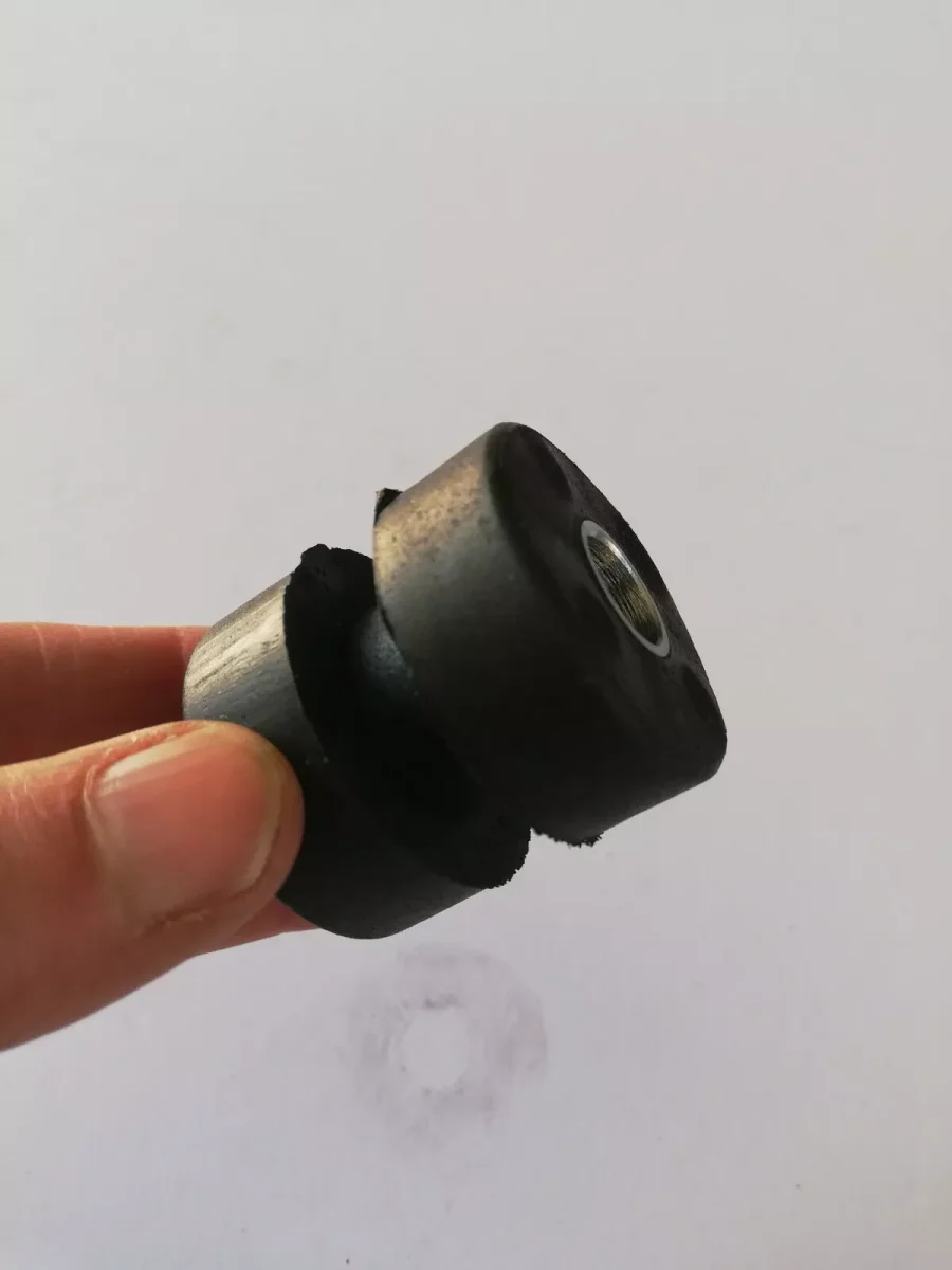

43 minutes ago, Thruster88 said:
Hi Moneybox. I need some of these for a Thruster, were did you find them?

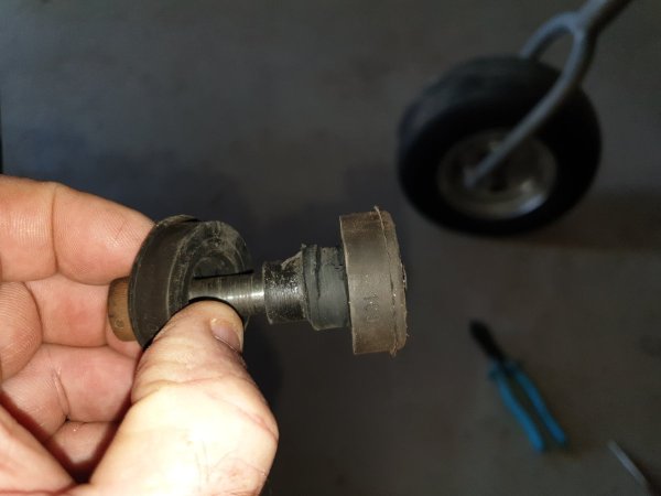

These are the Skyranger ones. 13 pound a set at Flylight Airsport UK.  (Image apart is the ones I replaced on a Skyranger last year.)
Some of this has already been covered earlier in the thread.

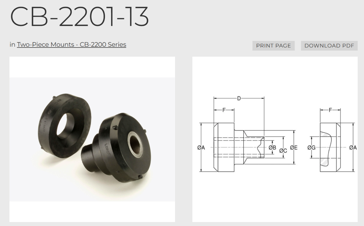

Lord Mounts  Part No. CB220113 from Flexible Drive are the same size and used over here; I am told by another Skyranger owner in Australia.  However I purchase from the manufacturer.

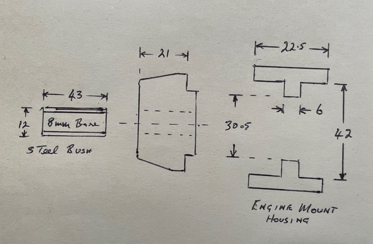

This might do the job to some extent although the E-size is only 20mm inserted into a 30mm hole in the housing?
Maybe phone flexible Drive and ask if they have same compond grade in your sizing.
I can't see me being happy with any of these mounts so far. The centre rubber is only 20mm when I need 30mm to support the frame. I could simply make up a bush to take up the slack but then I have a problem with the OD. It's only 33mm and with a hole in the frame at 30mm it's barely hanging on. That's unless I've read it wrong but that's never happened before 😇
