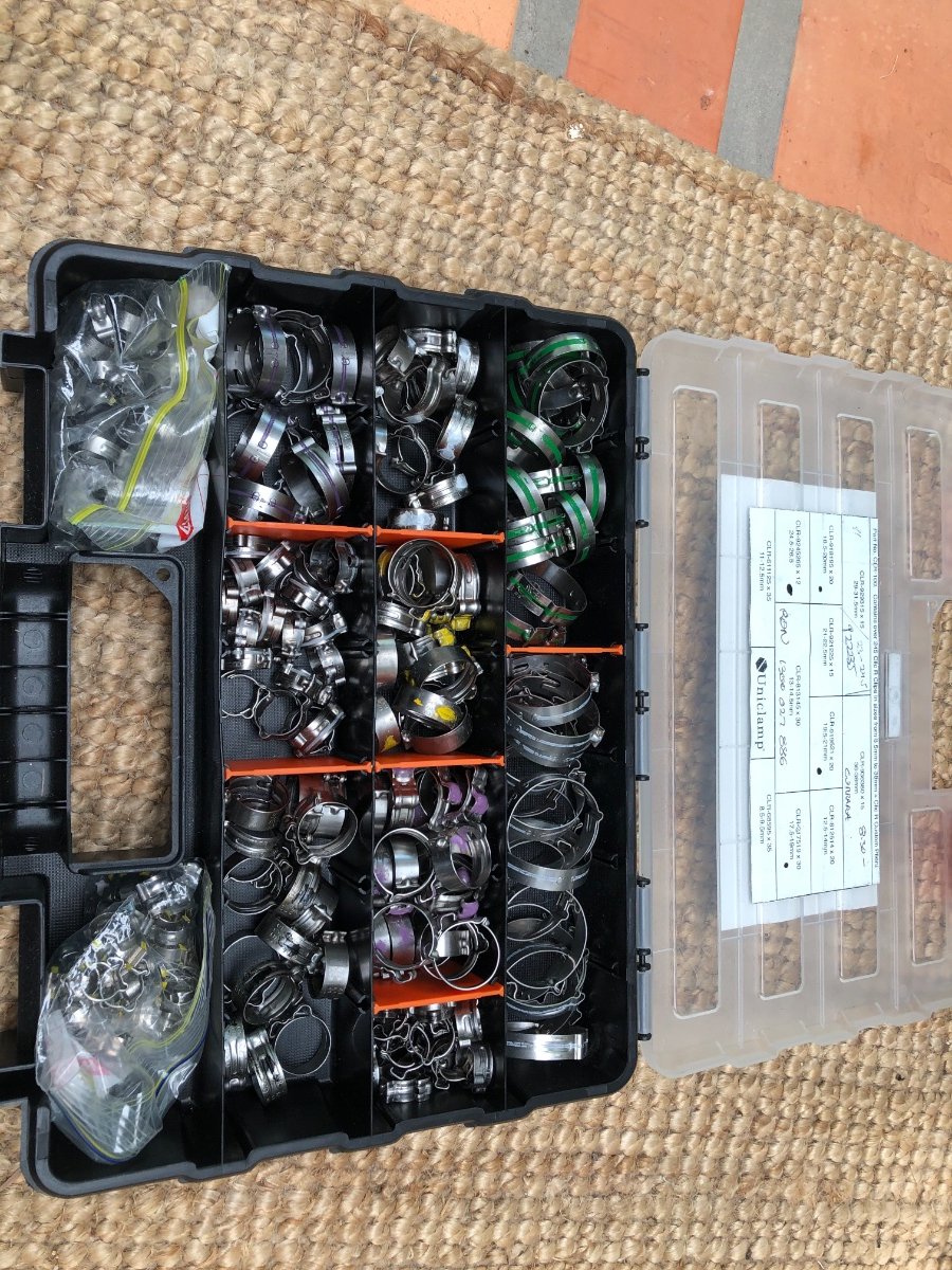

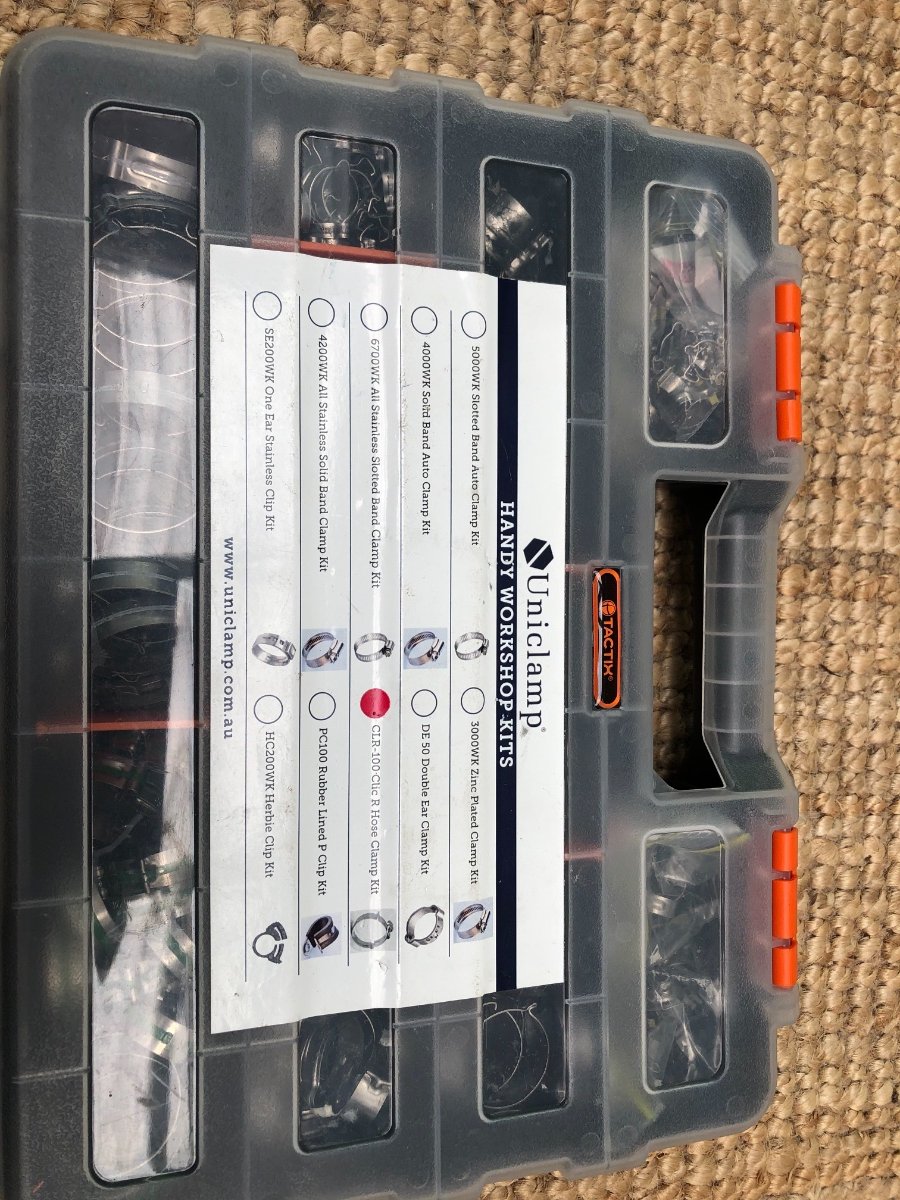

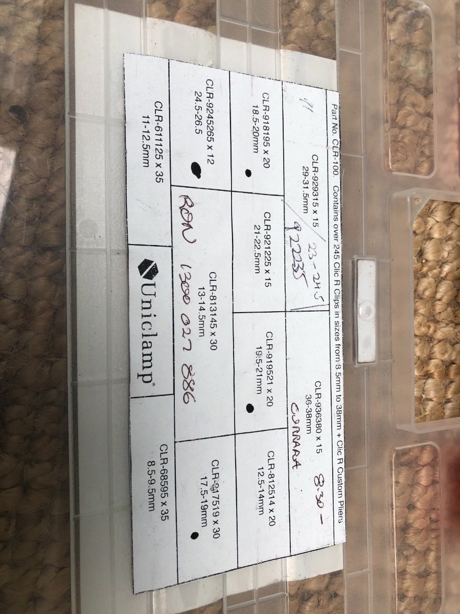

Area-51 Posted March 4, 2023 Posted March 4, 2023 DCI, Diver Consolidated Industries, in Victoria for all OE ISO standard thermal and acoustic protectives. Uniclamp Australia, Ron 1300 027 886 for NORMA style hose clamps. Buy complete kit with pliers and additional packs of sizes marked in pics if undertaking complete 5 year hose change. You will need CLR-922235 23.0mm-24.5mm size clamps as well. OIL Hoses - ENZED HYDRAULICS Parker 7212 Jiffy Push-On 13mm ID Parker 7212 Jiffy Push-On 16mm ID Parker Push-Lok Plus 836-12-BLK FUEL Hoses - REPCO Gates Barricade 4219BF Greenshield 4219-5653, 3/8" ID 4219-5652, 5/16" ID 1

Area-51 Posted March 4, 2023 Posted March 4, 2023 5 hours ago, skippydiesel said: Check out my input to this Form - Aircraft general Discussion -Constant Pressure Spring Clamp The person asking the question requires "Oetika" type clamps. CLR range of Uniclamps are reusable, simple to tighten and release without slicing your hands open on ears and tags, and maintain constant pressure; set and forget. All those style clamps you have directed readers to are superseded, insufficient, and great as a last resort or where the task is not critical such as washing machines, garden hoses, and Morris Minors. 1
skippydiesel Posted March 4, 2023 Posted March 4, 2023 57 minutes ago, Area-51 said: The person asking the question requires "Oetika" type clamps. CLR range of Uniclamps are reusable, simple to tighten and release without slicing your hands open on ears and tags, and maintain constant pressure; set and forget. All those style clamps you have directed readers to are superseded, insufficient, and great as a last resort or where the task is not critical such as washing machines, garden hoses, and Morris Minors. No offence intended or taken (despite your put down) Aera-51 but BillLipson just may be interested to know what cost effective options (to Oetiker) are available in Australia. Oetika are not so easy to find & there are quite a few viable alternatives. I have brand new Rotax 912ULS (just turned over 25 hrs today) - it didn't come with "Oetiker" style hose clamps - it came with Constant Tension Spring Clamps (CTSC), which are actually constant pressure, unlike Oetiker's. CTSC are pretty much universal, on recent automotive/machinery offerings. I have offered two web sites for CTSC here in Australia. Do your recommended oil hoses meet Rotax specifications ? Gates fuel & coolant hoses sizes can be expressed in metric (we live in Australia)
Area-51 Posted March 4, 2023 Posted March 4, 2023 Thanks, that's great, not offended by your response skippy; provided reasons why those clamps you recommended are obsolete based upon nearly 40 years working in the field and what the end results are, but in the right application they are fantastic; use them and enjoy... Personally I wouldn't use any replacement components on my own engines unless they match or exceed OEM manufacturer standards... couldn't care less if it was rotax or any other superduper producer, i'm quality and standards driven, not price driven. People need to accept responsibility to either invest in themselves and do the research first, or just go get their stuff from floods and be happy. Not everyone has the same level of experience and abilities; not afraid to say something is crap if it is proven to be crap. Conditions are great this morning, taking my hoses and clamps up into the sky!
