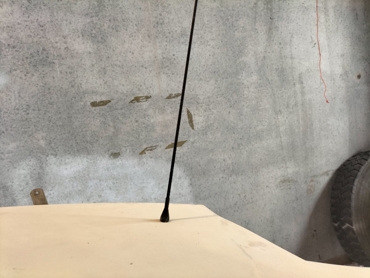

BrendAn Posted October 16, 2022 Posted October 16, 2022 My old Jabiru has a double VHF aerial. I don't know the correct name for it. It has the normal aerial on top of the fuselage and has the same underneath in the cabin. Is that a good setup or should I fit a new one.
RFguy Posted October 16, 2022 Posted October 16, 2022 Modern Jabirus usually have : the antenna in the tail is a centre fed dipole. the antenna in the midships is often a quarter wave whip with sometimes a limited ground plane wire pair. Your setup is I guess typical of early jabs. these antennas are just end fed , but most of them are designed to be mounted against a metallic aircraft skin. The setup will be fine if it is currently working, it is hard to improve on it if the cable and connectors and radio are good. 1
Rastus Posted October 16, 2022 Posted October 16, 2022 It is called a dipole antenna. They are used in places where there is no electrical groundplane. Picture a metal Tecnam with an antenna on top. The aeroplane becomes the groundplane for the antenna. A dipole is generally more efficient than a simple antenna. I would leave it alone. Over to you RFguy 😋 Robert See RFguy has just beat me. 🤪 1 1

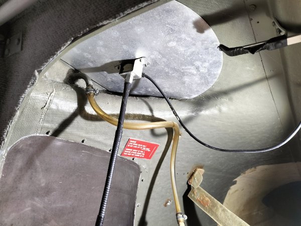

BrendAn Posted October 17, 2022 Author Posted October 17, 2022 Had a good look today . It all appears to be in good condition.
skippydiesel Posted October 17, 2022 Posted October 17, 2022 No offence, but to my untutored mind,the groundplane looks to be far too small 1 1
BrendAn Posted October 17, 2022 Author Posted October 17, 2022 38 minutes ago, skippydiesel said: No offence, but to my untutored mind,the groundplane looks to be far too small it was a certified trainer so i assume the radio must have worked ok. 1

RFguy Posted October 17, 2022 Posted October 17, 2022 1) antenna analyser - Talk to the local ham radio club, someone or 5 will have one you can borrow or use 2) yes, that ground plane is too small. although better than nothing. You need a minimum of two radials, preferably going in opposite directions (electrical balance) each 59cm long if they are thin wire, or 55cm if they are something like 1/2 or inch wide flat strip (which is better than thin wire) . These could be attached to the existing ground plate, such that the total length from the antenna base to the end of the strip or wire was one of the above numbers......

skippydiesel Posted October 17, 2022 Posted October 17, 2022 Working okay is a bit like saying "sh'ell be right". This is a long way from even good trans/reception let alone excellent. Most of us have experienced poor quality radio communications and hoped our own efforts would be a significant level better. I would ask does the pilot (A) of this aircraft clearly hear transmissions from the pilot (B )10+ Nm away and conversely does pilot B clearly hear the transmission from pilot A - if not then something needs to improve. A decent groundplane is usually so easy and cheap to make/install - you may be surprised at how your transceivers performance improves.. 3
aro Posted October 17, 2022 Posted October 17, 2022 5 hours ago, skippydiesel said: No offence, but to my untutored mind,the groundplane looks to be far too small I think it's a dipole so a ground plane is not required. That is what the black bit hanging down is. 2

skippydiesel Posted October 17, 2022 Posted October 17, 2022 9 hours ago, aro said: I think it's a dipole so a ground plane is not required. That is what the black bit hanging down is. Again from the uninitiated - I had a dipole set in my glass aircraft - it was okay but nothing compared with the conventional antenna with decent groundplane that I installed later (chalk & cheese). True the dipole may have been poorly executed (I don't know) and I did splash out & purchase a new radio at the same time but the difference was genuinely astonishing. 1 1
aro Posted October 17, 2022 Posted October 17, 2022 17 minutes ago, skippydiesel said: the dipole may have been poorly executed That's always possible. I'm no expert, but my understanding is that a dipole is the ideal configuration. With a large enough ground plane ("large enough" depends on the frequency) we can make something that acts like a dipole at radio frequencies, without the bulk of the second element. There are complications, e.g. the shape of the ground plane can affect the radiation pattern from the antenna. Again, my understanding is that the SWR check at aviation frequencies is the easiest way to check the performance of the antenna. I see some people are recommending something else - I would be interested in more information about why. 20 minutes ago, skippydiesel said: I did splash out & purchase a new radio at the same time That is at least as likely to have made the difference as the antenna. I don't think its as simple as making a bigger ground plane. You would probably need a new antenna designed to work with a ground plane, which I think has a different connector from your current antenna. That means you probably need to install a BNC connector or run a new antenna cable. I wouldn't do anything unless you know you have a problem. If you do have problems and the setup is the same as other Jabirus, I would look for problems in the current setup before replacing it. I don't think Jabirus have a problem in general with radio performance. 2 1

Yenn Posted October 18, 2022 Posted October 18, 2022 I made my ground plane from brass shim about 15 thou, just a square souldered up at the size that would fit inside the fuse. Very light weight and works well. The antenna is 1/8" SS cut to suit the middle of the airband for length. 3
skippydiesel Posted October 18, 2022 Posted October 18, 2022 2 hours ago, Yenn said: I made my ground plane from brass shim about 15 thou, just a square souldered up at the size that would fit inside the fuse. Very light weight and works well. The antenna is 1/8" SS cut to suit the middle of the airband for length. As I understand it any conductive material (mainly metals) will do. For ease of acquisition (local supply/low cost), low weight and corrosion resistance, I went with aluminium. The builders aluminium flashing is great stuff - can be molded to conform to almost any shape and trimmed with industrial scissors (could probably use any scissors but may not do the tool much good) or tin snips . For stability & durable attachment, does need a sandwich of aluminium plate (s) where your antenna base comes through. 1
