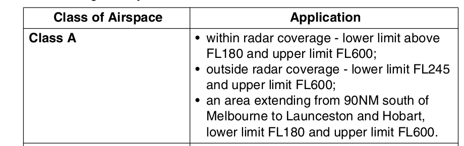

Ian Posted May 21, 2022 Posted May 21, 2022 Just a question about the current state of the airspace. This PDF has the following. Above FL245 outside radar coverage, Above FL180 within radar coverage Whereas Airservices provides the an airspace definition on here which states that class A is from 18000-60000 feet. I suppose the key question is which is correct and are the radar boundaries accurately defined?

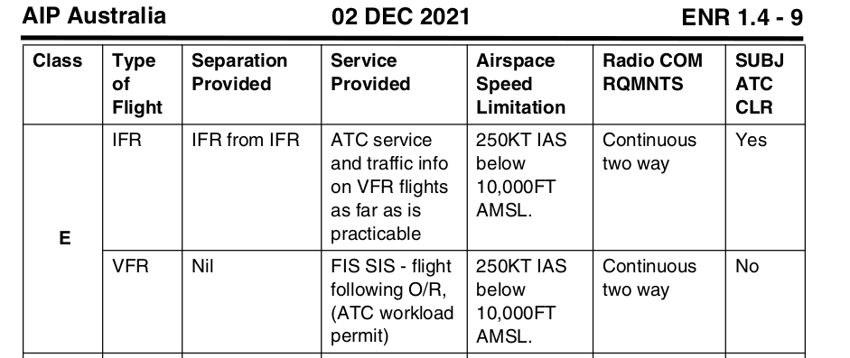

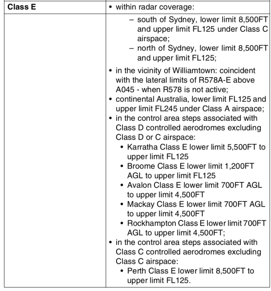

Ian Posted May 22, 2022 Author Posted May 22, 2022 Clear as mud without a map of radar coverage. 😉 However the AIP ENR 1.4 provides a more detailed version of the current CASA pdf extracts below. I couldn't find any reference in AIP ENR 1.4 relating to FL210 so is this a rule of thumb or a defined ceiling? So, aside from the practical limit, you could in theory, VRF to FL245 outside radar coverage zones. (If you had a definition of what the radar zones are, for example do they change during rain periods) If practicability is an issue you could of course do VFR on top at FL245 of invisibly wispy cloud. Of course you might want oxygen and a mask as canulas aren't rated at that altitude. Not saying that this is gospel however it would be nice to set a few bounds. As more zones decommissioned due to ATSB the non-radar areas may expand. One other thing that was of interest is that the boundary is regarded as existing in the less restrictive airspace.
