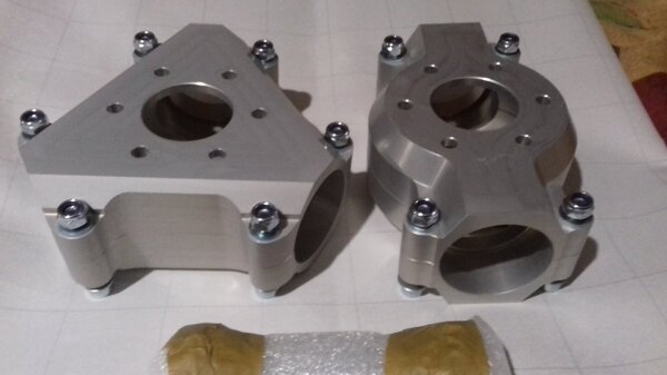

meglin Posted March 31, 2022 Posted March 31, 2022 The best choice is made by those customers who order a 3-blade propeller and at the same time a 2-blade hub. They get incredibly many opportunities for their own research. And they also get one spare blade in case of using a 2-blade propeller. 2 1 2
