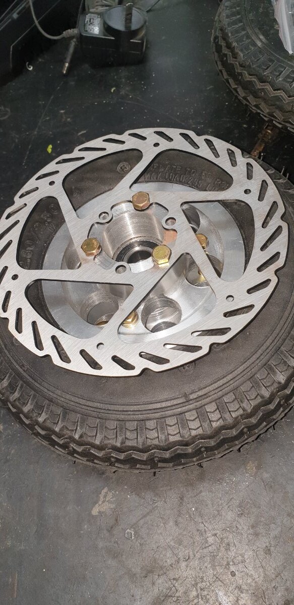

For some years I have been trying to make an aircraft for less than $10k.  First attempt was scrapped as it was far too heavy.  The idea was to make moulds and loan them out, really not feasible, too easy to damage the moulds.  I am on second attempt now.  Engines $4k, leaves $6k for fuselage etc.  Use phone efis, may work.  Hand held radio.  Probably on target but making many parts in my lathe and milling machine. I expect that I will achieve the end result.  The aircraft is small and I am using quad bike braking system. I machined wheels from single blocks of aluminium.  Canopy will blowv$10 if it is bought, I will have to make it, doubt that the result will be ok.

You might like to reconsider the quad bike discs.  You will find that a flat will have the disc on the ground and it’s likely to twist and jam.  I use Vespa hydraulics on the 912 trike and a plane stainless disc cut to be the diameter of the wheel less 5mm.  From experience a total flat does not cause disc strike and it pulls up 450kg of trike on grass in under 100m

I was going to point that out and glad you did instead. A lock up on one side unanticipated is likely to be spectacular.. Nev

The discs are 15mm larger than the rim.  With two side walls and tread roughly calculated at 15mm the discs may touch the ground but only just.  The calipers are very small and fully floating.  I did some tests some time ago and the discs were extremely difficult to twist. The craft AUW is 200kg.
Have you had a chance to try them out in a spike stop Geoff (with the AC mass)?
In making disc brakes for race cars I've found the braking is exponentially better to the diameter, so I usually have a bigger disk turned up until I can produce a lock up.
For this reason I'm reluctant to say anything about turning off some diameter, but another more common operational issue is bogging down in soft ground.
The intent is to only use the brakes for taxing and holding the aircraft during starting the engines.  No starter motors.  Virtually no electric system.  Batteries in hand held radio fitted with remote headset, signals for tachos and kill switches. EFIS in phone. Nothing in the aircraft that doesn't have to be there.
