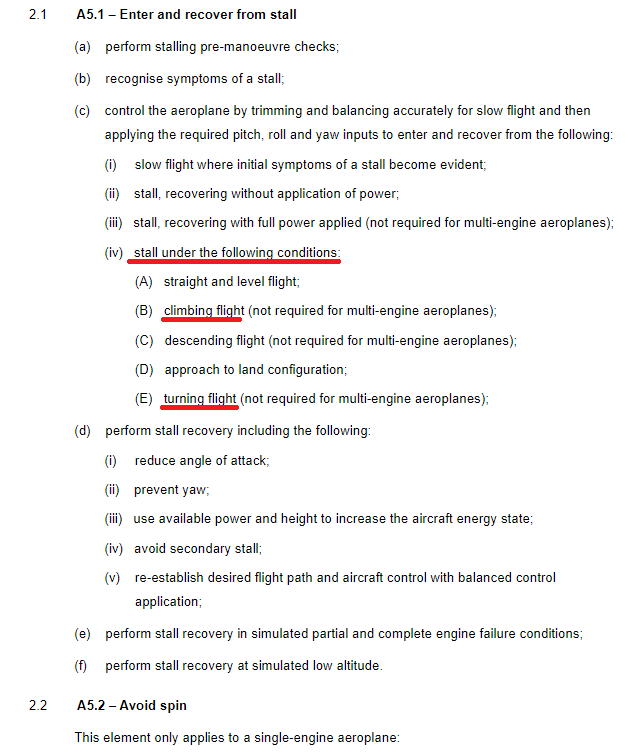

djpacro Posted May 2, 2022 Posted May 2, 2022 On 28/04/2022 at 9:25 AM, Old Koreelah said: It was encouraging to hear that skilled, seasoned pilot “chicken out” of actually demonstrating the powered stall he had planned. ..... I know of some instructors who chicken out of required flight exercises for an RPL per Part 61 (see attached image). I see that the RPC syllabus is far less comprehensive. I see some aeroplanes used in training that are prohibited from accelerated stalls so unable to do all of the required Part 61 stall exercises. 22 hours ago, APenNameAndThatA said: Benefits if spinning includes making it less likely that you will freeze if you get out of usual attitude. And it makes that zone between stalling and spinning less mysterious. The way people on here talk, you’d think there was no space between stall and spin. Another way of looking at this is that since people are still dying from stall and spin, whatever the training there probs should be more. The more/better the training, the safer you are. Seems like an argument for UPRT. See https://www.faa.gov/sites/faa.gov/files/regulations_policies/handbooks_manuals/aviation/airplane_handbook/06_afh_ch5.pdf There is no space between stall and spin. Suggest that you read the reference above - the pages on stalling are followed by pages on spinning. There is a stall recovery template and a spin recovery template, nothing in between. 1

APenNameAndThatA Posted May 2, 2022 Posted May 2, 2022 51 minutes ago, djpacro said: I know of some instructors who chicken out of required flight exercises for an RPL per Part 61 (see attached image). I see that the RPC syllabus is far less comprehensive. I see some aeroplanes used in training that are prohibited from accelerated stalls so unable to do all of the required Part 61 stall exercises. Seems like an argument for UPRT. See https://www.faa.gov/sites/faa.gov/files/regulations_policies/handbooks_manuals/aviation/airplane_handbook/06_afh_ch5.pdf There is no space between stall and spin. Suggest that you read the reference above - the pages on stalling are followed by pages on spinning. There is a stall recovery template and a spin recovery template, nothing in between. Excellent. Now can you tell me *exactly* where it is that a stall ends and a spin starts?

facthunter Posted May 2, 2022 Posted May 2, 2022 The reference(s) are quite comprehensive, for stall including use of power in the recovery and mentions ENERGY from height loss and/or power.. Numerous times on this forum I've referred to energy management and NEVER a comment comes forth.. Nev 1 1 1
