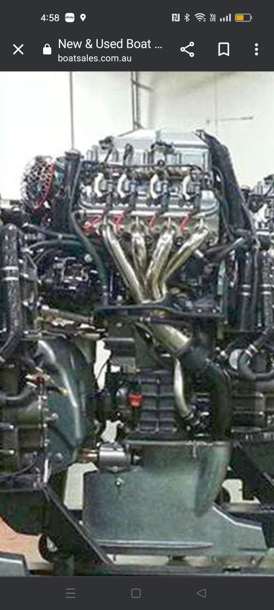

BrendAn Posted January 20, 2024 Posted January 20, 2024 Raw water cooling in outboards makes sense because it's simple and lightweight. If you google seven marine, which were large HP outboards using ls chev engines making around 5 or 600 hp from memory. They utilise a closed circuit freshwater cooling system so it can be done . 2
turboplanner Posted January 21, 2024 Posted January 21, 2024 5 hours ago, BrendAn said: Raw water cooling in outboards makes sense because it's simple and lightweight. If you google seven marine, which were large HP outboards using ls chev engines making around 5 or 600 hp from memory. They utilise a closed circuit freshwater cooling system so it can be done . Automotive engines have been marinised with water pumps and circulation hoses forever, and Mercury had a stern drive based on a Chev 350 branded Mercury and those systems work forever. If you take the next step to what you mention - a closed circulation system, stationary engines work all day provided they have a big tank about three times the size of the engine - you can put your hand in the water, and it may be possible to design a similar system to Rotax, but my point was that a lot of the engine design has to be changed if you start with a dedicated lightweight outboard engine; we used to test new truck systems by hauling a dyno around a circuit until the temperature flat-lined. If it didn't it was back to the drawing board with a bigger radiator and that might happen several times before a flat line performance could be obtained, so a lot of work, and you still have to deal with the high rpm and a suitable redrive. It would be simpler to design a low revving aircooled engine for the light weight. 1 1

BrendAn Posted January 21, 2024 Posted January 21, 2024 5 hours ago, turboplanner said: Automotive engines have been marinised with water pumps and circulation hoses forever, and Mercury had a stern drive based on a Chev 350 branded Mercury and those systems work forever. If you take the next step to what you mention - a closed circulation system, stationary engines work all day provided they have a big tank about three times the size of the engine - you can put your hand in the water, and it may be possible to design a similar system to Rotax, but my point was that a lot of the engine design has to be changed if you start with a dedicated lightweight outboard engine; we used to test new truck systems by hauling a dyno around a circuit until the temperature flat-lined. If it didn't it was back to the drawing board with a bigger radiator and that might happen several times before a flat line performance could be obtained, so a lot of work, and you still have to deal with the high rpm and a suitable redrive. It would be simpler to design a low revving aircooled engine for the light weight. Got no idea why you bring up MerCruiser stern drives. I was talking about SEVEN MARINES closed loop cooling on an outboard engine. I know almost every diesel on the market and many stern drives are closed loop cooling.
BrendAn Posted January 21, 2024 Posted January 21, 2024 The last model was 627 hp before Volvo Penta took them over and shut down production. These large outboards were designed for American boat manufacturers to cut down costs. When they use inboard engines the engine is sitting in the hull for weeks before it finished and sold. Outboards don't have to be purchased by the builder until the boat is sold. 1
