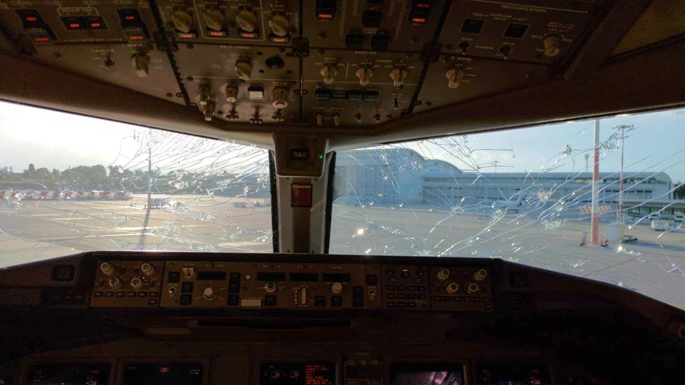

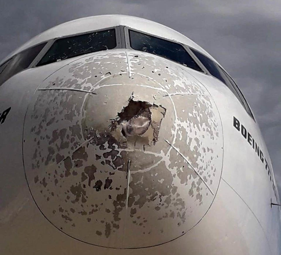

red750 Posted July 19, 2021 Posted July 19, 2021 The United Arab Emirates flight had taken off from Malpensa airport in the Italian city of Milan heading to New York's JFK airport when it flew into a storm with hail the size of tennis balls on Wednesday.

red750 Posted July 19, 2021 Author Posted July 19, 2021 Here's more from the original article: The United Arab Emirates flight had taken off from Malpensa airport in the Italian city of Milan heading to New York's JFK airport when it flew into a storm with hail the size of tennis balls on Wednesday. Lombardi Airports Association, located in the Malpensa Airport, told Newsflash that the plane "immediately after take-off from Malpensa entered a hail storm". "After about 97 minutes from take-off (the plane) returned to Malpensa,” it said. The crew had been forced to remain in the air despite the damage which happened only a few minutes after they set off because they needed to burn off the fuel. As it was a transatlantic flight, the plane had set off with a full tank and for safety reasons, there are limits to the amount of fuel planes are allowed to carry when landing. The airport officials said that the strong winds continued to cause problems for the flight which struggled to land before eventually touching down safely after two attempts. Lombardi Airports Association confirmed that the eventual landing was successful and there were no injuries reported from passengers or the flight crew.
