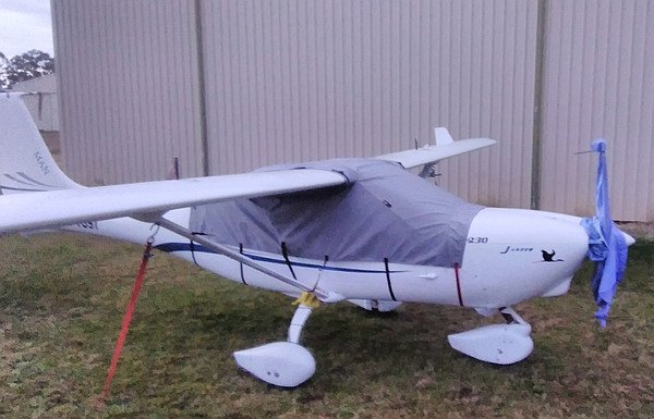

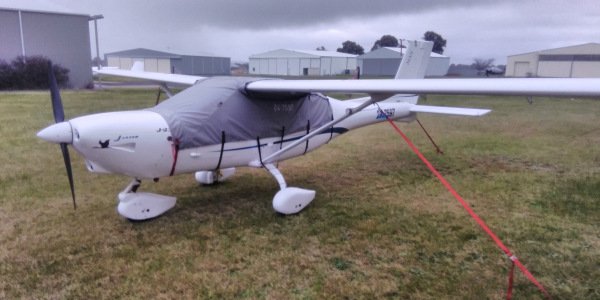

RFguy Posted July 14, 2021 Posted July 14, 2021 (edited) Really very sophisticated constructed cover. excellent value for money , nice sail cloth stuff with felt liner. fits well, no slop and no fluttering in the wind. Additional velcro seams for attachment to full all over cover. photos. (not sure if I have the ties around the struts right, I think I need to extend the straps (variable) full length and go around the leg.) I put it on for the first time in the near dark. Edited July 14, 2021 by RFguy 1

RFguy Posted July 14, 2021 Author Posted July 14, 2021 These ones are Weathermax fabric, better for shrink than the Sunbrella material (am told). And the velcro doesnt get attached to the lining. It's nice kit.

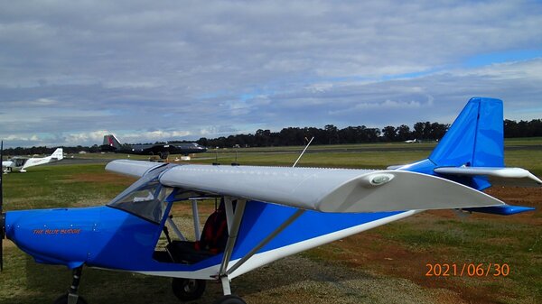

Guy s Posted July 15, 2021 Posted July 15, 2021 This is my Punkin cover which I purchase 5yrs ago when I finish build the Sav, I absolutely luv it and it's packs down well and it's very light and carry it in my travels. I even keep it on in the hangar at home as it keeps the dust off the windscreen. Also thought I'd would add a extra photo of the Canberra Bomber on it's second flight after 11yrs rest and restoration just after we landed at Temora recently which was pretty cool... 1

kiwiaviator Posted July 17, 2021 Posted July 17, 2021 I have the same one on my 230 Glen. Great covers and yes, I have the side straps around the main spring.

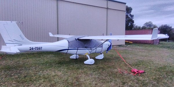

RFguy Posted July 18, 2021 Author Posted July 18, 2021 (edited) Got the straps right now... image before prop and cowling covered. Repegged after the winds and rain of last few days. despite the glum wx, got 0.8 in yesterday. fixed a CHT sensor. This material is reasonably heavy/stiff compared to some I've felt. Wont flap in the wind. Will move under cover before too long. Was in hangar until April. Sun/temp is not too strong down here this time of year. Edited July 18, 2021 by RFguy 2
