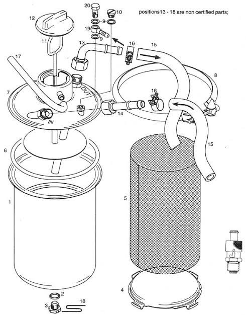

skippydiesel Posted June 3, 2021 Posted June 3, 2021 Just to assist you doubting Thomas's - Below are typical modern push on/hose applications, (note the non barbed spigots): The after market customer expects to purchase a "barbed" spigot - so that's what the supplier gives him - to do otherwise would require "expensive" (lost sales) education. Manufactures on the other hand have found a better way and overwhelmingly have moved to non barbed spigots.

Thruster88 Posted June 3, 2021 Posted June 3, 2021 1 hour ago, skippydiesel said: Googled "push lock" -turns out I have used this system on plastic (potable) house water supply systems - great, very quick, bit costly and I would expect to be heavy in an aircraft application - not sure how this relates to barb or no barb hose push connections. Back on track - I had forgotten - my Rotax oil hoses, are all no barb push fittings. What say the naysayers to that? The rotax 912 oil system's that I have seen have these fittings, they definitely have barbs. You could get away with no barbs because all external oil lines on a rotax 912 have no pressure in them, suction or atmospheric pressure only. 1 1

skippydiesel Posted June 3, 2021 Posted June 3, 2021 1 minute ago, Thruster88 said: The rotax 912 oil system's that I have seen have these fittings, they definitely have barbs. You could get away with no barbs because all external oil lines on a rotax 912 have no pressure in them, suction or atmospheric pressure only. Man! I mentioned the raised collar, on some non barb, push fittings way back in this conversation and I complete dispute that this feature can be called a "barb" - a barb being a sharp edged devise designed to make removal, without damage, impossible. Further the "barb" style of fitting requires multi small points of contact to make a seal. This is why so many people apply damaging pressure, using a hose clamp, to ensure a seal. The smooth pipe relies on the correct size of hose being in contact with a much much larger surface area. In this situation the seal has been achieved and the clamp, lightly tightened, provides security/ hose from slipping. How do you figure the oil lines have no pressure? If this were the case the oil would not circulate. The oil lines are subject to both negative (suction) and positive (return) pressures. The point is not the pressure per say but the ability of the (low pressure) system to resit leaking (air in/oil out) and the hopefully reasoned choice you might make between the traditional multi sharp(ish) ring style and newer smooth pipe, often fitted with a smooth ring/swelling, to do the job. I agree that these fittings are designed for low pressure (not nil) as is the case for the fuel lines under discussion. High pressure lines require a very different engineering approach. Check out the photos I provided above - other than size they are all similar to the Rotax fittings in your schematic.
