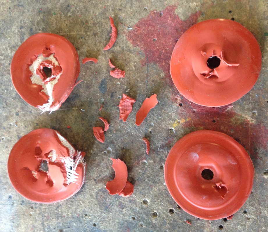

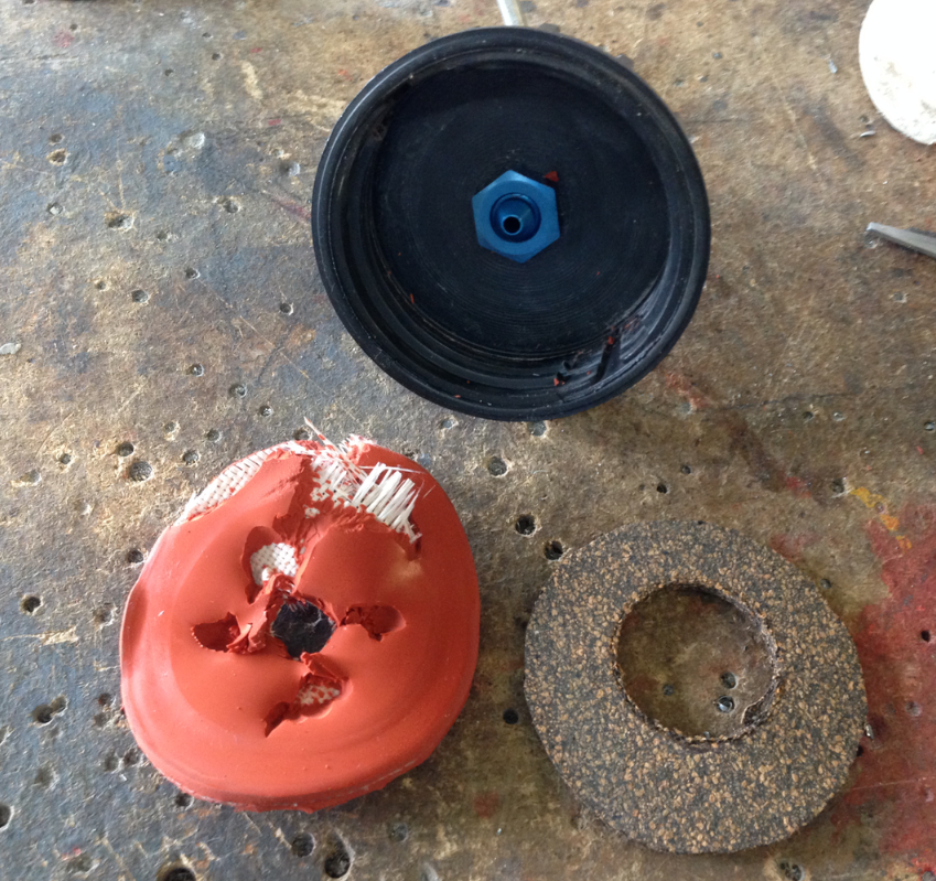

pylon500 Posted June 1, 2021 Posted June 1, 2021 Just a heads up to people out there doing their own thing, orange baffle rubber (and I think orange fire-sleeve) does not like fuel and will break down. History; While refuelling a Savanah, I would typically unscrew the fuel cap and sit it on the wing next to the filler neck. This one time, as I picked up the cap, I found a piece of orange 'rubber' sitting on the wing? Looking under the cap I discovered someone had manufactured 'gaskets' for under the cap, made of glass reinforced baffle rubber (a neoprene I think), checking the other caps I found they were all falling apart! New seals were made from rocker cover rubber/cork composite. 4

John Robert Posted June 1, 2021 Posted June 1, 2021 This is exactly why LSA including experimental LSA is controlled by the manufacturer & alterations are not allowed. Even though the replacement may appear to be ideal & serve its purpose as a gasket , it may behave very differently with immersion in fuel that could possibly contain ethanol. It may be of interest to see my recent post in "3300A a tale of two etc" . If we follow the rules there is virtually no place for mods even in Experimental LSA. The option to do as we were able under the "19" home built registration has been taken from us. LSA may server CASSA & RAA well. It does place more regulation on the builder maintainer. I some case it may be a good thing when looking at the pics of those old parts removed.
