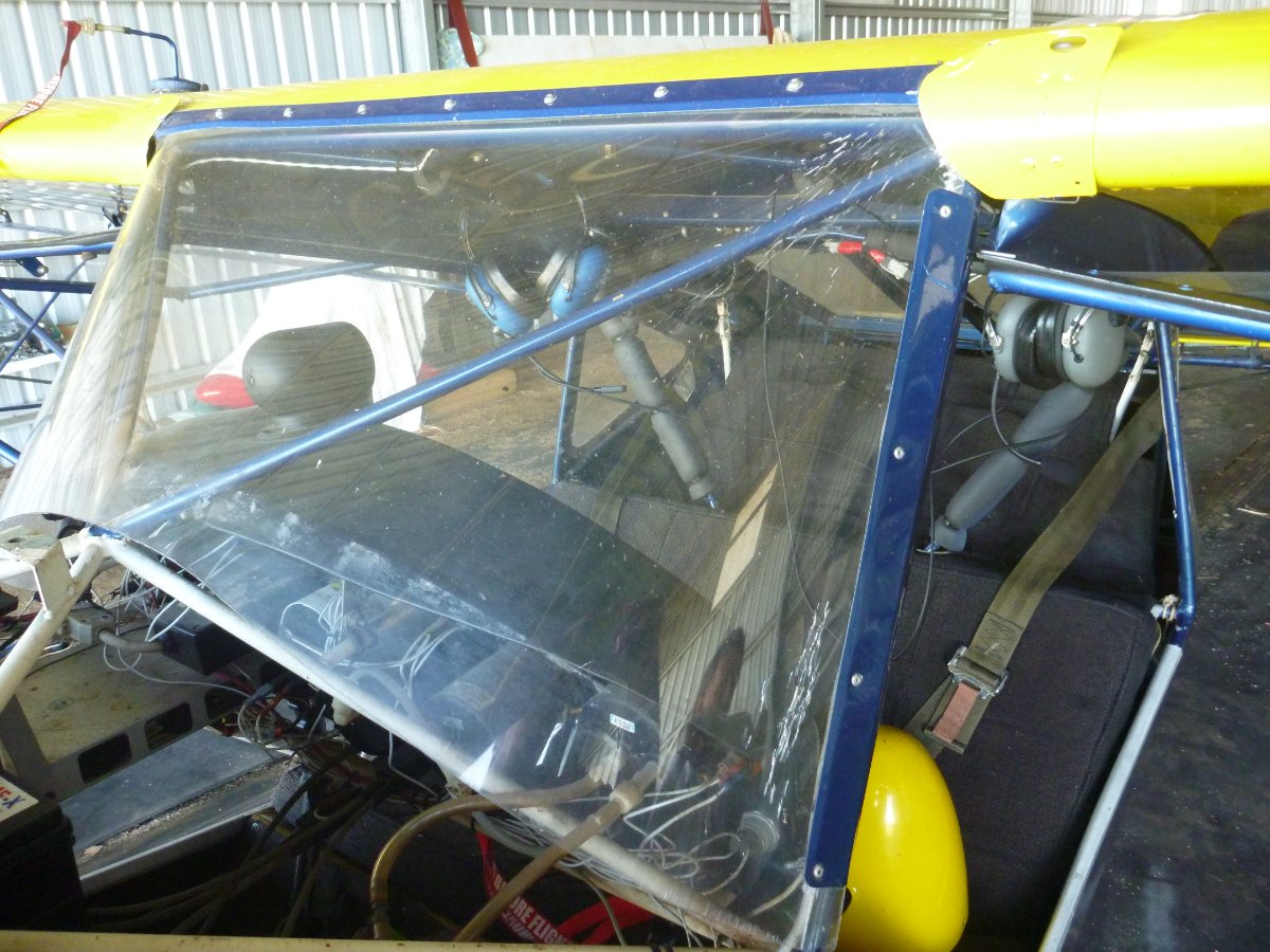

F10 Posted May 11, 2021 Posted May 11, 2021 Anyone know where I could get a windscreen made, or is there a way to bend a piece of Lexan to fit? My windshield is ok, but it has a stop drilled crack in the top RH corner. The crack has had a rectangle of thin plastic glued over it, so has been well repaired I think, but it still looks a bit second hand. Fortunately the thick piece of Perspex making up the roof looks pretty new. I replaced the decking windows, a fairly simple and fun job. Remember to label all the supports with "L or R, front, back" with masking tape, as they need to go back in the same place to fit the rivet holes.

planesmaker Posted May 11, 2021 Posted May 11, 2021 2mm polycarbonate (lexan) is used for windscreen. It forms around ok yes a little tight in the corners. 1

F10 Posted October 1, 2021 Author Posted October 1, 2021 On 11/05/2021 at 9:14 PM, Blueadventures said: Looking good! Like your yellow wings and blue fuselage, always enjoyed that US Navy type colour scheme. Yep the problem is that small radius curved area near the wing leading edge pins….I can appreciate you can get stress cracks there over time. Haven’t got around to this yet, not a big priority at this stage. I see it appears you have modded your fuel tank breather pipes, facing into wind. I think the original design is quite good but has tight tolerances so needs checking for blockages. I always blow through them to check. I have heard some Gazelles can suck fuel from one tank more than the other, which can be a bit worrisome in flight!

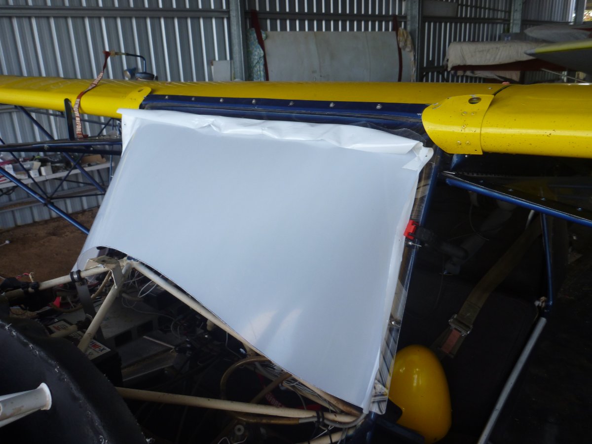

Blueadventures Posted October 1, 2021 Posted October 1, 2021 1 minute ago, F10 said: Looking good! Like your yellow wings and blue fuselage, always enjoyed that US Navy type colour scheme. Yep the problem is that small radius curved area near the wing leading edge pins….I can appreciate you can get stress cracks there over time. Haven’t got around to this yet, not a big priority at this stage. I see it appears you have modded your fuel tank breather pipes, facing into wind. I think the original design is quite good but has tight tolerances so needs checking for blockages. I always blow through them to check. I have heard some Gazelles can suck fuel from one tank more than the other, which can be a bit worrisome in flight! The old one is the stress cracked one, the new was all good. Very easy cut and fit.
F10 Posted October 1, 2021 Author Posted October 1, 2021 (edited) Ok! So confirm, Lexan, about 3 mm thick? 1 m square? Edited October 1, 2021 by F10

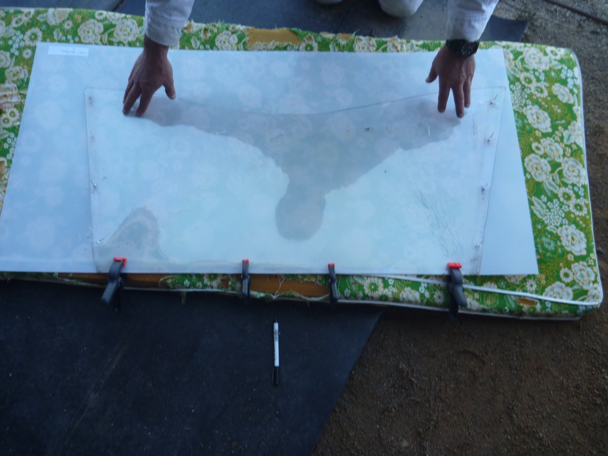

Blueadventures Posted October 1, 2021 Posted October 1, 2021 12 minutes ago, F10 said: Ok! So confirm, Lexan, about 3 mm thick? 1 m square? Not sure of size, as in image bought an over size piece and cut out of that.
F10 Posted October 1, 2021 Author Posted October 1, 2021 Yep, I planned to use the old screen as a template. But thickness, I recon about 3mm?
Blueadventures Posted October 1, 2021 Posted October 1, 2021 27 minutes ago, F10 said: Yep, I planned to use the old screen as a template. But thickness, I recon about 3mm? I think it was 2mm from memory. I did same for same thickness. You will see when you have the cowl off as you will see the thickness.
