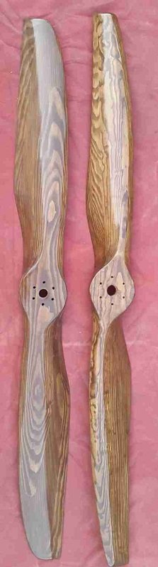

meglin Posted July 9, 2022 Posted July 9, 2022 Mon opinion est la suivante: il est très utile d'essayer de concevoir et de fabriquer une hélice, alors vous saurez exactement ce que vous payez en commandant une nouvelle hélice. 1
meglin Posted July 9, 2022 Posted July 9, 2022 (edited) Sorry, I didn't find how to delete unnecessary messages. Edited July 9, 2022 by meglin
meglin Posted July 9, 2022 Posted July 9, 2022 My opinion is this: it is very useful to try to design and manufacture a propeller, then you will know exactly what you are paying money for when ordering a new propeller. 1 1

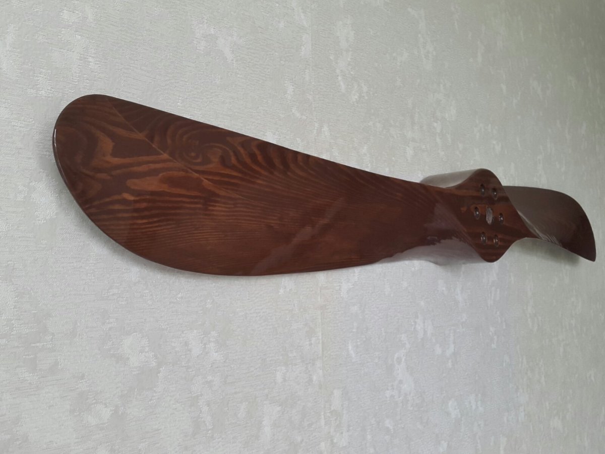

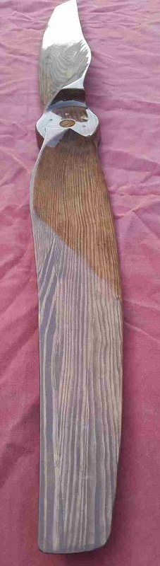

meglin Posted July 31, 2022 Posted July 31, 2022 This is a decorative propeller for symbolic money: 3
facthunter Posted July 31, 2022 Posted July 31, 2022 That's a lot like a Sopwith Camel prop that used to be hung above Aero Club Bars. Big and slow revving. Nev 1
