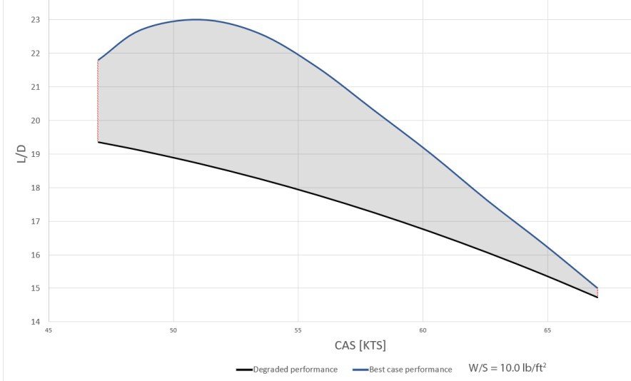

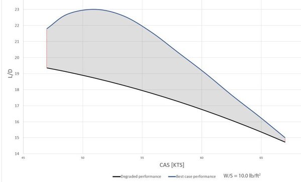

FlyBoy1960 Posted January 12, 2021 Posted January 12, 2021 okay, I have managed to get more information and this is a screenshot from the manual of an aircraft showing the difference between the glide performance when the propeller is completely stopped and the engine/propeller is at idle. The top row which is blue is the aircraft performance with the propeller and engine at idle. The bottom row is the engine and propeller stationery. As you can see the glide performance is massively better with the engine running until you get to about 70 kn where the running engine will start to deteriorate the performance due to excessive drag. I think this information form a certified aircraft manual really puts the subject to bed. All of the training that we do with the engine at idle practicing forced landings is a good part of our training but the performance is significantly different when the engine actually stops. In this aircraft's case at 52 kn airspeed the difference is more than 20% to graded performance with the engine turned off and a propeller stationary, contrary to Flat Earth people who think an engine at idle is creating more drag than a stationary propeller. In my opinion we should be teaching people precautionary landings with the engine at idle, but they must know that there will be at least 20% difference when the engine is actually stopped. Demonstrated performance reduction between an engine on and at idle, and engine off and propeller stopped. between V1 = 23 and V2 = 18.8 |V1−V2|[(V1+V2)2]×100=?|V1−V2|[(V1+V2)2]×100=? =|23−18.8|[(23+18.8)2]×100=|23−18.8|[(23+18.8)2]×100 =|4.2|[41.82]×100=|4.2|[41.82]×100 =4.220.9×100=4.220.9×100 =0.200957×100=0.200957×100 =20.0957% difference 1
JG3 Posted January 12, 2021 Author Posted January 12, 2021 What sort of aircraft is that with a 22:1 glide ratio?? That's darn near a glider..... Nothing like most of the recreational aircraft we fly, with GR around 10:1..... 1
APenNameAndThatA Posted January 13, 2021 Posted January 13, 2021 So, it looks like a draggy aircraft performs 10% worse and a really slippery aircraft performs 50% worse with the prop stopped vs idling. That makes sense, and is something for me to remember. Thank you for the info. 1
FlyBoy1960 Posted January 13, 2021 Posted January 13, 2021 The info came from the certified Virus SW model from Pipistrel
facthunter Posted January 13, 2021 Posted January 13, 2021 If your thinking of things like 50% worse, I'd be going on more than assumptions. You need facts relating to individual types and more specific conditions. Operating speed range. Turbo props can have drag of double the forward thrust if the prop is still turning. That's why they often REQUIRE auto feathering to be certified on some planes. Nev
