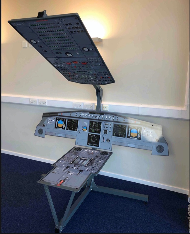

A static procedural trainer would be of value, this is a mock up of the cockpit of training aircraft and can be constructed for a few hundred dollars. The use is limited to learning procedures such as engine start, pre takeoff, engine failures etc. Radio calls can also practiced by setting up scenarios in something like a hangar with local features / airfield drawn on the floor with chalk.
Unless you’ve got a budget of a couple of hundred thousand dollars flight simulators are of little value in initial training.
I have worked full time in simulator training for the past 20 years, I have found basic procedures training is far more effective in static training devices.
