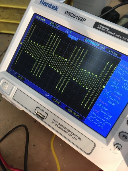

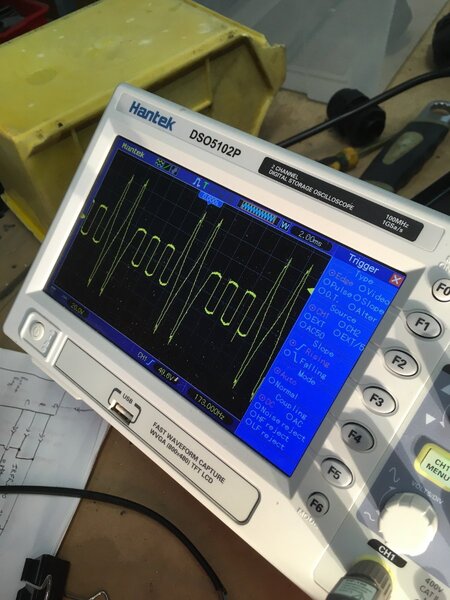

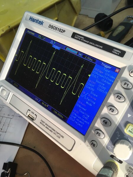

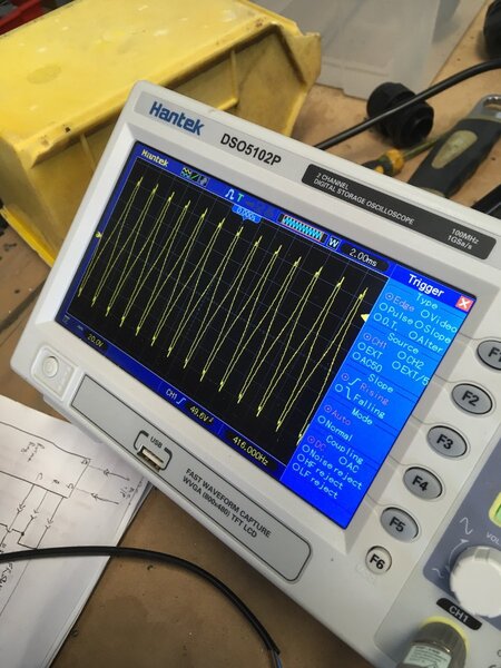

Kyle Communications Posted December 27, 2020 Posted December 27, 2020 The Rotax generator is a dirty simple thing. The std regulator is also a dirty and poorly designed and built unit. Typical of most motorbike stuff. The reg we have redone and running is far better it is also capable of very good current limiting and voltage regulation. We have a unit testing now and it has gone through some "fine tuning". I am currently doing the final layout of the pcb. It will be in 2 parts. You can have a very good regulator only and with another unit that bolts on underneath you can then have current limit and voltage limiting which will allow you to use a Lithium battery safely. It will of course charge other chemistry batteries perfectly fine. This is a early version the regulator only. 3 1
RFguy Posted December 27, 2020 Author Posted December 27, 2020 Hi mark, thanks for chiming in...., are those scope pics of the factory regulator or yours going in and out on a cycle by cycle basis ? looks like a suitable method, cycle by cycle basis. That waveform- looks like not too much problem with stator core saturation when unloaded ? That can lead to the cores being biased up one way. Depends on the core material used I am going to do a simple buck-boost PFC style regulator- I will be able to get more out of the alternator this way, and probably achieve better alternator stator temps due to a more favourable powerfactor than a straight rectifier-cap. I'd done buck-boost PFCs up to 5kW, so a 250W one should be straightforward... -glen

Kyle Communications Posted December 27, 2020 Posted December 27, 2020 Thats one of ours....the std generator is max 18 amps but it gets pretty hot. The big issue is the actual ducati regulator..its a POS. They use a std bridge rectifier in it and the amount of heat often creates bad a cooked solder joints on the main current components. Ours uses high current single package diodes and SCR's. Thats from a year ago those waveforms..its even better now. We decided to limit the current to a base of 10 amps so not to cook Litium batteries if the internal BMS craps itself in the battery and also by limiting the voltage you should never have any issue with the Lithium. There is a plug selector to allow higher currents up to 14 amps for charging. We decided that was the limit for the generator. Ours has far far better heatsinking as well. It also has the same hole mounting specs as the original 1

Kyle Communications Posted December 28, 2020 Posted December 28, 2020 Glenn the Rotax has 8 poles and at 5800 rpm its about 464 hz out of the generator. You can see at around 5000 rpm on the first cro pic the freq is 416hz
