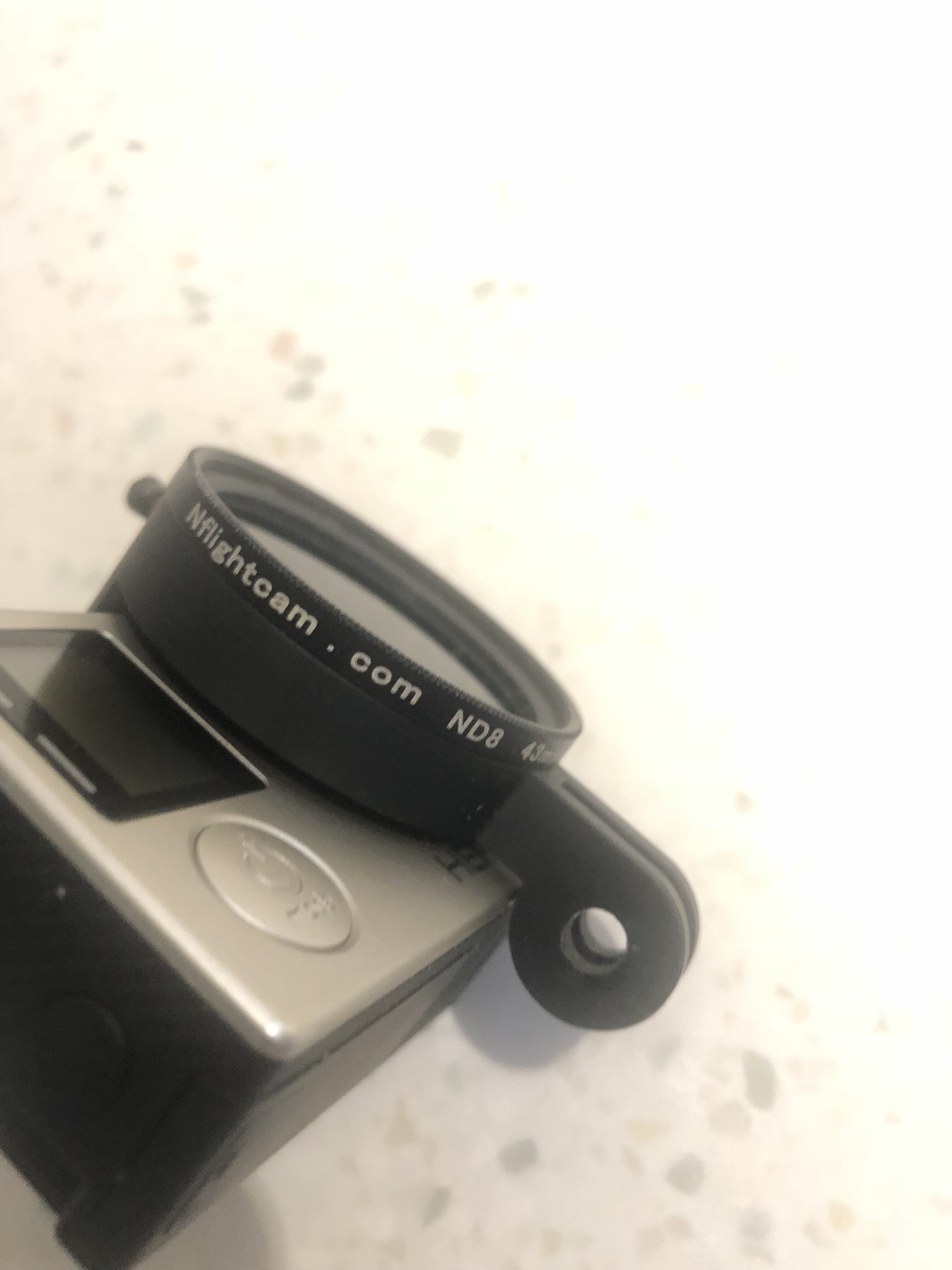

Roscoe Posted April 28, 2020 Author Posted April 28, 2020 What's a prop filter Roscoe? I've never heard of such a thing... it sounds a bit like the interruptor they invented in WW1 so you could shoot through the prop. But I'm sure its not that in this case. Its a round plastic lens that fits over the camera lens and filters out that annoying prop slow motion movement that gets picked up in flying videos. Its a common filter called an ND8. Camera shops have them. 1

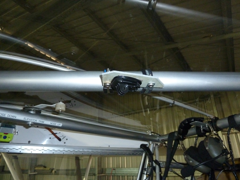

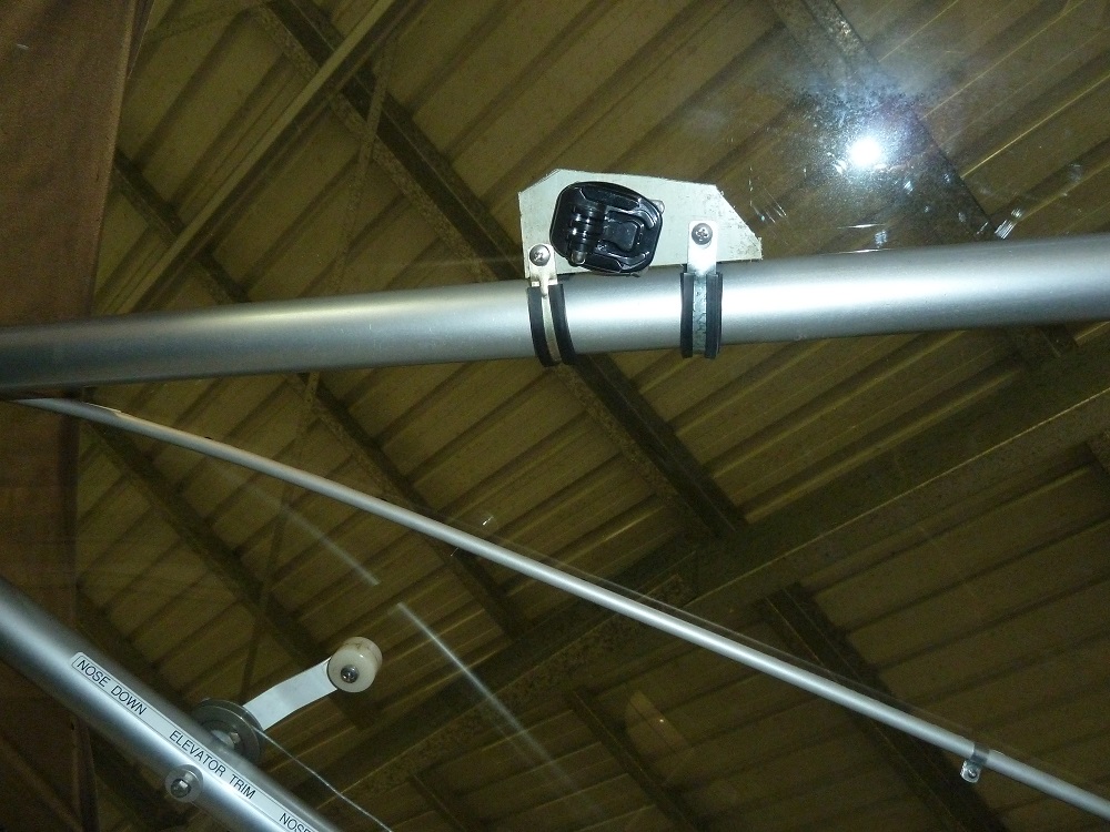

kgwilson Posted April 28, 2020 Posted April 28, 2020 I stuck mine on the bulkhead behind me in the centre & it gives a good 170 deg view plus I wanted the panel in the video as well so I could check things later. I posted a couple of videos on you tube. You can see them and The only problem I guess is that Jabirus don't have a bulkhead like my aircraft. 1
Roscoe Posted April 28, 2020 Author Posted April 28, 2020 Its a round plastic lens that fits over the camera lens and filters out that annoying prop slow motion movement that gets picked up in flying videos. Its a common filter called an ND8. Camera shops have them. I stuck mine on the bulkhead behind me in the centre & it gives a good 170 deg view plus I wanted the panel in the video as well so I could check things later. I posted a couple of videos on you tube. You can see them and The only problem I guess is that Jabirus don't have a bulkhead like my aircraft. Great videos thanks Kevin. Yes the Jab cabin roof is difficult to get a compromise between outside view and my ugly head in the shot!!

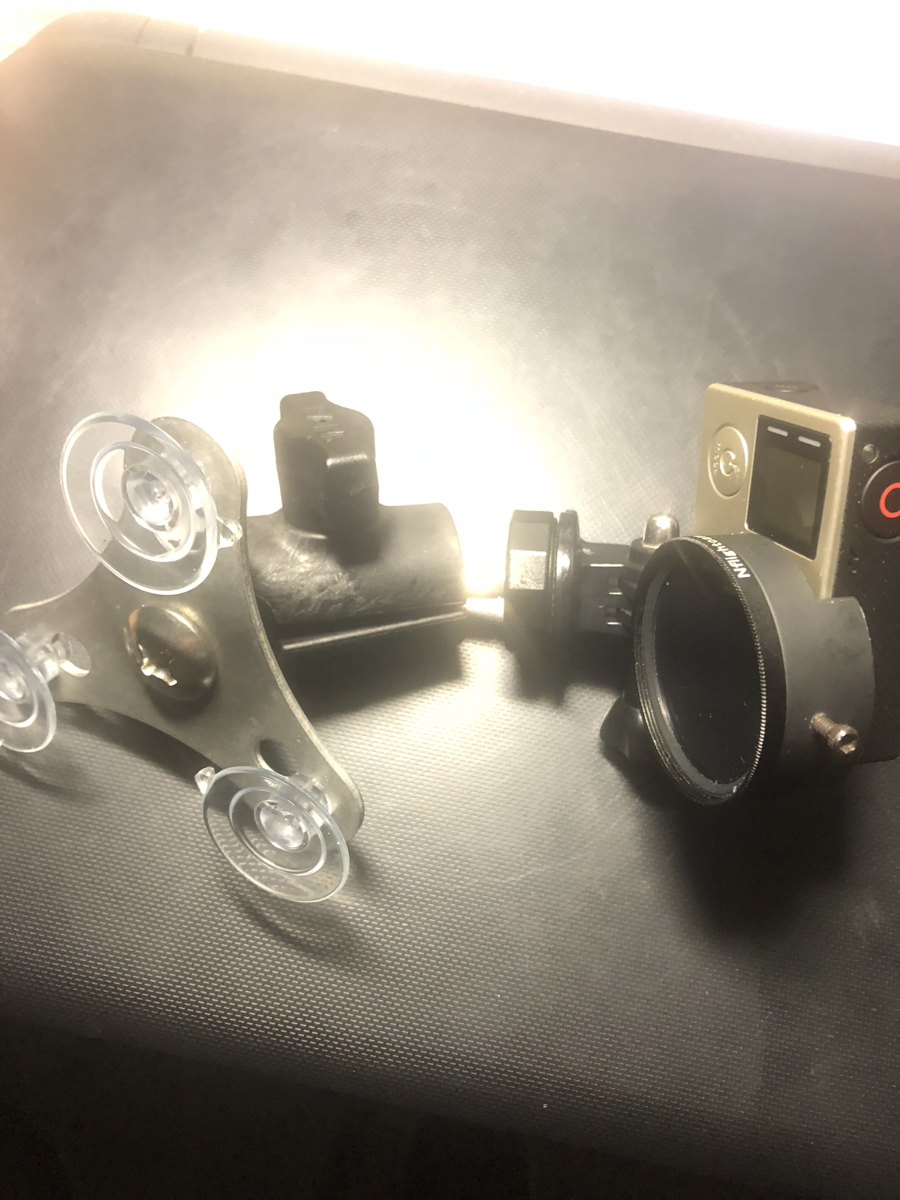

Roscoe Posted April 29, 2020 Author Posted April 29, 2020 Photo above works well at the top of the Windscreen with Audio Cable velcro d around top of the door. Camera can be moved around. The Suction cup setup is lighter than the big heavy RAM Suction cup. Time will tell how it goes

APenNameAndThatA Posted April 29, 2020 Posted April 29, 2020 So the ND8 is makes everything darker, so the exposure is longer, so the prob blades are more blurred? Good idea.

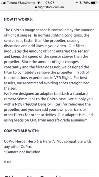

Roscoe Posted April 29, 2020 Author Posted April 29, 2020 So the ND8 is makes everything darker, so the exposure is longer, so the prob blades are more blurred? Good idea.
Roscoe Posted April 29, 2020 Author Posted April 29, 2020 I have not noticed any darkening of the image when played back. The Nflightcam Website gives a full rundown of tnis and other products they have for in flight photography
Old Koreelah Posted April 29, 2020 Posted April 29, 2020 I have not noticed any darkening of the image when played back. The Nflightcam Website gives a full rundown of tnis and other products they have for in flight photography A lens or two from broken sunnies does the same job.
Yenn Posted April 30, 2020 Posted April 30, 2020 The ND8 looks to me to be just a neutral density filter, designed to reduce the amount of light transmitted, allowing a bigger aperture to be used with fast films and therefore less depth of field, or even allowing fast film to be used with a slow camera in high light situations.
