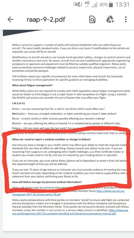

Matty Posted October 5, 2019 Posted October 5, 2019 Is there a requirement that we have to notify RAAus if we are medicaly unfit? I am not aware of one. Only if you are an instructor it would seem from the Raaus webpage.
circuitsun Posted October 8, 2019 Posted October 8, 2019 [ATTACH]41643[/ATTACH] That's unreadable Matty
spacesailor Posted October 8, 2019 Posted October 8, 2019 It;s CASA's new eye sight test. spacesailor 3
Thruster88 Posted October 8, 2019 Posted October 8, 2019 That's unreadable Matty Can read it easy with a click and zoom on a Samsung tab 1
Matty Posted October 8, 2019 Posted October 8, 2019 It;s CASA's new eye sight test. spacesailor IQ test more like it....
circuitsun Posted October 8, 2019 Posted October 8, 2019 Can read it easy with a click and zoom on a Samsung tab Mmm my apple must be substandard!
circuitsun Posted October 8, 2019 Posted October 8, 2019 IQ test more like it.... Yeah I prefer eyesight test thanks, Does explain why I land better when I close my eyes 1
