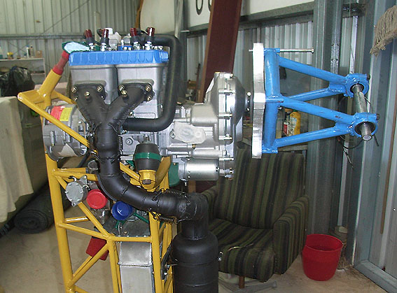

Oscar Posted February 14, 2016 Posted February 14, 2016 Mike, The rumour mill has a retired Aero engineer somewhere near Toowoomba close to finishing converting a Blanik sailplane to be self launching, powered by a 503 Rotax driving a single bladed self feathering prop. I believe he has studied it all very thoroughly and is satisfied that his proposed setup will give him the greatest efficiency. Jeez, get it right. It's a 582 Blue-Head Rotax. [ATTACH]26801[/ATTACH] And the Everel concept isn't 'self-feathering', it's more like a 'constant speed' prop: at high rpm the geometry reduces it to fine pitch so the thrust is maximised; when throttled back, it automatically coarsens pitch for best economy. However, at much more than around 100 hp, other factors make the Everel concept inefficient. But, you're right: somewhere near Toowoomba. And a Blanik. With the necessary mods. to allow it to fly. Rumour has it the bugger has several 'legal' Blaniks in his hangar, after some metal-bashing has been done to repair damage to one of them.
