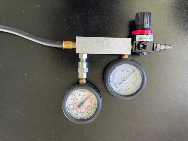

Tasmag Posted March 3, 2023 Posted March 3, 2023 16 hours ago, MartyG said: Thanks for all the info guys, Found this on a Aussie site but doesn't say what size the orifice is but I will call them. https://premium-diagnostics.com.au/products/cylinder-leak-down-tester-compression-leak-detector-petrol-engines I purchased this exact kit, total POS. (Not from there, and not that price though) The orifice size looks like it was blown out with Oxy! Been meaning to fix it but haven't bothered yet. (Using a loaner instead) Mike 1 2
kiwiaviator Posted March 3, 2023 Posted March 3, 2023 1 hour ago, Tasmag said: I purchased this exact kit, total POS. (Not from there, and not that price though) The orifice size looks like it was blown out with Oxy! Been meaning to fix it but haven't bothered yet. (Using a loaner instead) Mike I made the mistake of buying one of these. I have finally retrofitted the POS % gauge with a real gauge and it seems to work ok. Didn't check the orifice in the block. Maybe I should.... 2 1
Tasmag Posted March 3, 2023 Posted March 3, 2023 Might be worth checking, I swapped the gauge out and was getting really good leak Down numbers, but when tested against another, and checked the orifice, it was always going to give 80/78's😀 2 1

Old Koreelah Posted March 10, 2023 Posted March 10, 2023 Finally decided which one to buy, mostly because both its gauges match, unlike the crap automotive kits which have % on one dial. Ordered on Tuesday, arrived Friday at my address in the sticks. Impressive, but the plurry fittings are not compatible! Time for another rant about lack of standardisation. All my compressed air stuff uses Nitto fittings; this one aint. Another damned trip to the big smoke to buy compatible couplings. 1 1
