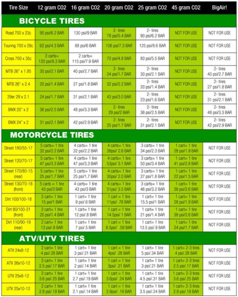

The little CO2 things used for sparkling drinks might be the go . You would need a needle valve (easy to get) to regulate the gas flow required. CO2 has the advantage of being fire retardant, so no risk whatever of spark causing explosion in the container. Make if all from aluminium and it weighs virtually nothing and stores easily.. Nev
That’s not a bad idea! You may not know this but they sell similar gas bulbs for bicycles. That would have the advantage of having a valve set up you could adapt to the task. Not sure what gas it would be though. I suspect nitrogen which would be fine.
Was thinking of carrying a couple of those for emergency tyre repairs but if they are cheap enough could use them for fuel as well
Some tyres are nitrogen filled. It's probably the best gas to use. CO2 is a fire retardant and not toxic. It does displace oxygen and gets cold when released as do all gases when they expand.. Nev
Wow! - another idea from "out of the box" - I have no doubt that the concept is sound, but how many "soda bombs" will be needed to drive 20 litres of fuel out of a 23 litre (bladder) volume??
