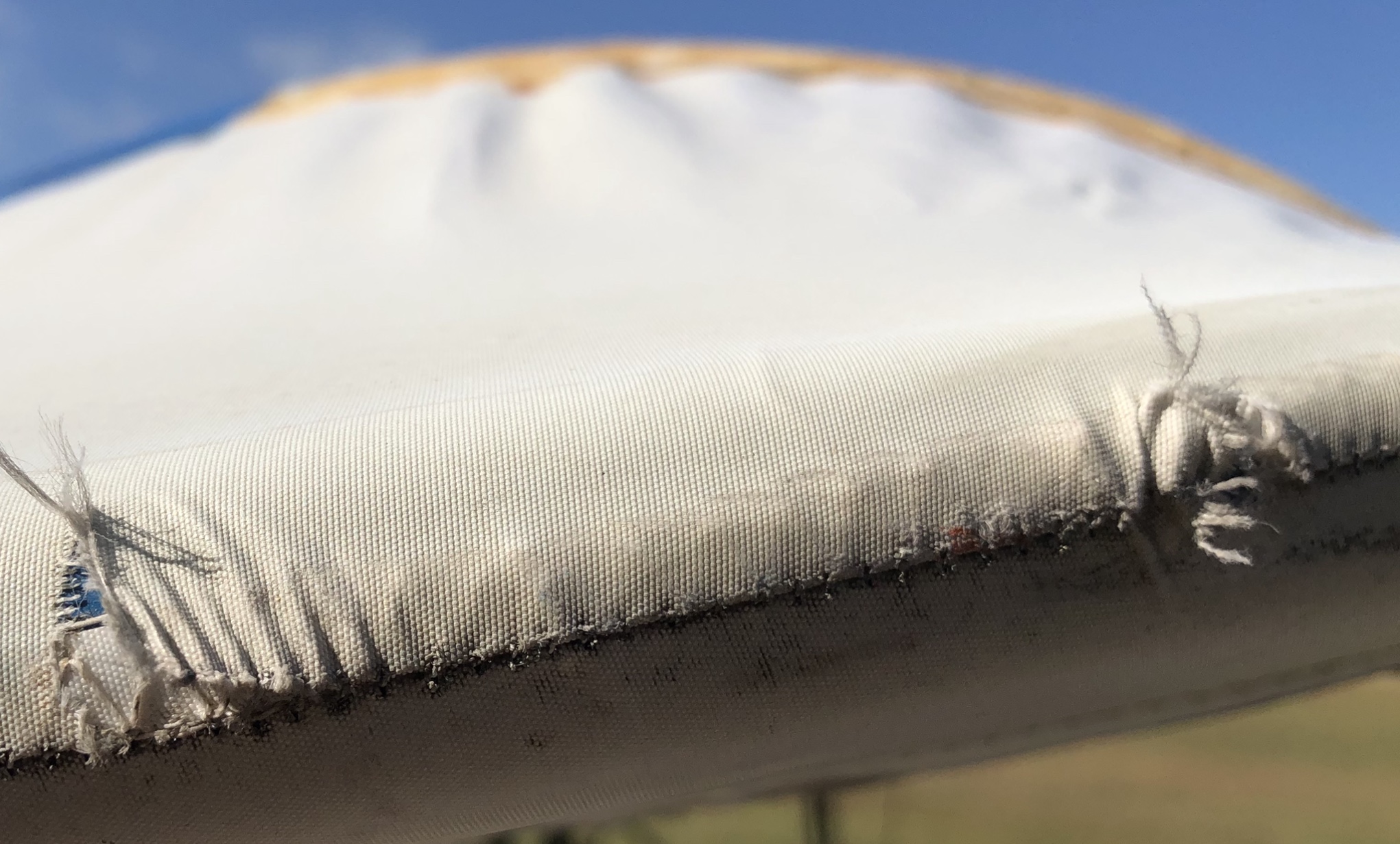

Mike Gearon Posted March 16, 2020 Posted March 16, 2020 Some interesting videos regarding fabric tension/condition. Well worth watching Here's the link to the Quicksilver supplier www.air-techinc.com ($US57) Comparing the Maule Fabric Tester to the Quicksilver one, I prefer the latter because the presence of the indicating O-ring would make it easier to calibrate the graduated inner rod. Although a simple calibration test to locate the critical point (10 lbs or 4.5 Kg) would provide a pass/fail mark on the rod. That’s a great video. Found it because I’m playing with the idea of a quicksilver float plane for USA. Can land at field near our South Dakota house then fly out to pontoon boat my in-laws will be on Missouri River/ Lake Andes. I flew with this fabric (not saying where and when) and became a bit relaxed about it. The video says otherwise. Maybe this is a different fabric. Seems a stronger weave than the test video.
old man emu Posted March 16, 2020 Posted March 16, 2020 I flew with this fabric The fabric itself might be OK after that tear is patched, but the amount of dirt along the stitch seam suggests that it was a long time ago that the covering job was new. I'd be concerned about the strength of the stitches. As Alice Cooper said in Unfinished Sweet: "The teeth are OK, but the gums gotta go!" 1
