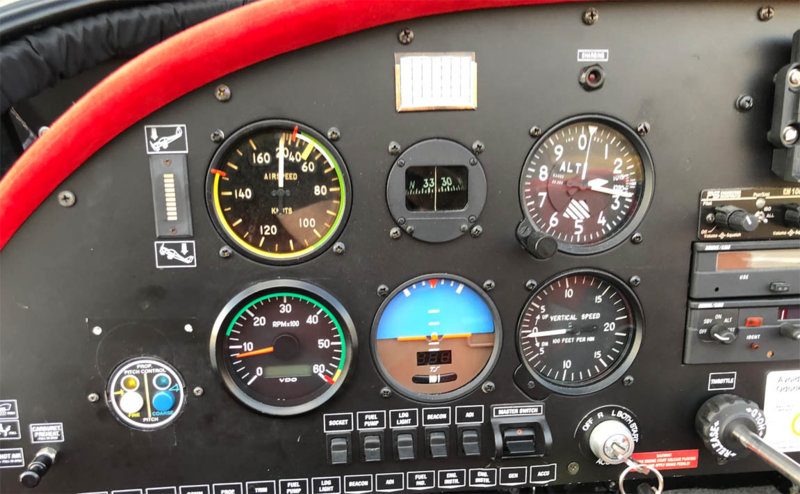

BirdDog Posted January 6, 2018 Author Posted January 6, 2018 It's all good lads. Like I said, Evektor are coming to the party. I have spoken with them and the Authorisation should be with me next week. :) I agree with illegal mods - just frustrating - hence why I have gone to Evektor. 1
BirdDog Posted March 3, 2018 Author Posted March 3, 2018 SO... I am now a happy boy! Evektor came through with the LOA and RAA are happy. I have had the Tach installed and happy as a pig in sh%t. Having the Tach right in front of me is SO much easier to manage, and the entire flying experience is way better that trying to see the Tach on the right side. A little costly, but I think it was way worth it.

danny_galaga Posted March 9, 2018 Posted March 9, 2018 Slightly off-topic, but I was once peeking inside a helicopter at Echuca, and the engine instruments looked like they'd been thrown at the panel - nothing was straight, with some instruments up to 45 degrees rotated. It all became clear when I asked the pilot about this; at normal pressures & temps, all the needles should point straight up. This allowed a much quicker check on P's&T's.mal Maybe that could be a solution for the OP? Apparently some military aircraft did this and I’ve seen it in old English sports cars. Is rotating the gauge considered modification? You’d only have to make sure there is enough wiring slack
