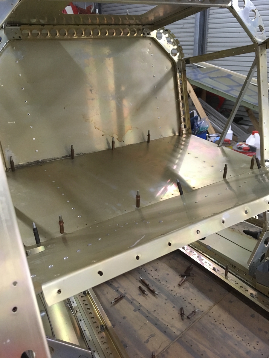

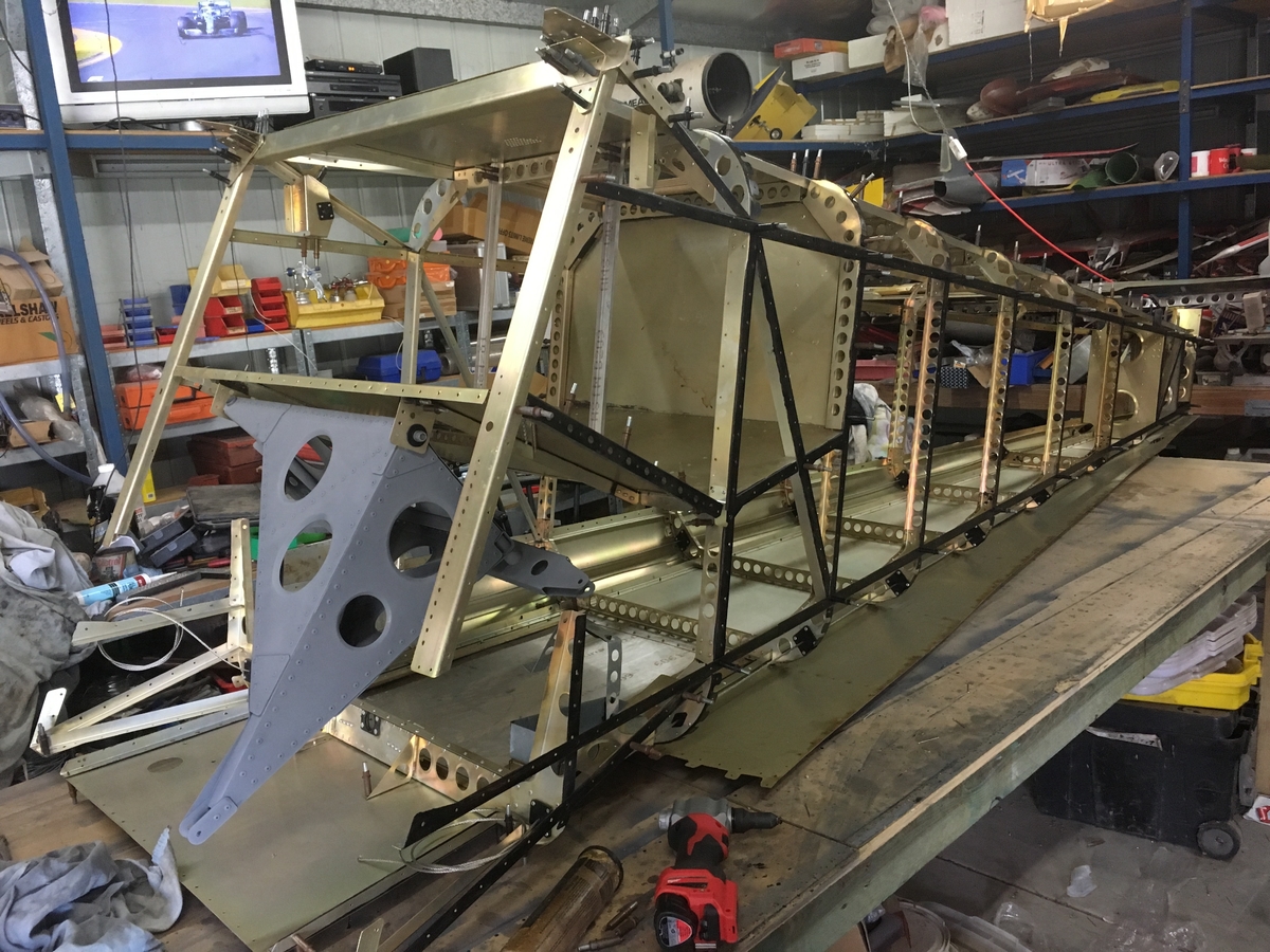

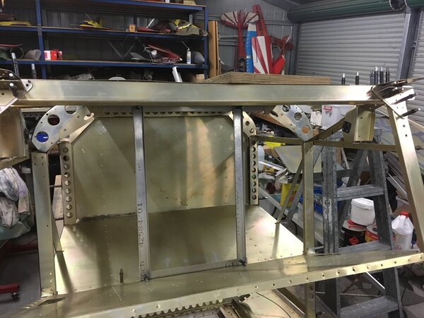

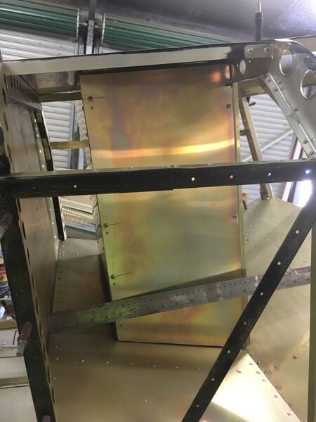

Managed to do a reasonable amount of work on Mabel last week and this weekend. Lots of making joints and breaking them again to sort out the mess that had been done when she was originally put together. Rule number one with a savannah kit is if it doesnt fit you have done something wrong. This obviously doesnt compute with the original builder.

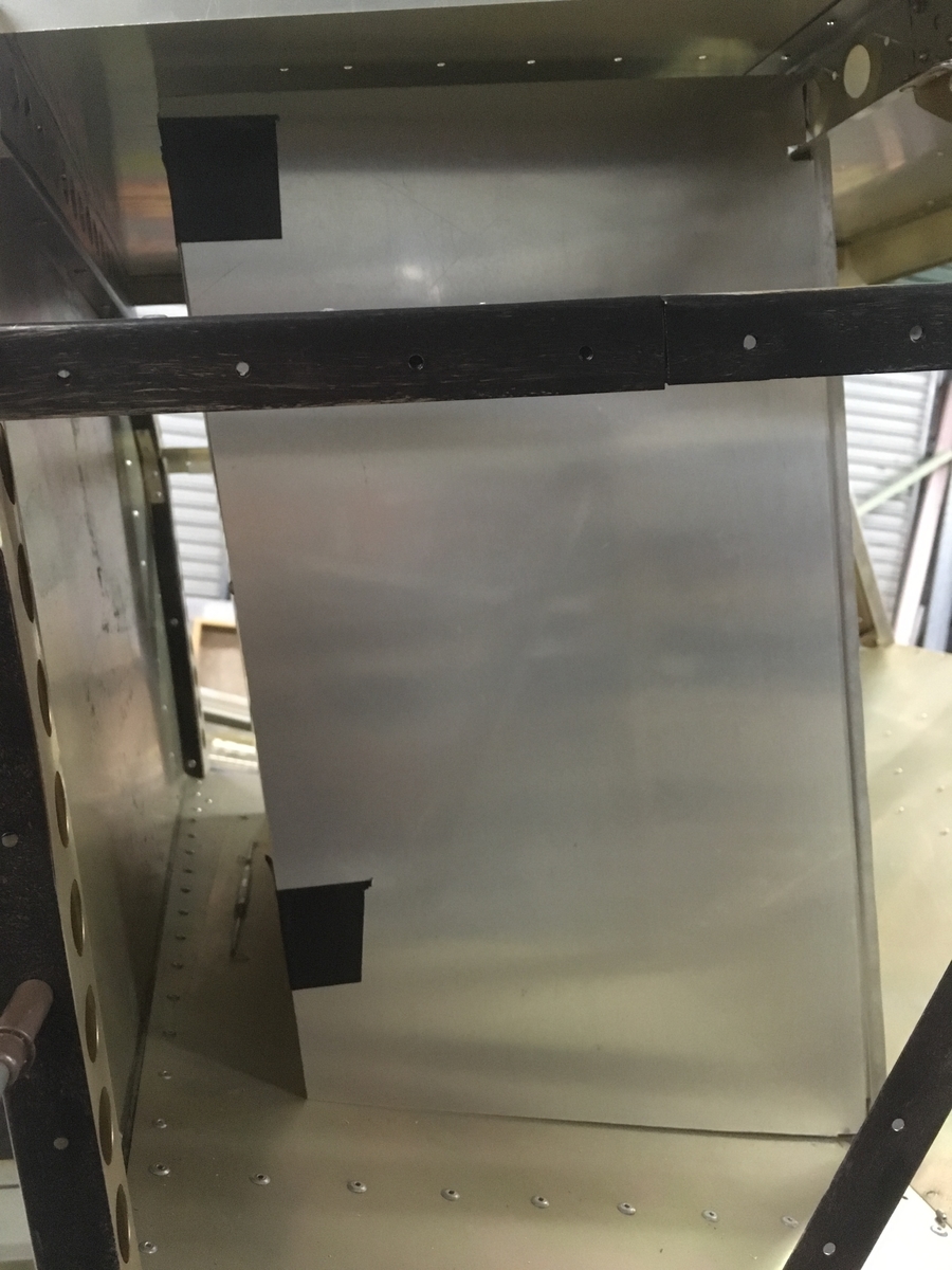

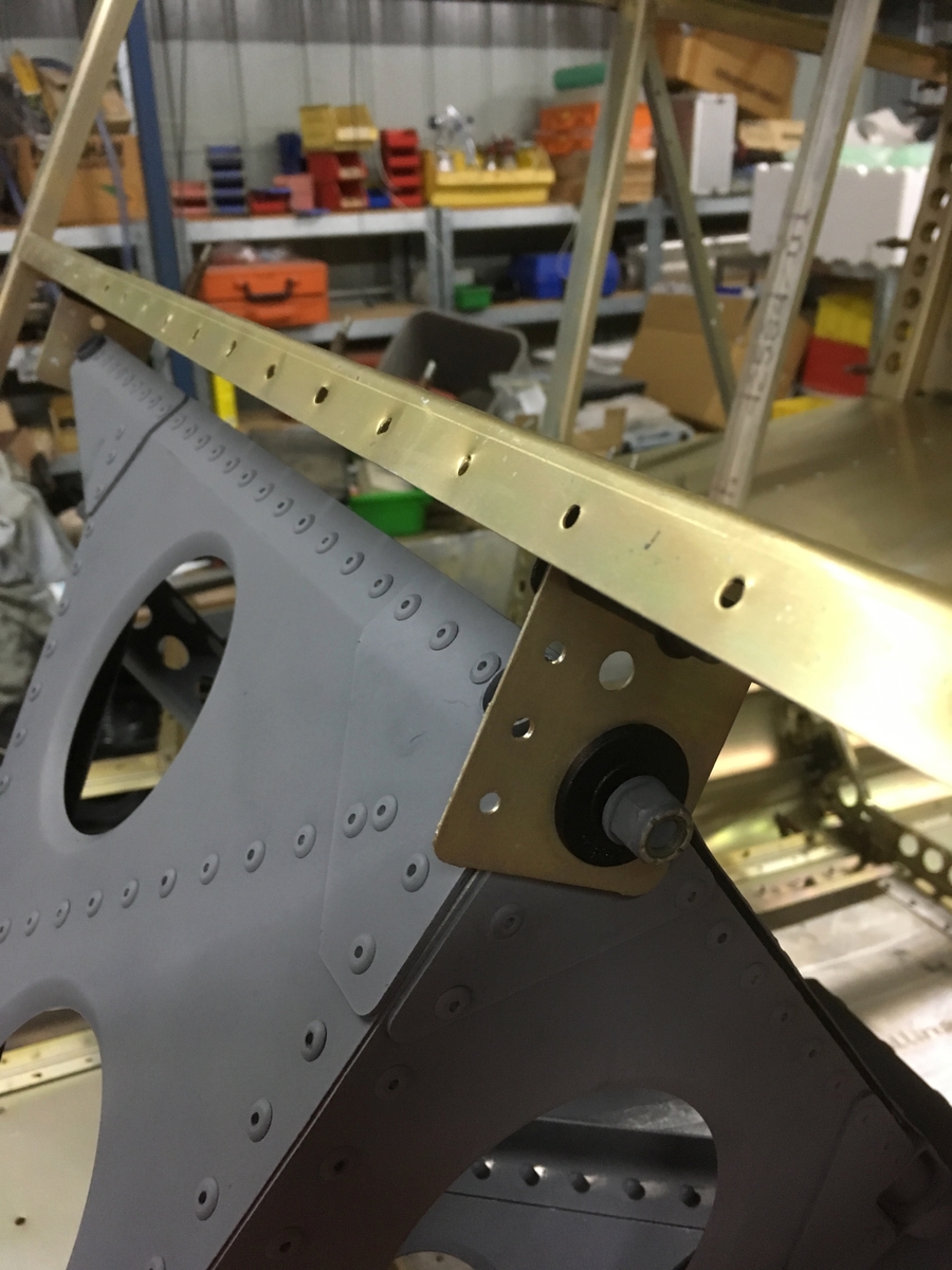

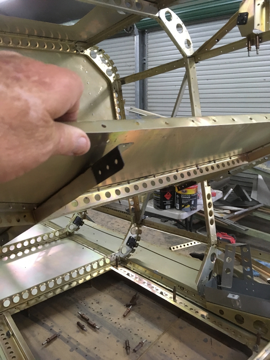

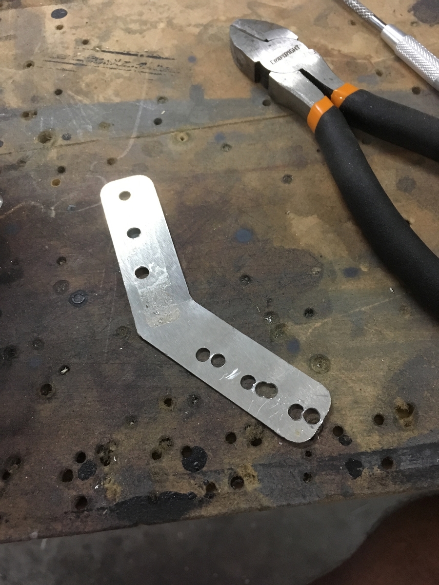

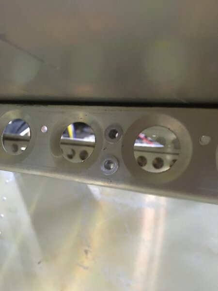

The whole flaperon mixer must have been out of alignment as the picture on the small 120deg angle bracket with the extra holes in it is one of the parts that holds the frame together that sets the pivots for the flaperon mixer. This is part of the extended baggage area. Mind you there are probably 30 or 50 brackets and places on this aircraft where parts have been drilled to make it fit. The amount of new brackets I have made is just ridiculous, luckily I have the alu sheet sizes on hand here and machinery at work to do it and a good mate Danny Leach that I rely on as well to help get over these humps. Danny also has the same issues as his he is rebuilding was put together by the same people so basically we each discover the same issues. I have included a picture of how they did the overlap and its wrong

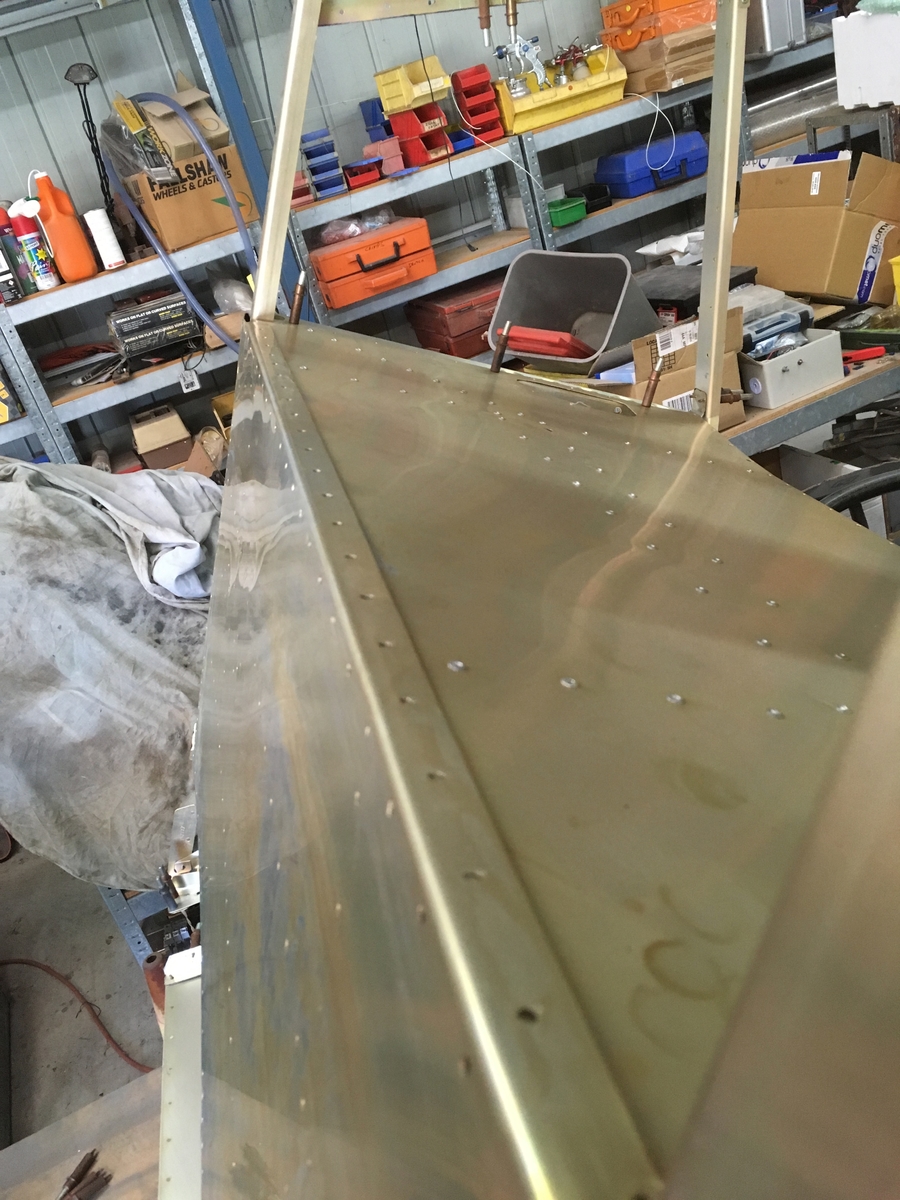

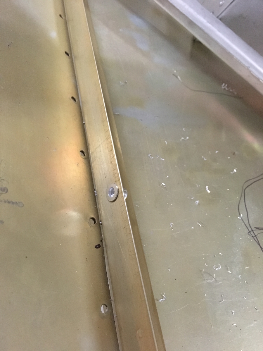

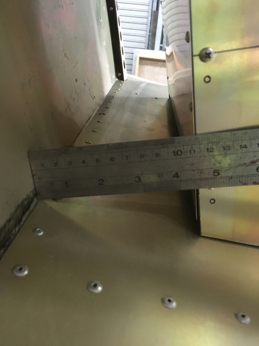

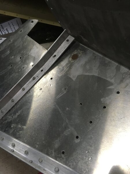

The seat back sheet was riveted over the top of the forward floor of the baggage area...it is supposed to go under so I have a complete row of redrilled holes in the forward baggage area sheet where it connects to the seat back. This would also have set the angle wrong as the pivot point for the flaperon mixer is fixed by rails to that seat back so they would have not been at the right height either.
I was going to make a new one but I will just bend up a new cover strip at the correct angle and just fit it through the original holes and that will cover them all up

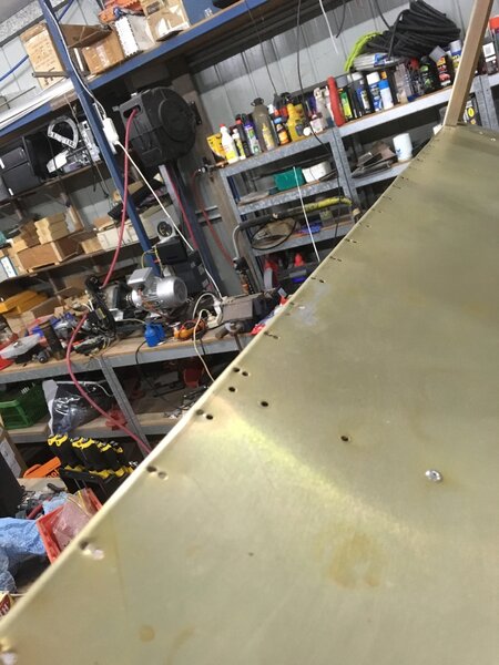

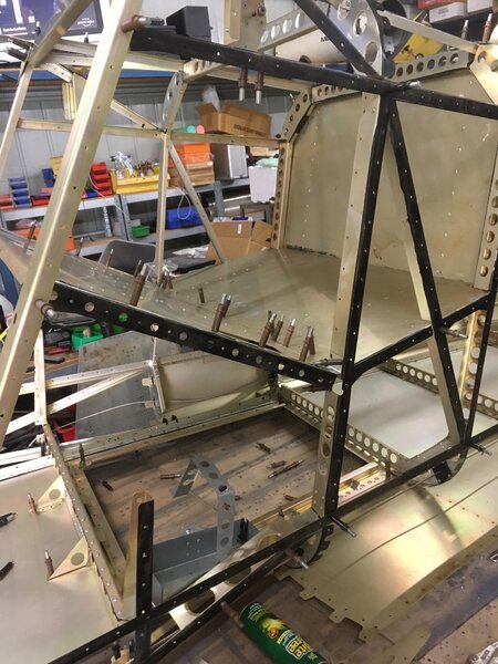

I have been cleaning the paint off the 2 cabin side sections and also preparing to replace the small vertical angle alu that was bent so will be doing some solid riviting later this week.
Its a big job to pull apart the flaperon mixer to alodine it so I have cleaned it all up and then used Prekote on it and have etch primed it so thats how it will stay. I didnt want to acid any of it as it has too many overlaps and I couldnt be sure about cleaning the acid out completely

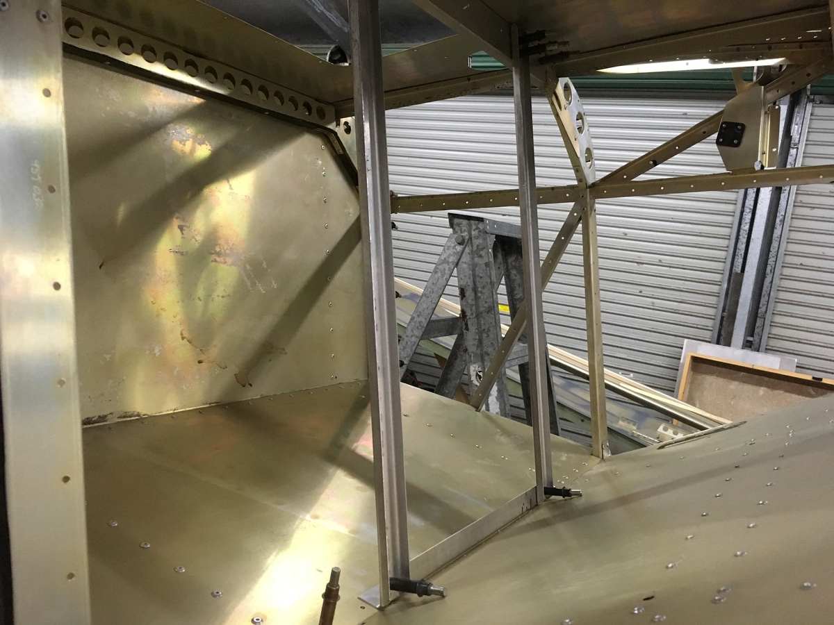

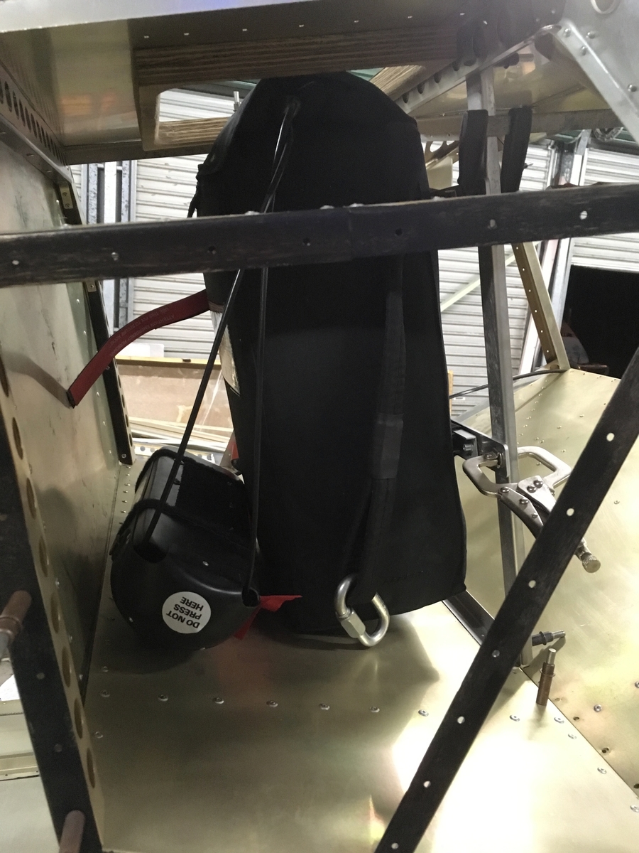

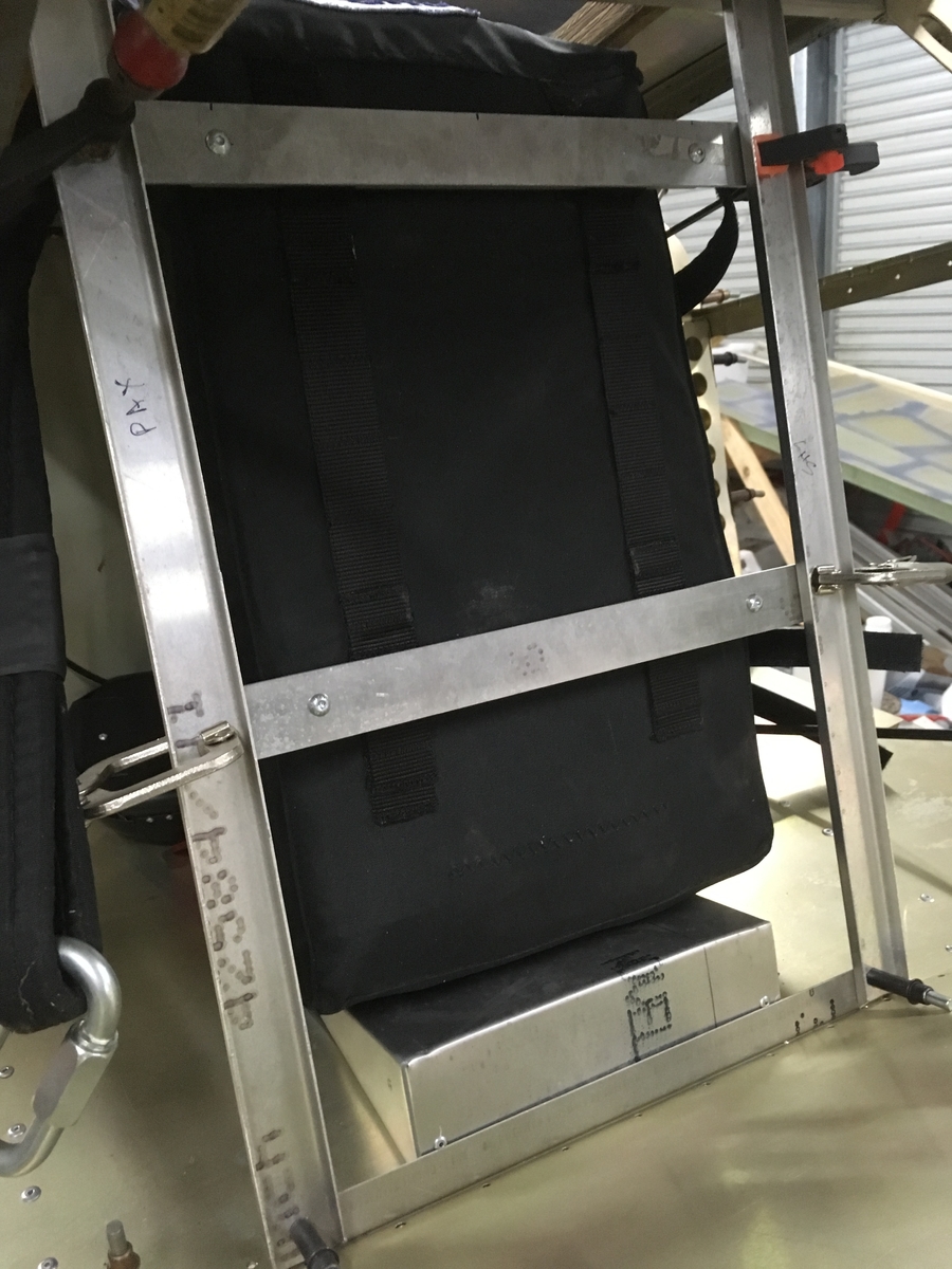

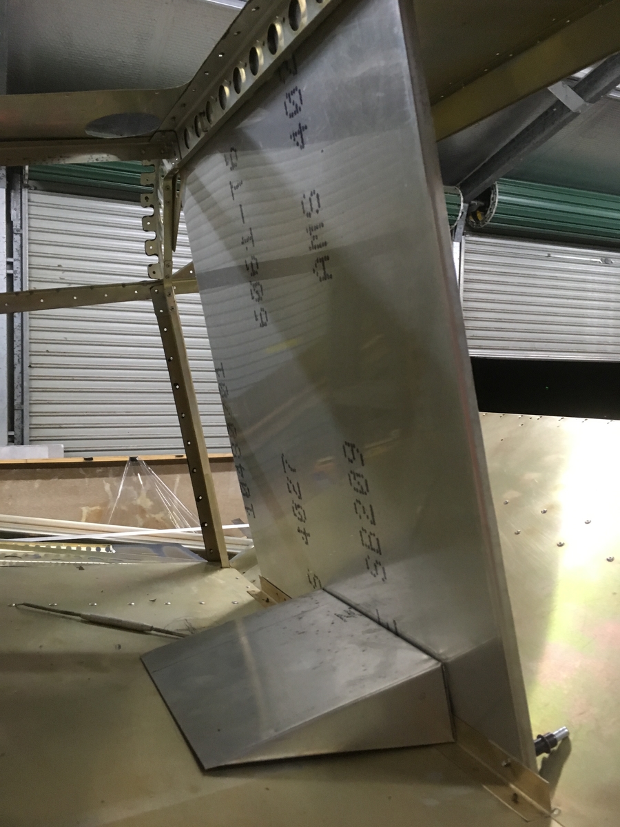

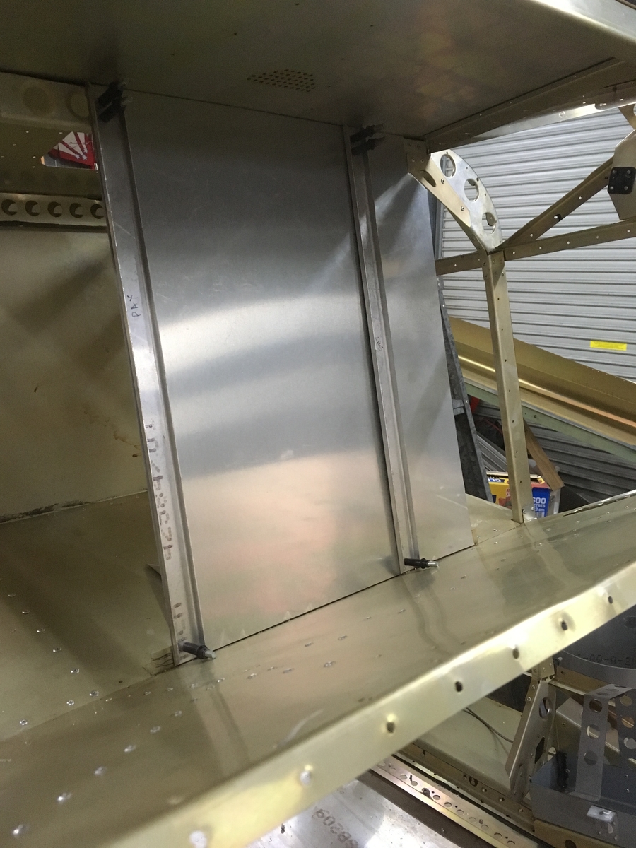

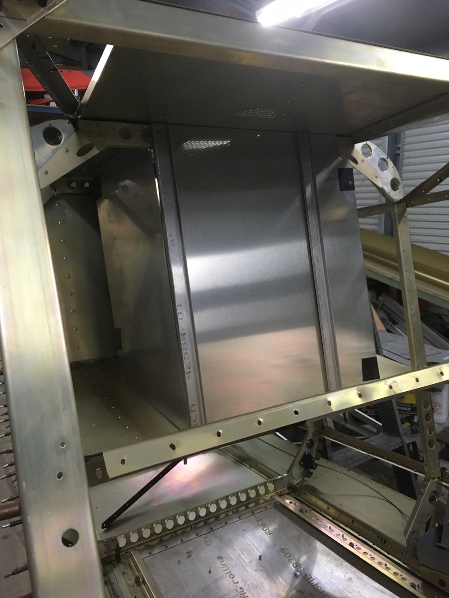

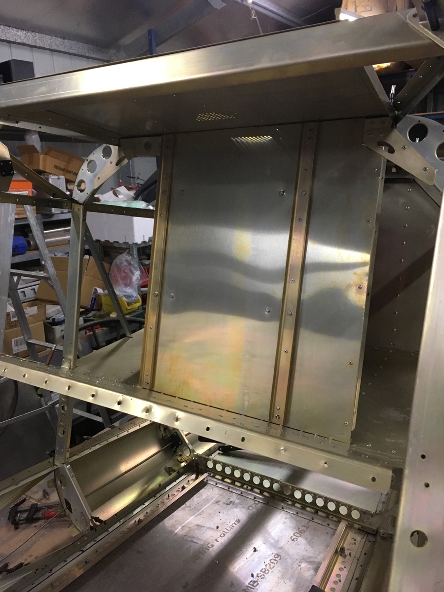

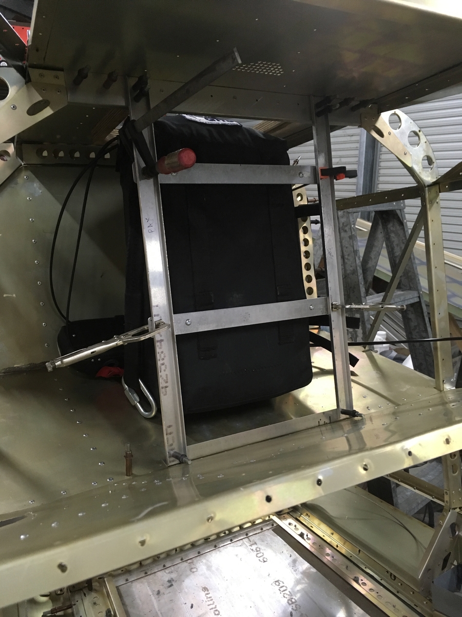

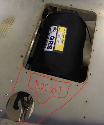

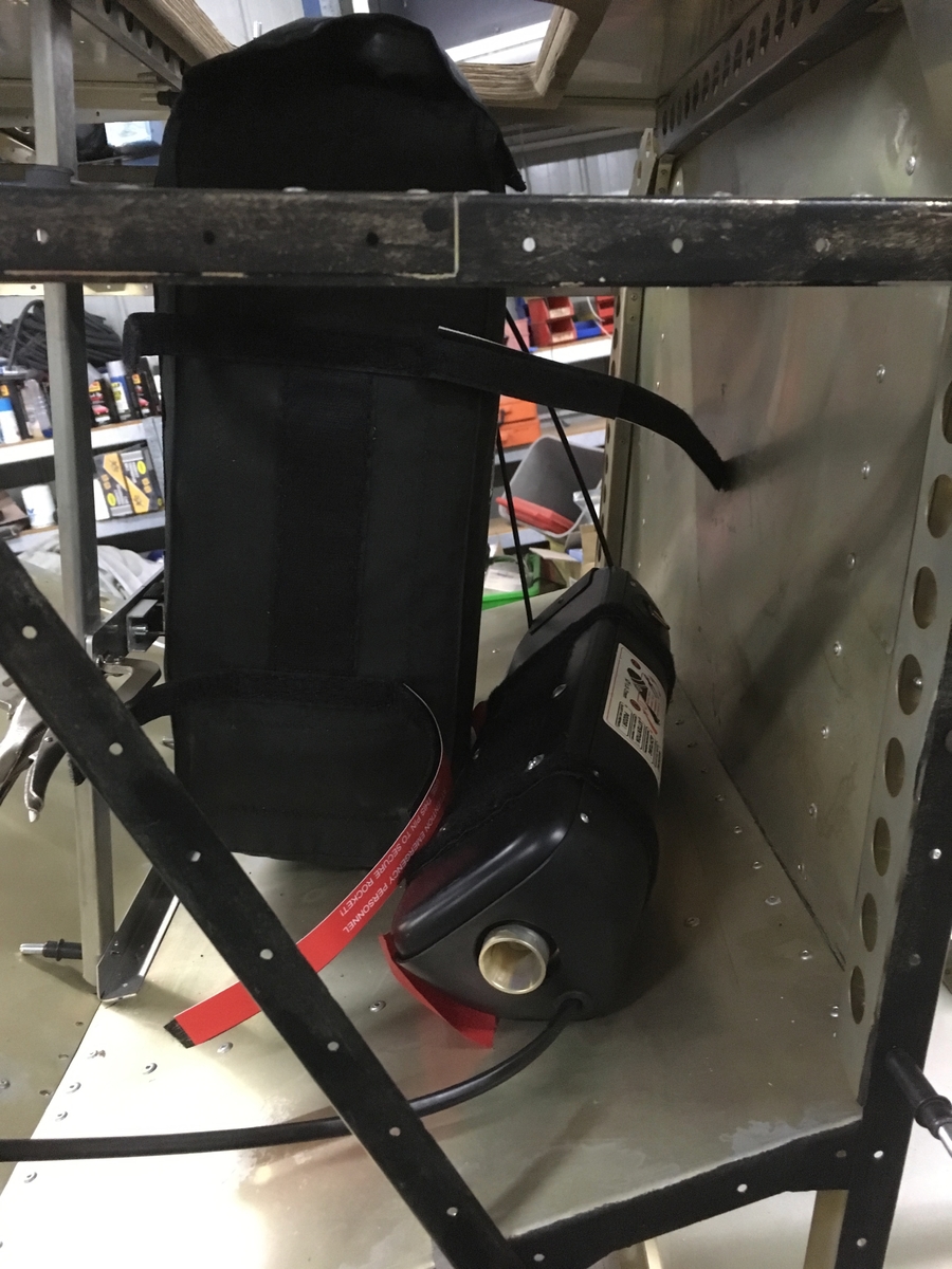

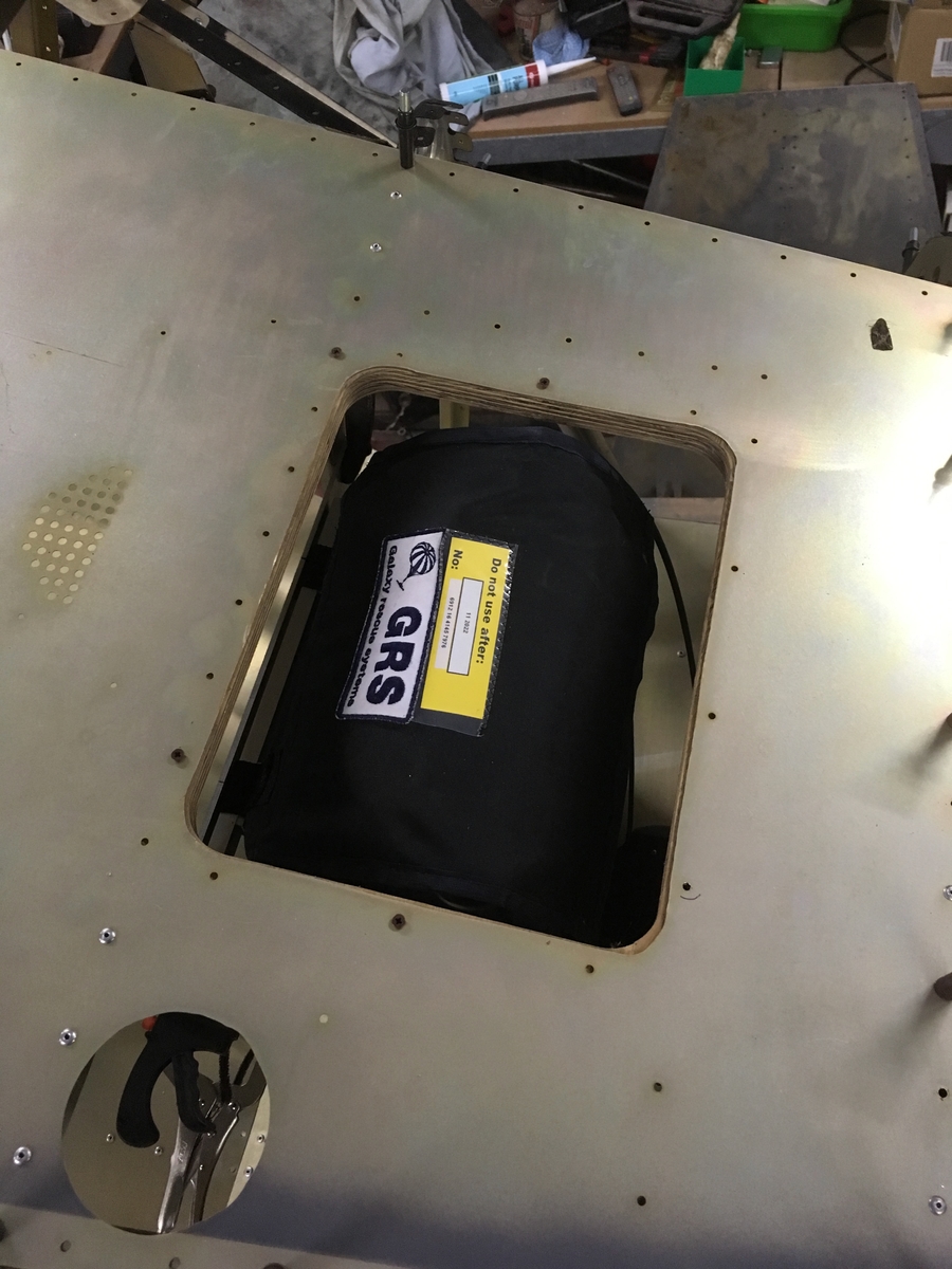

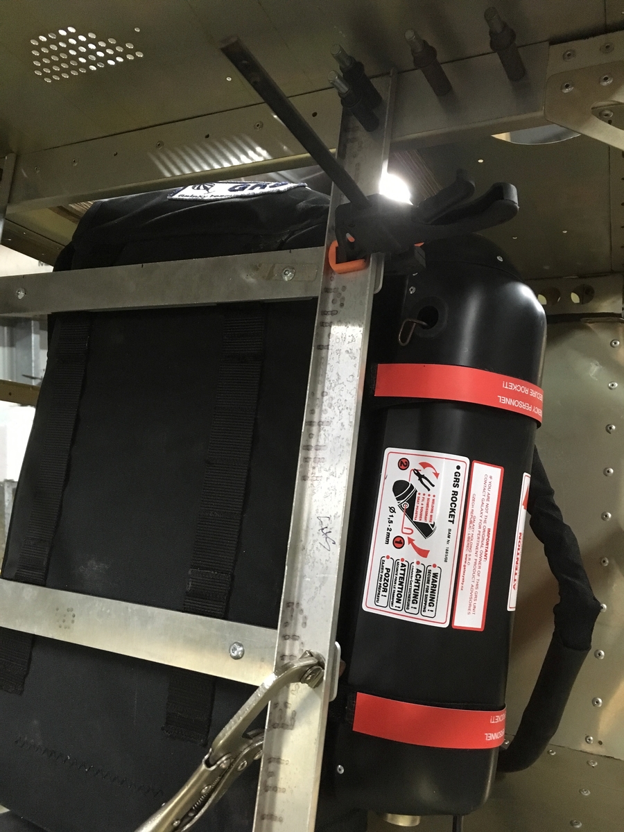

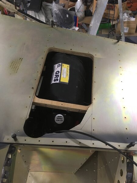

The big project at the moment is to fit the ballistic parachute into the baggage area. The chute is 13kg so is a bit of weight. There are 2 vertical rails that the chute package will bolt to but to share the load over the area I have made another 25 thou right angle and riveted it to the original V bent strip that connected the rear half ot the front half of the baggage area. The 2 rails are attached to the top cross member which I will fit a custom alu cover strip to rivet into this to make that top rail stronger as well. The chute and the rocket will have a 25thou sheet box made around it so that if it is ever deployed then the exhaust from the rocket will be kept contained inside and will go out the top with the chute. If it sounds complicated it not..a couple of pics when I get it done will show. This really all needs to be done now while I have reasonable access to this area. Then after its all painted and getting fitted out the chute can go in properly. You will notice a wooden frame at the chute opening. I would like to thank Dennis from Sweden for sending it to me he had a spare :)...its rounded on the inside to make sure the chute doesnt get ripped or caught as it deploys out of the metal roof area.

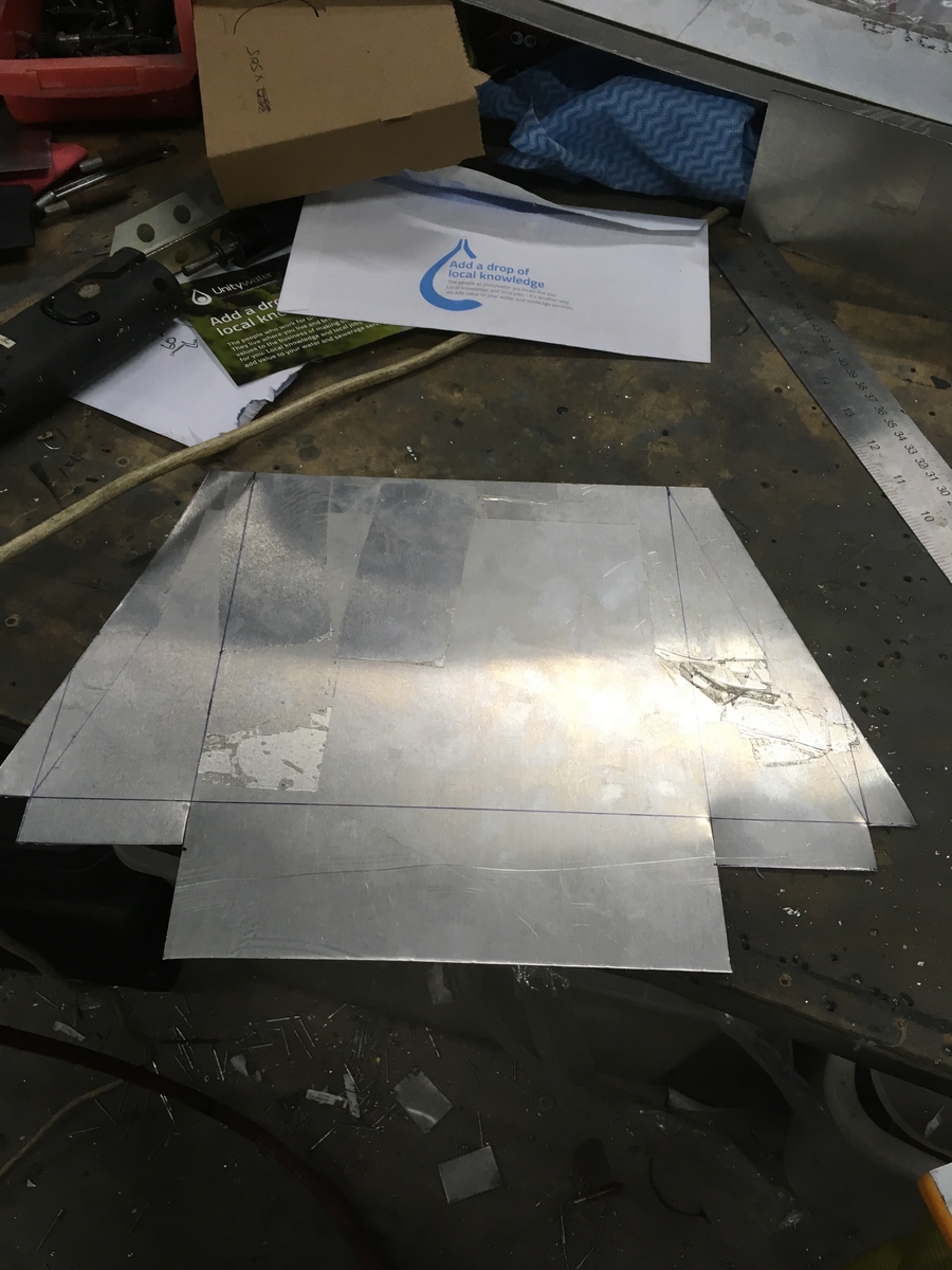

This week also will put a bent edge on the rounded corner sheets for the fuselage this should give a nice edge where they mate with the other 4 flat sheets

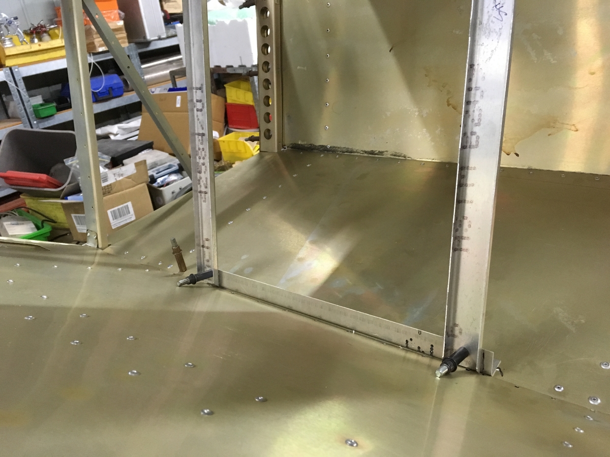

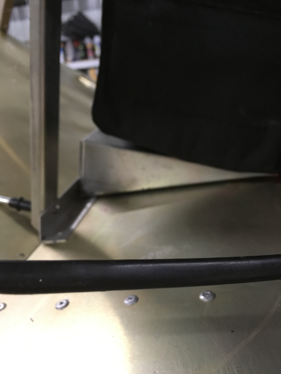

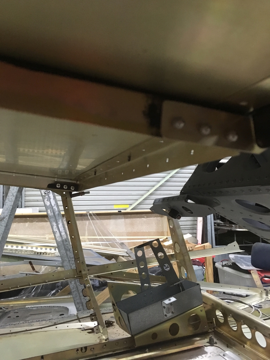

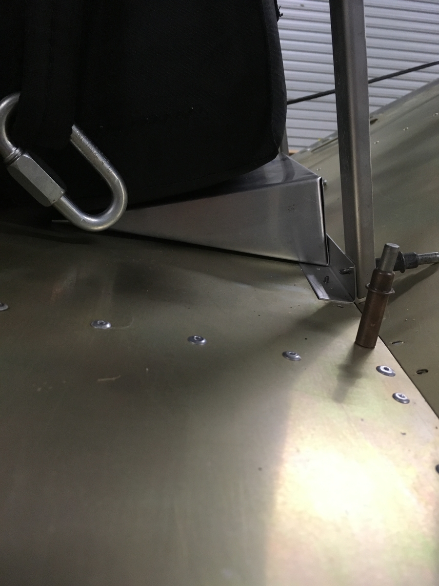

I have a right angle tensioner under the baggage tray at that angle between the front and rear trays then now another piece to help spread the weight of the chute and also to mount the bottom ends of the mounting rails. At the top I have added a 25 thou front plate to the overhead frame this allows more meat to both the rails to and also because its full width and riveted to the frame this also helps spread the load
Very interesting Mark.  It seems like the chute will take quite a bit of space from the baggage compartment, even an extended one. However, I think it is a life saving 'must-have'.  I wonder how much the chute and rocket combination affects the weight and balance?

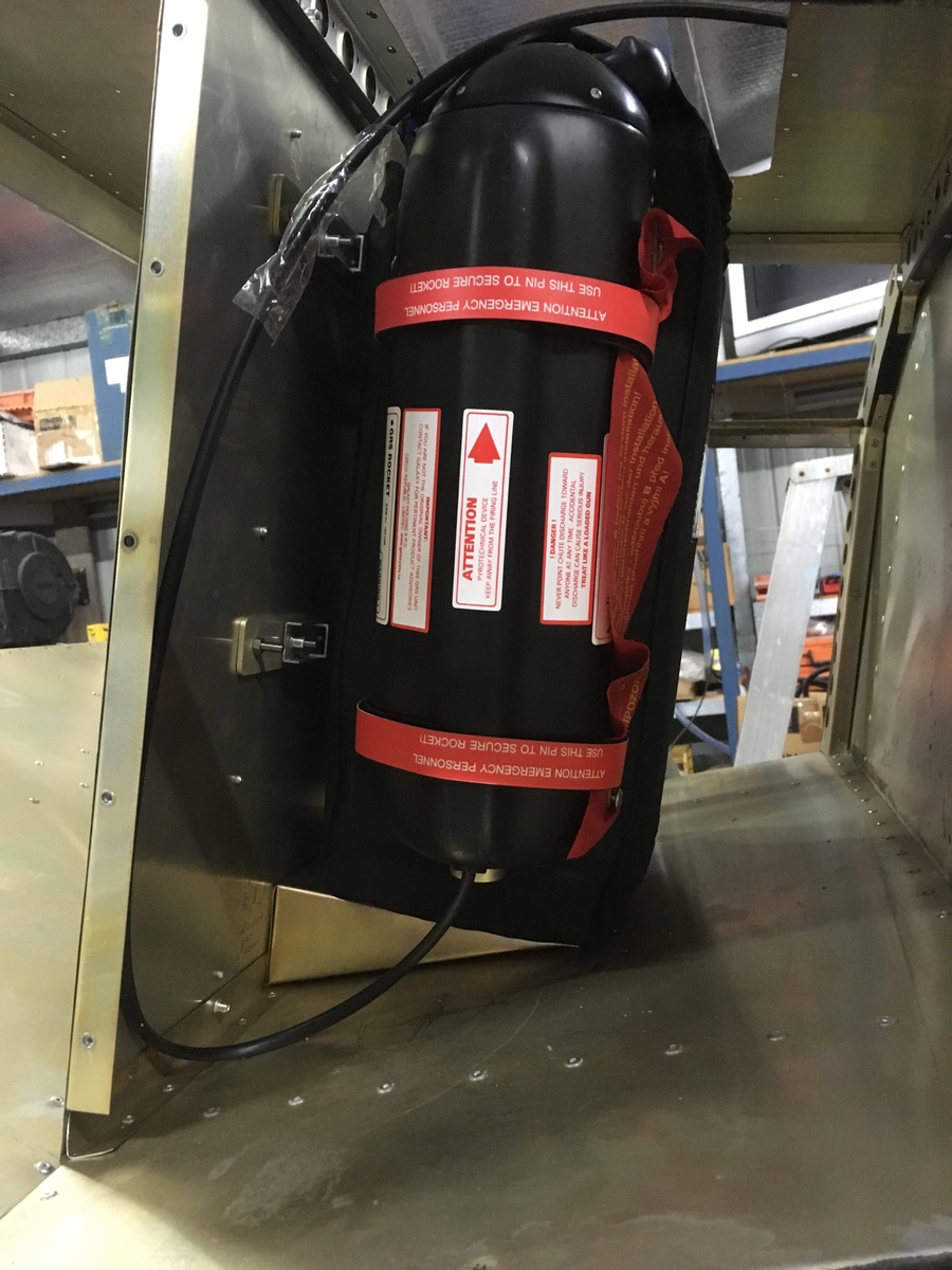

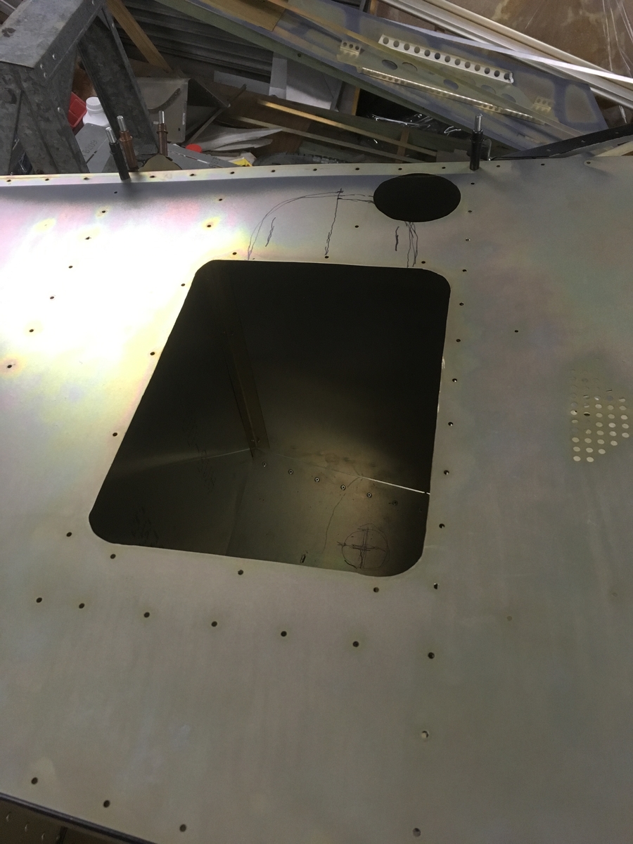

A bit more progress tonight. I have the mounts on the chute and its spaced so it is centred in the eject hole in the top just have to mount the chute horizontal supports to the vertical ones. I have to make a small angled shelf to hold the bottom of the chute where it sits about 6mm off the baggage shelf. I saw this in the ICP paperwork but mine will need to be different. I also now have to make the mount for the rocket so it is nicely centred in its round eject hole as well. Hopefully can get all that done this weekend so I can start on the housing to stop the exhaust of the rocket into the cabin

I have a issue at the moment that I am waiting on a answer from GalaxySky (chute manufacturer). The rocket on mine is velcroed to the softpack and sort of for a multitude of different mountings. The rocket is totally enclosed in a plastic cover with velcro on the back to be put onto the side of the pack. I want to solid mount the rocket using its mount which I can see the screws for on the back of the plastic section but I cant seem to get them out so I can use those to mount the rocket solidly to. So I have asked them if it is ok to remove the plactic as its easy enough its just tiny rivets holding it all tother . This way I can position the rocket where the hole is in the skin on the Sav which is about 120mm away from the chute opening. If they say to leave the rocket on the softpack then I will have to fill the existing hole and make a new one next to the chute opening. I will take some more pics tonight but either way I will need to make a blast cover to stop the gasses coming into the cabin if it gets set off. If I can separate the rocket onto its own mount then I only need a small blast cover around the rocket. If not then I will need to make one that goes around the lot.

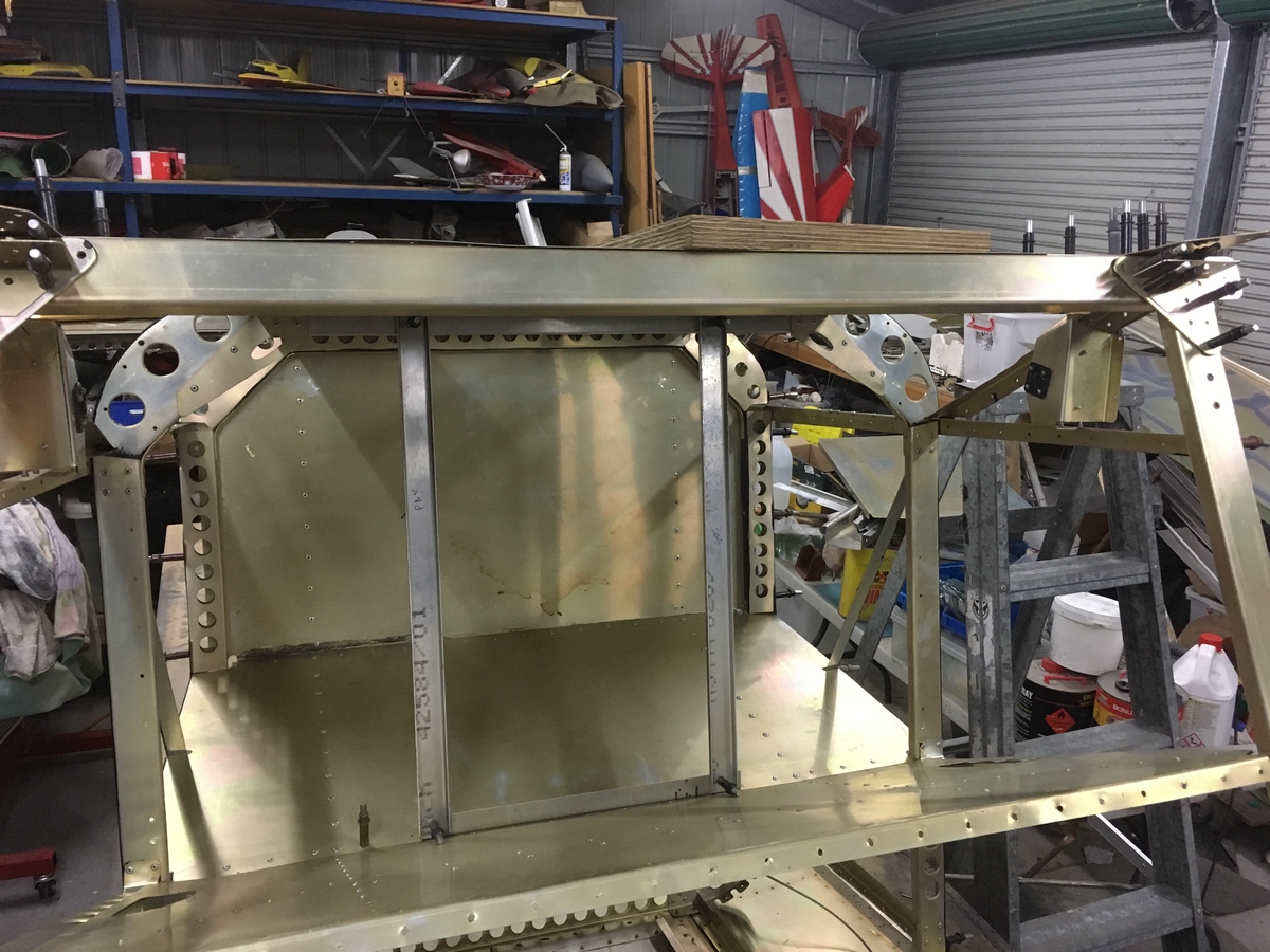

There is still a fair amount of room available even after fitting the chute at least more than 50% of the separate back section of the extended baggage area
I have the L2 coming over wednesday to look at what I have done so far and tell me if its all ok then I can get to the skinning of it all. Hopefully I will get a answer from galaxy tonight so I can get it sorted and Jim can run his eye over it all as well to see he is happy with it as well

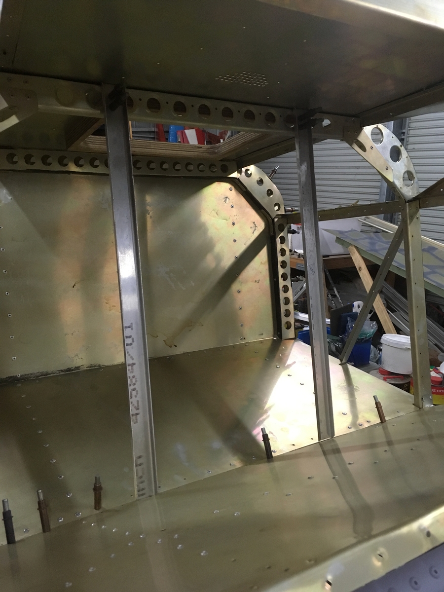

Oh I made the support tray for the bottom of the softpack too on the weekend. Its a little agricultural but is very strong and light its made from 25 thou. The support tray will be riveted to the plate at the front between the 2 verticals and onderneath as well to the baggage shelf. All of these parts have to be removed and alodined yet .I am just waiting until the rocket stuff is sorted

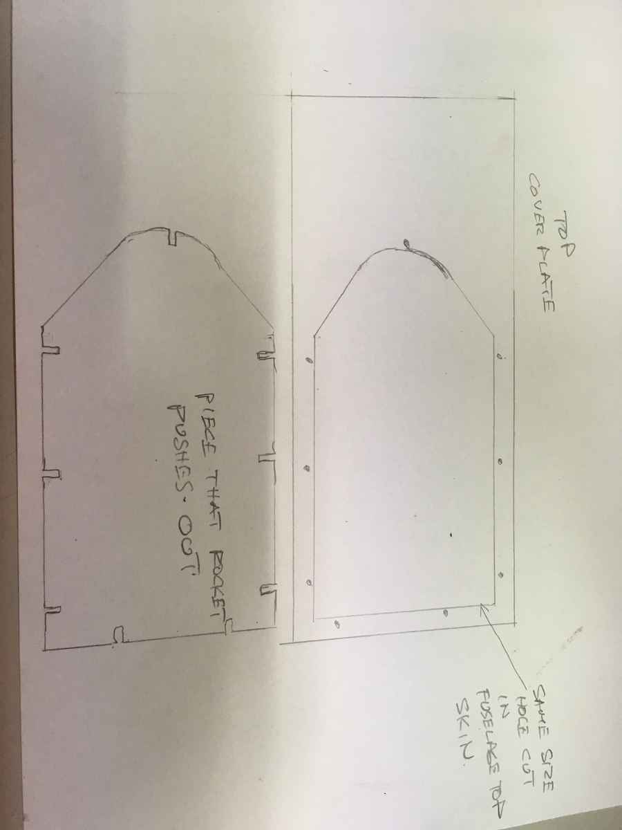

Got my answer back on the chute this afternoon. Looks like the rocket stays on the pack and I do some mods to the top skin, its probably the easiest solution anyway. Also will make a total wrap around for the exhaust gas out of 16tho. Ok now I can start back on work with it.

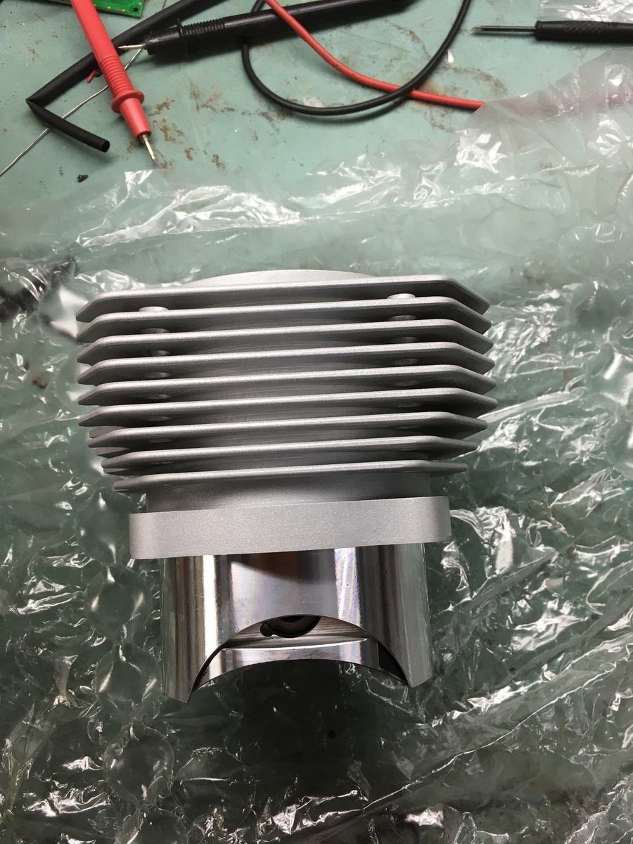

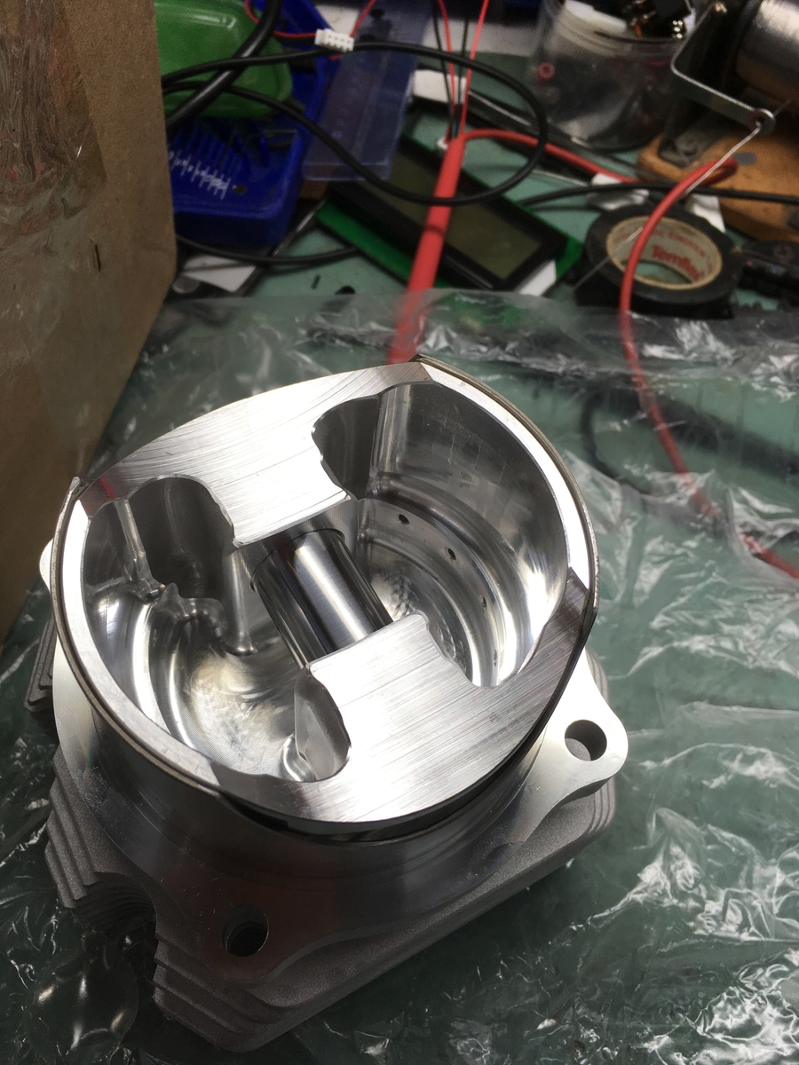

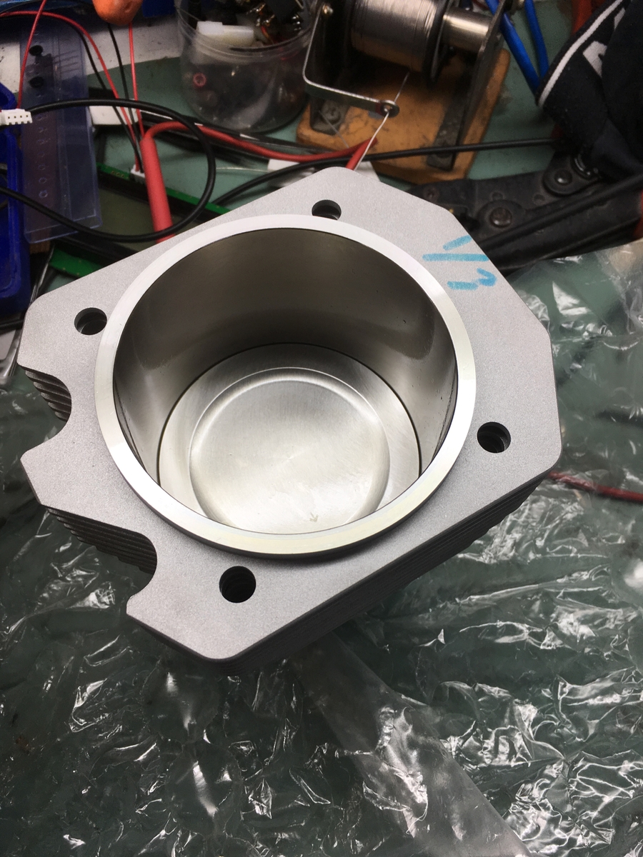

My big bore kit turned up today :)...looks really nice. Will see when it gets done it maybe trialed in Mabel...if it makes a big difference then I might get another one and mod the motor out of Mabel for the S21. Now got to get onto Danny and Jim to get that tuned exhaust finished that fits in the Sav ?

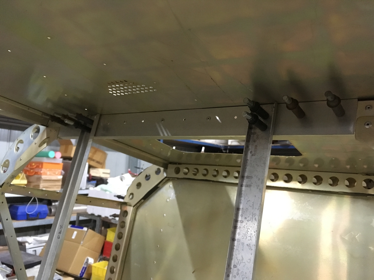

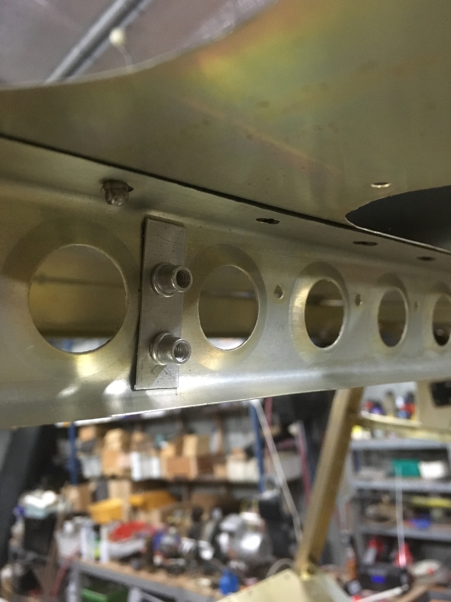

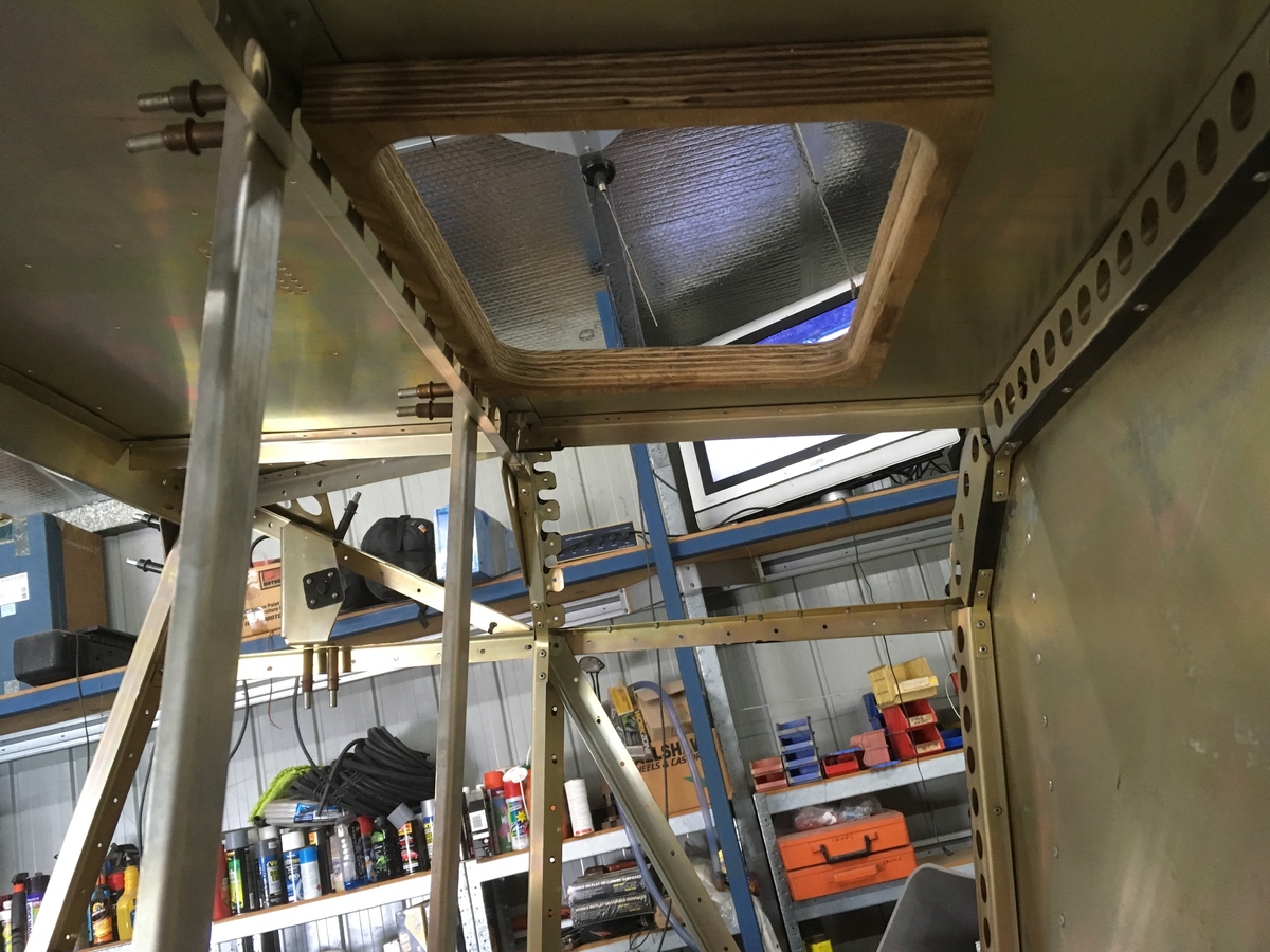

Just been out in the shed looking at how I can do this parachute mod that galaxy has sent me. A bit of modifying and it should be ok. I didnt particularly want to do it this way as I had thought about it but best to tow the line when told by the experts ?
I will have to make a couple of new cover plates and inserts for the pullouts

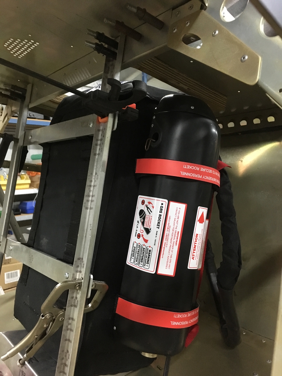

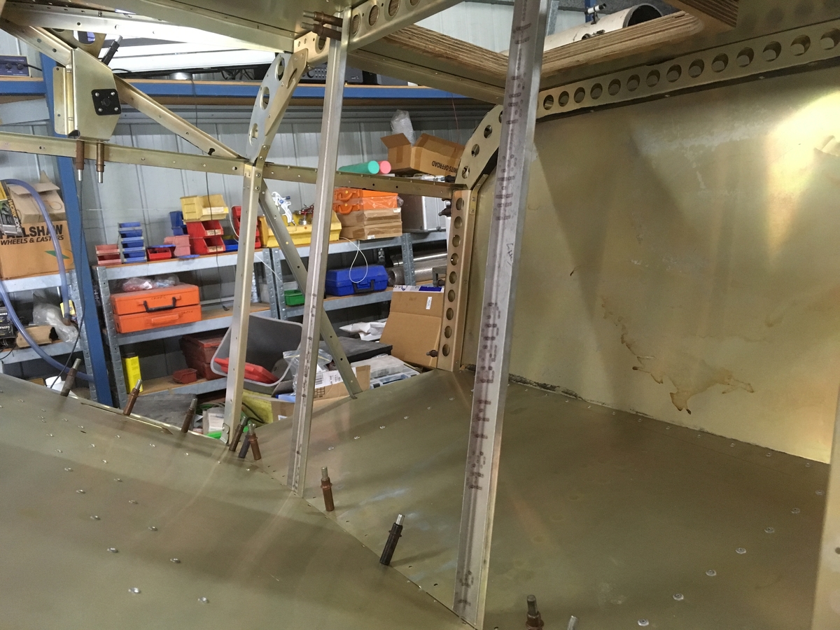

Been slowly getting stuff done on the chute install. I asked GRS about the rocket install and they told me the rocket needs to be attached to the pack so now need to come up with a different cover and exit. They sent me a pic of what it should be like which they have drawn on but I think it is to have one complete cover now instead of a cover for the chute and one for the rocket. I have asked for a clarification but have banked on the answer to be the one cover so I have made a initial setup but will wait until I hear back as I can make it either way at this stage.

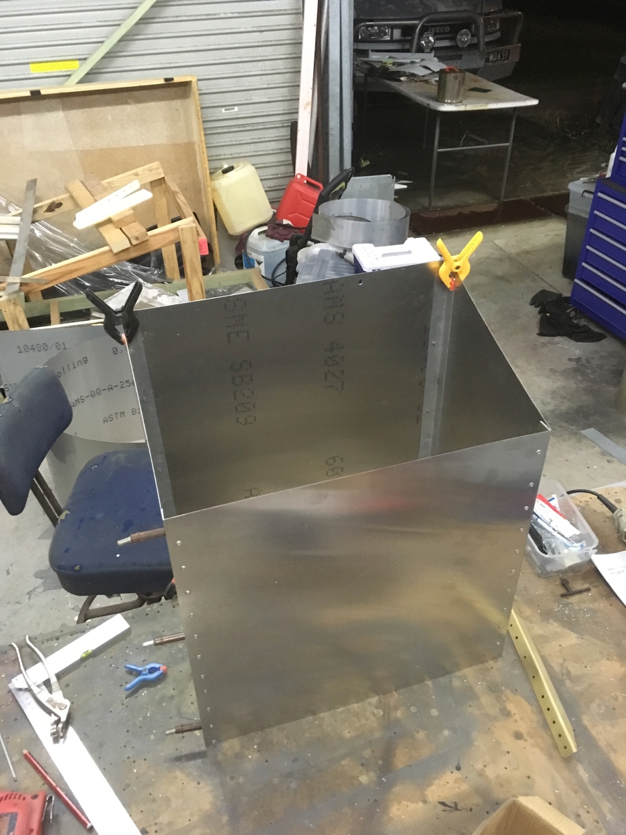

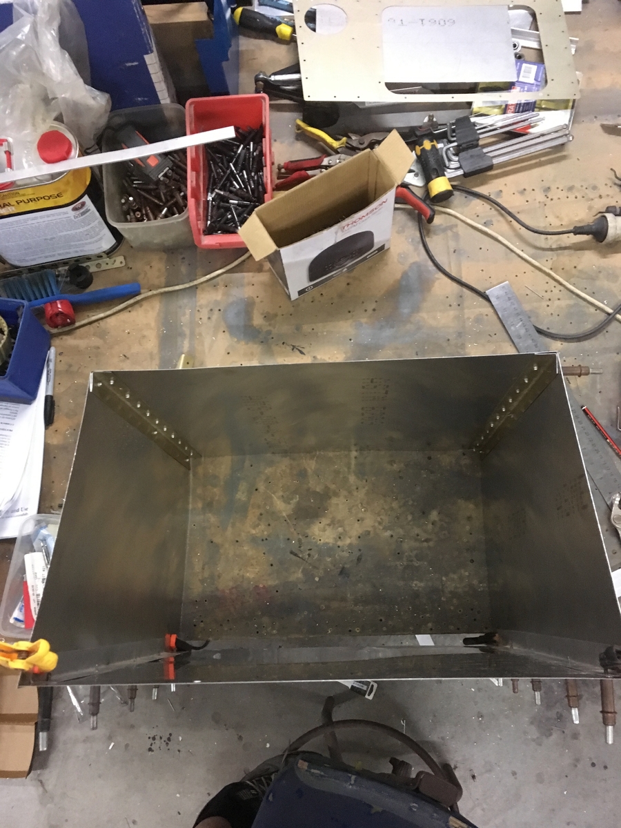

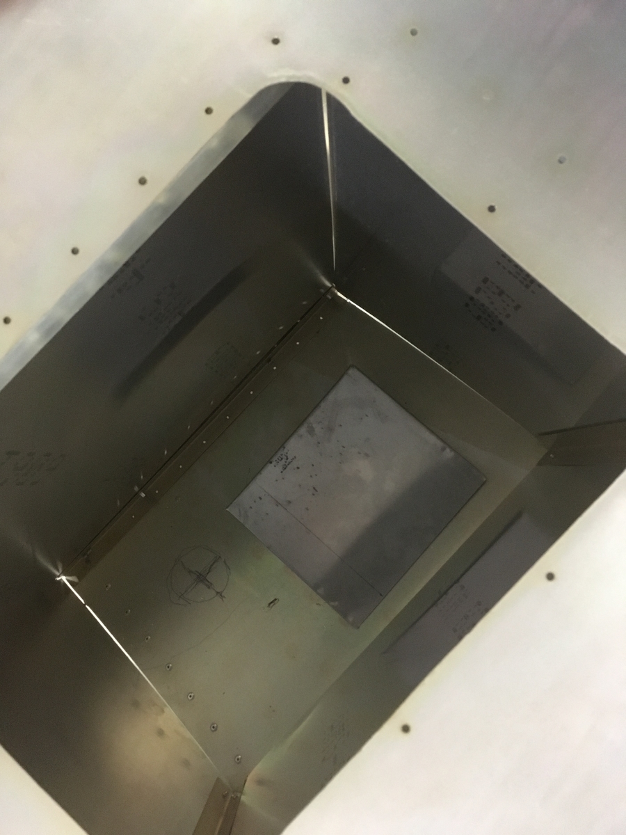

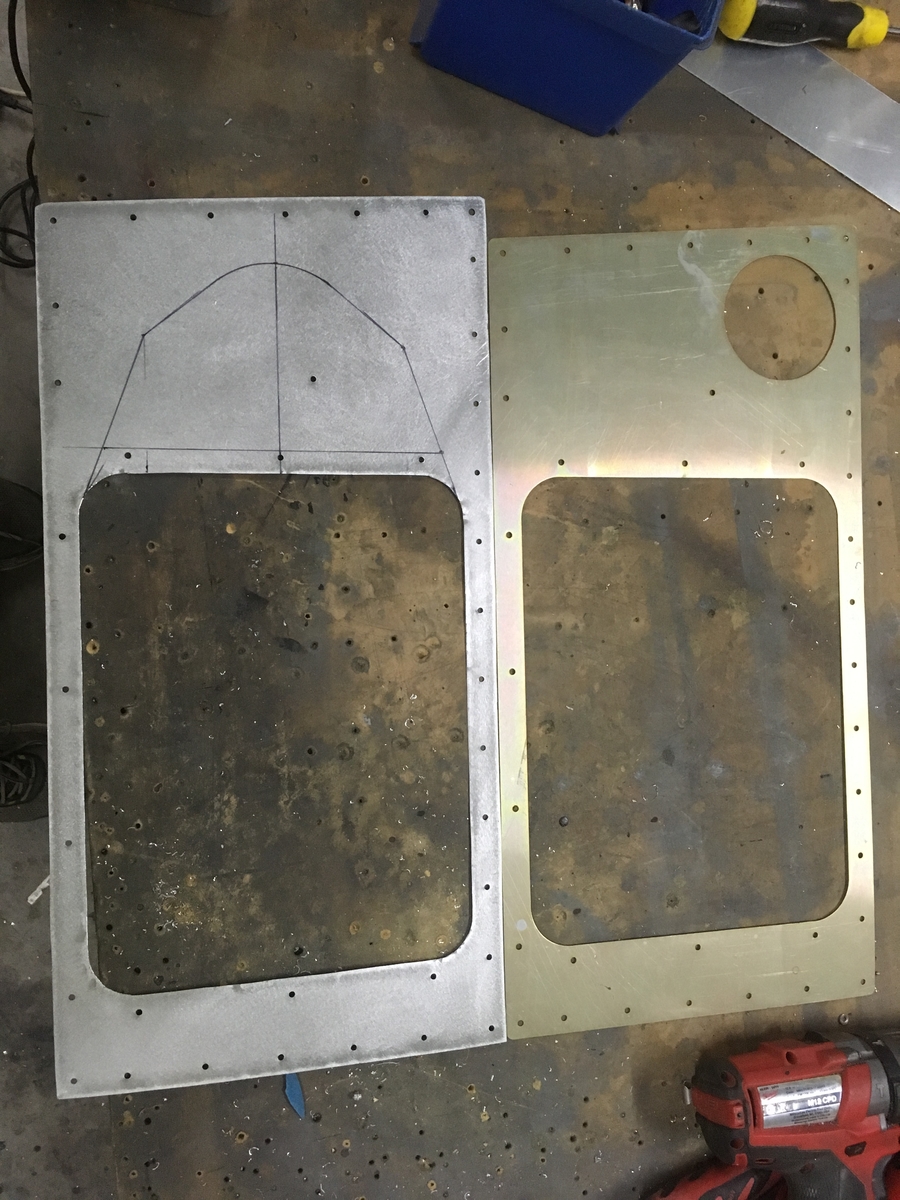

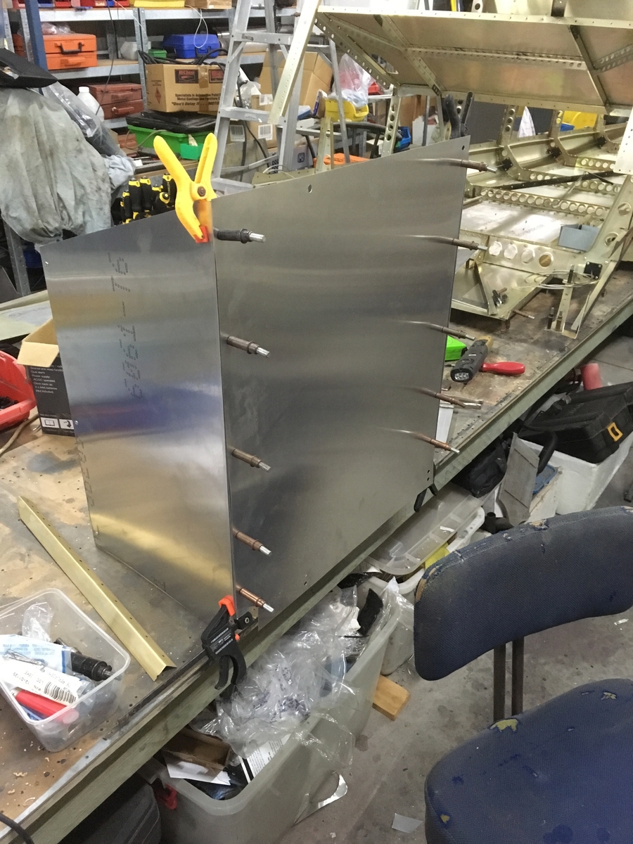

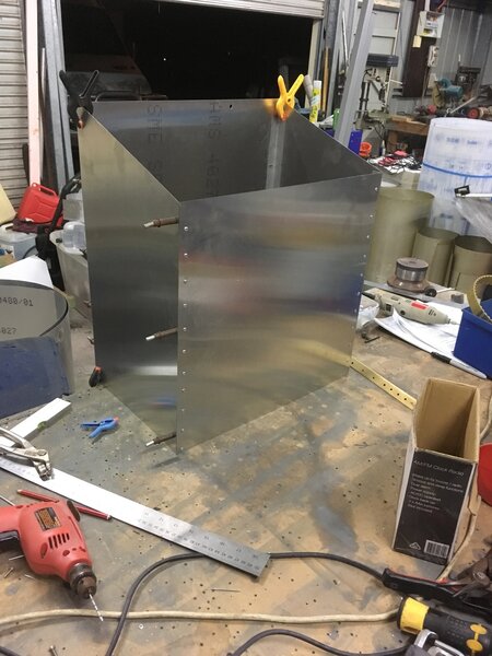

Because the rocket stays on the pack I have to make a total enclosure for the gas..well I dont have to but it would be much safer than a rocket going off behind your ear. I have made the backing now just have to cut and make the rest. Its all out of 16thou so wont weigh much at all. I have put rivnuts in to hold the mounting rails and backing with some strengthening on the top frame for the rivnuts. Some pics to show this
Got the sheet measured and angles done so cut the 16 thou sheet up and have done a trial fit for the chute/rocket blast enclosure. has worked out pretty well. GRS say at least 20mm gap all the way around for containment so there is wiggle room for the chute if deployed. I am using 20 thou strips the same as we made the longerons for the corners of the box and it will have rivnuts on the rear panel and the 2 front ones so I can get the box apart easily if and when the chute needs to be removed. It is all just taped at the moment to make sure it all fits reasonably well and is square. Once all of this is done I can alodine it all and then continue on with putting the front on Mabel. The box is pretty big but I still have usefull room behind it and also on the rocket side so maybe have lost about just over half of the space in the rear section so not too bad

It seems that it still better to have the extended baggage area for more space, even with a chute in place.

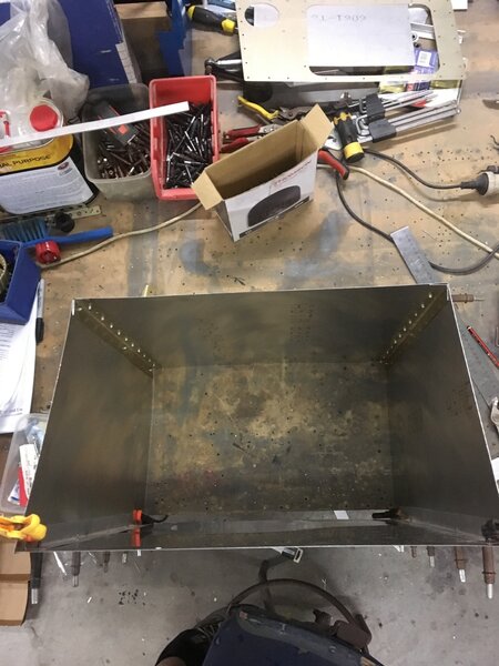

I have finished my blast box and am now finishing off the mounting of it all and the top skin cover plate. Take it all back out then just alodine a few bits and I can get ready to continue on with the build
