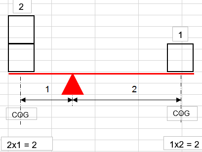

diesel Posted December 13, 2016 Posted December 13, 2016 I draw and keep a simple straight line map of my aircraft. The lever arms for everthing are marked about the datum. The main ones can be constaint or adjusted as per a heavy pax. Weight x arm equals moment Sorry my tablet wont let me lay it out but very simple. If you work out what you can safely carry you are well on the way. With fuel and luggage being the biggest variable. Know what adds to aft c of g. One old addage that kept a lot of pilots alive was when heavy, if you are climbing dont turn. If you are turning dont climb. Chas 1
