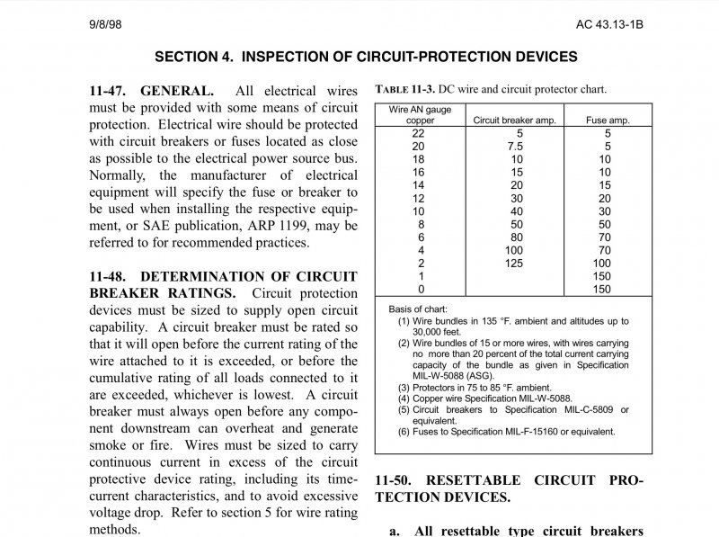

VFR Pilot Posted June 4, 2016 Posted June 4, 2016 I have two cigarette lighter outlets powered by a single wire for charging ipad and phone in flight. How many amps will the system draw, what awg wire size will I need to run them both at the same time?
facthunter Posted June 4, 2016 Posted June 4, 2016 I doubt you will have any problem. The cigarette lighter uses a fair bit of current when used for it's original purpose` They aren't a particularly good socket I find for other purposes as the slightest tug on the lead often opens the circuit. Nev
djpacro Posted June 4, 2016 Posted June 4, 2016 You may find this useful, read the rest of the chapter in that AC too.
Blueadventures Posted June 4, 2016 Posted June 4, 2016 I have two cigarette lighter outlets powered by a single wire for charging ipad and phone in flight. How many amps will the system draw, what awg wire size will I need to run them both at the same time? I fitted one cig socket with 10 amp circuit breaker protection. (Use for phone charger, vac cleaner, tyre air compressor, etc. And I have a two outlet USB fromJay Car ($25-) for my samsung and GoPro or phone. (2.1 amp and 1 amp Usb's) protected by a 5 amp circuit breaker but a 4 or even 3 amp may be better / OK. Cheers Mike 1
