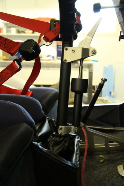

Osteri Posted November 29, 2015 Posted November 29, 2015 I did not like the toe brakes and I made a change in my ICP Bingo 4S VG. I installed one of the original master cylinder and modifying the handbrake

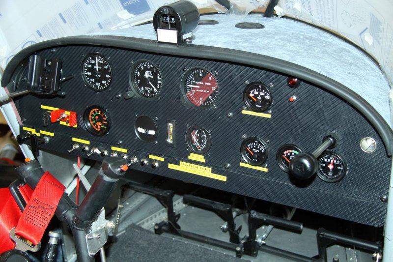

dan tonner Posted December 6, 2015 Posted December 6, 2015 [ATTACH=full]39665[/ATTACH] [ATTACH=full]39666[/ATTACH] Hello Osteri; I'd love to see more details of your handbrake modification and a summary of your level of satisfaction with it. I have a Savannah XLVG and can't quite get comfortable with the toe brakes. In your photo I believe I see a Park Brake built in as part of the mechanism - is this correct? Do you have drawings and details you'd be willing to share? Best regards, fly safely, Canada Dan
Osteri Posted December 6, 2015 Posted December 6, 2015 I like use hand brake. I do not need a differential brakes. Yes, the parking brake is included in the structure. I actually designed it. Can you send your e-mail address to "roste (X) kotinet.com" I'll send you drawnings. I will take more photos.
