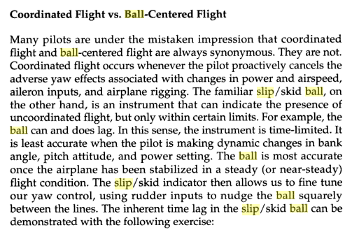

aro Posted November 26, 2015 Posted November 26, 2015 If you incline that lift vector to one side by banking the aircraft, it moves (accelerates) towards the way the lift is tilted. It has commenced a turn because of the applied force. Agree. Therefore, if the nose is stationary on the horizon you must be uncoordinated.

djpacro Posted December 2, 2015 Author Posted December 2, 2015 I had to google to find the context of that extract.I hesitate to nitpick Rich Stowell, BUT he is describing an exercise rolling between 30 degrees bank each way while keeping the nose on a point on the horizon as coordinated flight. Had to wait until I got home to flick through my copy of the book - that extract was a general comment - he then went on to explain how the lag may be demonstrated with that 30 deg bank exercise.
