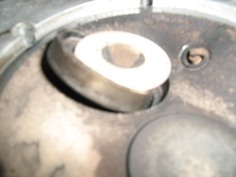

Not what I expected.. the exhaust valve seat had come out and was only held there by the valve. No wonder the compression was zero.
I wonder why it came out. The main force is combustion pressure on the valve face, and this force is keeping the seat in.
There was no other obvious damage, and the engine never runs hot. It was cleaner inside than I thought.
You won't believe me, but I was going to suggest the seat but it's something you notice straight away, when you remove the head. When they are installed the interference is about .005" depending on the diameter. Aluminium expands more than the nickel iron alloy in the seats. If the fit isn't tight enough it falls out and usually jams crooked or breaks into pieces. Some fit them using liquid nitrogen to shrink the seat in aluminium alloy heads to ensure no damage when installing. Maybe it wasn't tight enough or been overheated. Nev
