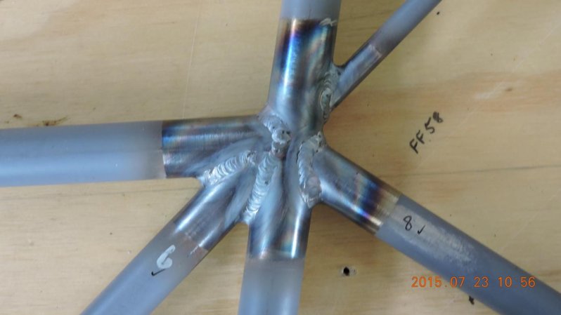

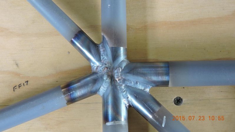

Oscar Posted July 28, 2015 Posted July 28, 2015 HITC, that's really impressive. Your welding is something I admire; having built several race-car tube frame chassis and a number of aircraft-related bits and pieces, the skill required to get a complex set of tubes all welded up without them pulling everything out of feck is not a skill most people will truly appreciate. You - very obviously to me - understand that it's not just fitting but also weld sequence in a multi-tube frame that makes the difference between something that comes out to spec. and something that ends up just not to dimension. Been there... I notice that you intend to incorporate the 'Dafydd Llewellyn' vg ideas in your design. May I - respectfully - suggest that you get in touch with him and discuss the intricacies of those? He lives not all that far away from you. About six months ago, I believe, the chief Test Pilot from the FAA Small Aircraft Directorate flew the Sunbird Seeker, and commented that the stall characteristics were amongst the best he has ever flown. He added that he will be recommending to the FAA Small Aircraft Directorate, that they contact Dafydd Llewellyn to (this is not a verbatim quote) 'seek his assistance to understand how the aerodynamic design works'. Subtext: the application of the vgs to the Sunbird Seeker is sufficiently subtle in design that it's NOT intuitive nor something that one can say: 'oh, I see how that works, no worries'. Sub-subtext: 'none of you smart@rse engineers in the Directorate have the brains to understand how this works'. The Seeker vg installation took many, many months of trial, test flying and changes, to get it right. With the greatest respect to companies such as Stolspeed - who have done great work and provided excellent information for those looking to use vg's to improve their aircraft's flight characteristics - there is NO 'one size fits all' answer - you cannot JUST apply a handful of vg's to your aircraft and it becomes magically transformed. A familiar analogy would be the time in the 70's when 'lowering and wide wheels' was considered to be the 'magical' answer to an ill-handling motor vehicle. Sometimes it worked, other times it made a dog into a vicious dog. Your project is fascinating; there is very obviously a great deal of experience, thought and plain hard yakka involved. It will be extremely interesting to see how it all progresses. 2 2
Head in the clouds Posted July 28, 2015 Author Posted July 28, 2015 Thanks Oscar, kind words indeed. Yes, welding sequence is critical and before that, the sequence of the tacking. Since it's very difficult (read impossible) to keep the frame clamped flat to the bench during the welding out (because you can't get all around the joint without re-positioning the frame frequently) it's important that the tacks hold it mostly flat as the welds are completed, and keeping a weather ear out for the 'ting' of a stressed tack letting go and re-tacking it as necessary. You're right, I should have a chat with Dafydd, he's a very learned and helpful man, if a little taciturn on occasion when dealing with we 'unqualified non-engineers'. Nonetheless he was very helpful in revealing the intricacies of his Airflow Kit mods in the "Do vortex generators really work" thread. Actually, I'm not particularly a fan of VGs and don't have any plan to use them initially, if at all*. I mentioned that I would be incorporating some of Dafydd's methodology and that part is the inboard features, the stall strip and wing fences to act as a power-off stall-limiting device and the consequential vortices that keep the yaw under control. Outboard Dafydd's method uses a drooped leading edge with VGs whereas I will have fixed slots instead. (* - One objection I have to VGs is how much harder it is to clean that part of the wing, and the consequent corrosion that could develop around each of them. I may, however give in and use them but only directly in front of the ailerons where they may help to ensure that part of the wing is the very last to stall, especially if they can be shown to keep that part unstalled even if full aileron is employed when the rest of the wing is stalled. That would ensure that wing-drop will not occur at any stage of a (progressive) stall, and permit use of aileron (though I don't approve personally, I use rudder) to keep the wings level in the stall - all part of fool-proofing the design as much as possible). The fixed slots will give me flow attachment to a higher alpha than VGs ever could and provide a CL Max of around 1.75 (and over 2.1 with slotted flaps deployed as well), also way higher than VGs alone can offer. Using the slot shape described in NACA Report 407 (Weick & Wenzinger) I can avoid the complications of a movable Handley Page style of slat and still have minimal extra drag in the cruise. The only drawback being the extra limitation on Va due to the high CL Max that might be achieved when encountering gusts. That simply means a combination of slightly beefier spars and a lower Va imposed when flying light. ( Those who don't know about Va could read the Manoeuvring speed thread, one explanation is in post #34).

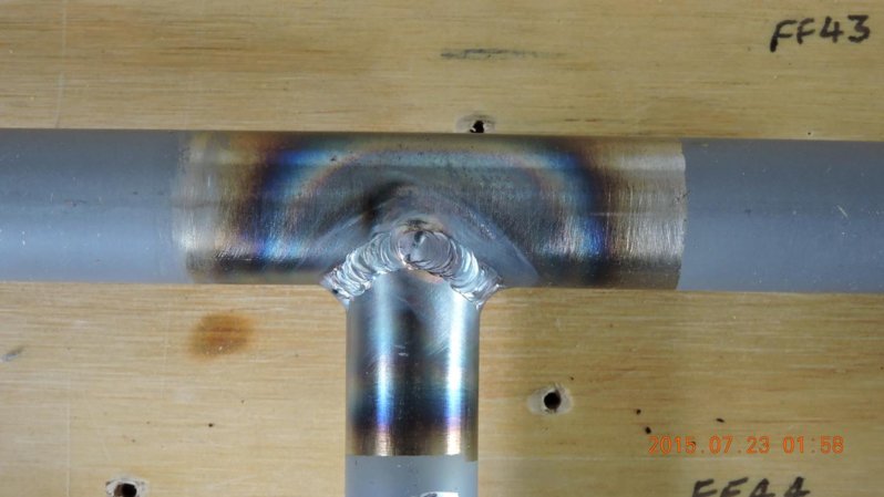

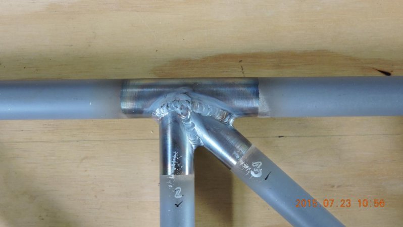

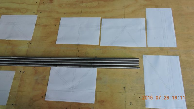

Head in the clouds Posted July 29, 2015 Author Posted July 29, 2015 Last Monday/Tuesday I completed the welding of the second fuselage side and really enjoyed doing it. The welds are getting neater and brighter as I get more practiced again. Once I had the sides done I had to go back to the early part of the next stage so it was all a bit deja vu. Back to the CAD work and produce a dimensioned set-out for the aft fuselage sides, produce full-size templates of all the member junctions, transfer the full-size set-out to the project bench, attach the cluster templates ready for fitting the wood blocking that will hold the tubes in position, produce the CAD wrap templates for the tube member ends, cut the tube members to length and de-scale them in the lathe ready for painting. Then I cut the wood strips up for the blocking. I did have an interesting moment while de-scaling the lengthy longeron members. Necessarily I had a long overhang at both ends and they decided to resonate and had the lathe jumping around the shop floor so I hung a bit of rope over each end with a couple of pounds of lead attached to act as a damper, worked a treat. A bit of graphite dust where the rope was rubbing made sure it didn't get hot from friction and catch alight ... Pics show welds still getting better and the preparation for the aft fuselage sides - 2
Oscar Posted July 29, 2015 Posted July 29, 2015 Jeez, that is NICE welding! You wouldn't get a raised eyebrow, I reckon, if you said it had come out of Barry Manktelow's shop - and Barry is an artist with a tig torch. Well. maybe from Barry himself, but few others would know. Thanks for the heads-up on the 2% Lanthanated tungsten electrodes; I've always used thoriated on steel and was completely unaware of the health aspects. I'll be changing.. haven't done a lot of tig stuff recently ( like, last ten years!) and am a bit rusty; my last job of late was an engine mount for an engine test cell, and though I claim 'extenuating circumstances' because it was done outside and freehand, your welding leaves me mighty jealous. About the only thing good about it, is that a Jab engine plugs straight on, so I got the welds to not pull things out of line. Incidentally - if you are ever looking for a tube notcher (and your stuff says you don't need one..), I bought a JD2 Notchmaster ( https://www.jd2.com/p-63-notchmaster.aspx ) a few years ago, after many years of notching by hand - and it is a REALLY good tool. They are gaggingly expensive by comparison with the el-cheapo pressed-steel ones, but are as solid as a cyclone-rated brick outhouse and correspondingly accurate.. You need to put a chamfer on the cut edge to ensure proper penetration throughout the joins, but with a thin s/s cutting wheel used carefully, ( yes, they should NOT be used for grinding, but hey, they do the job and don't leave bits of carborundum in the join face) the joins come up just a treat. 2

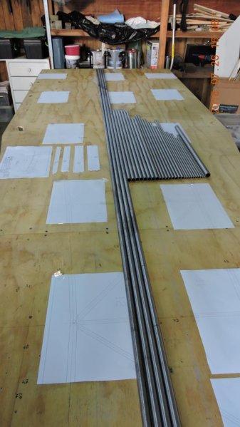

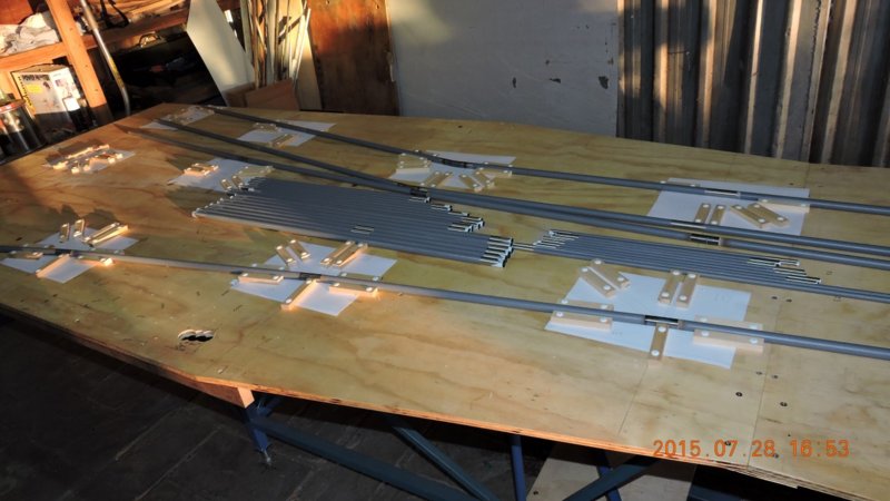

Head in the clouds Posted July 29, 2015 Author Posted July 29, 2015 Slow 'real work' days on Monday and Tuesday gave me time to cut, drill and screw the woodblocks onto the table, positioned along the lines on the paper templates. Then marked and bent the longerons by heating with a propane torch. And used the wrap templates and spray-paint to mark all the tube ends ready for notching - Total hours on the project to this stage is 185hrs 1
