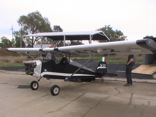

Below is the video of the SuperSTOL performing the 'smack-down landing', for those who may not have seen it.

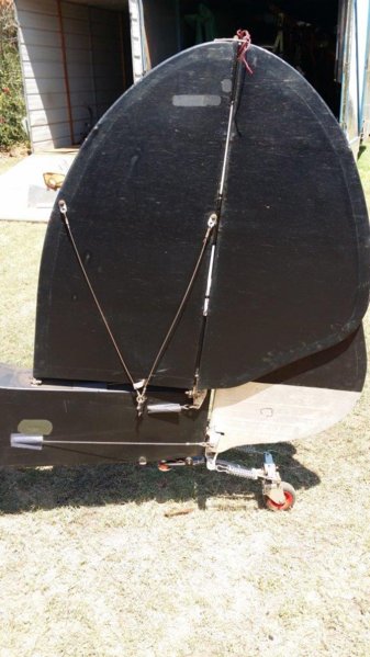

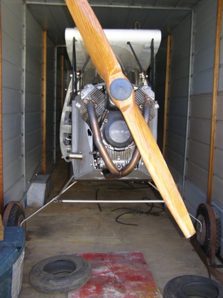

Below are some pictures showing 'The Mistress' and its ingenious folding wings – note that the wings are on the plane in the trailer, folded flat against the fuselage sides.
I was fortunate to have a very experienced aeronautical engineer assist me with the member sizing for the structure and then I 3D modelled it in CAD so that I could produce CNC cutting templates later. Below are some images of the CAD model of the DooMaw.

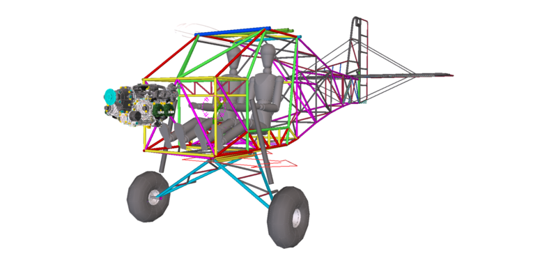

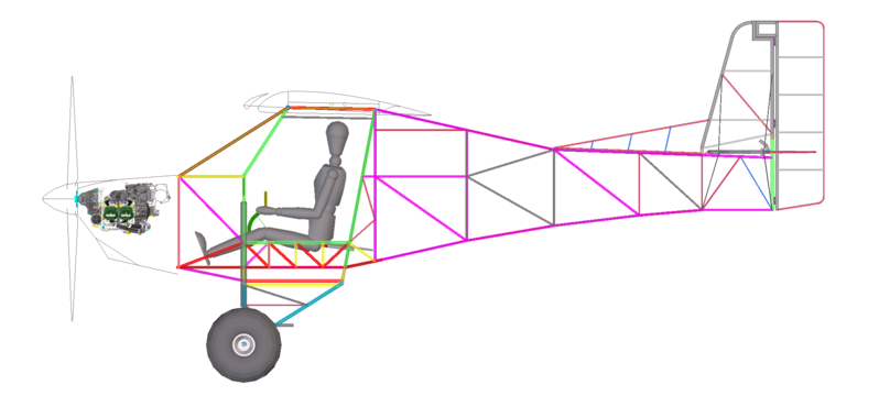

I almost forgot to mention another of the primary design considerations - crashworthiness. Like a lot of others, I'm absolutely appalled at the fatality rate in our sport in recent years and consequently have given crashworthiness a lot of thought.
In my mind there are two main conclusions. A higher proportion of crashes result in fatalities these days, when compared with the proportion of yesteryear because the planes fly (and crash) much faster these days, and in general the modern airframes provide less occupant protection than the earlier ones did.
In the 1980s we used to mainly fly in groups, we kept our planes in trailers and took them to various airfields and paddocks, assembled them and flew all weekend, camping in tents or the trailers overnight. We had lots of crashes, so I don't think the number of crashes per number of flights has increased these days, it's probably reduced. We regularly had to help someone retrieve a damaged plane and load it piece-meal into their trailer. The difference appears to be that those crashes happened at slow speed in strong tubular steel or aluminium airframes so we rarely had an injury, let alone a fatality. These days the crashes happen at high speed in airframes that collapse structurally and offer little or no occupant protection, so they frequently involve fatalities.
With the above in mind, and in any case wanting a tough structure for a rugged bushplane, I am building DooMaw with a welded chromoly tubular steel cage fuselage since they are demonstrably stronger in an impact than other types.
Given that a bushplane does tend to get regular use close to the edges of the envelope and is therefore more likely to be involved in a mishap, I have also incorporated as many as possible of the other crashworthiness features I have come across, some of them were pointed out in discussions we had a while ago on this site.
The intention is to give the occupants as good a chance of survival, and preferably without injury, as if they were involved in a car crash at similar speeds. After all, we don't expect to be injured or killed in a car these days, except in a very major crash, so DooMaw has been designed from the beginning with crashworthiness as a primary consideration.
Bill Whitney kindly provided me with some very helpful documentation which came from the FAR23 certification of the Whitney Boomerang. I've kept all the flail clearances at least as large as were then demonstrated to be necessary, as determined in actual impact with crash test dummies.
There is also a large amount of stroke (empty space) available under the seats without any hard structure for the occupants' spines to hit, that space will be filled with memory foam to provide additional shock protection and progressive deceleration.
The steel fuselage floor structure under the seats is double layered by having the gear mounting truss below the tubular fuselage floor structure, and the forward part of the lower gear structure forms an angle up to the bottom edge of the firewall helping to prevent the firewall digging in and causing a sudden stop in event of a bad arrival. The engine mounting structure continues that angle forward, further improving the 'bounce off and skip along', rather than 'dig in' situation.
The overhead structure between the spar attachment points has crossed bracing rather than a single diagonal brace, helping to prevent the rear spar attach point on one side intruding into the cabin space in event of impact by the wings, going between trees for example, avoiding what has been a fatal flaw in some Cub crashes.
And the very nature of the landing gear provides excellent progressive deceleration, having long-travel pneumatic oleo struts and low pressure, large diameter tundra tyres.

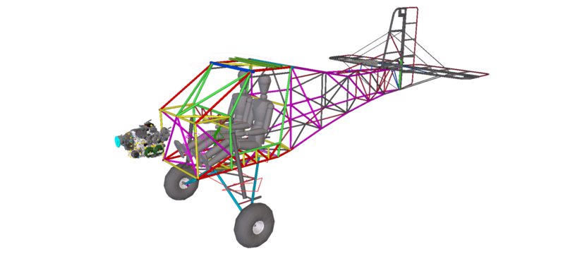

Moving away from crashworthiness and onto the general design aspects - I'm using the BD4/Tailwind style of square windshield/firewall front end purely for simplicity in construction and jigging, and it certainly doesn't seem to disadvantage the performance or handling of those particular designs. That shape also provides more foot and leg-room which has allowed me to reduce the overall fuselage width to just 36"/915mm and the extra shoulder room that will be needed as a result will be provided by bubble doors which enhance downward visibility, an advantage for a plane designed for ground-related activities.

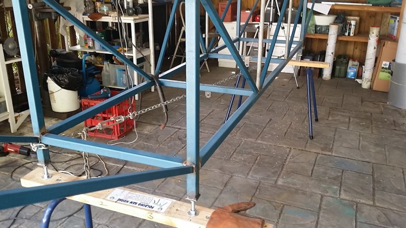

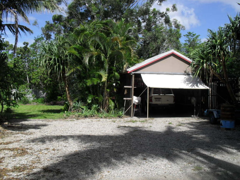

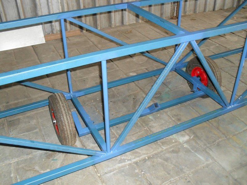

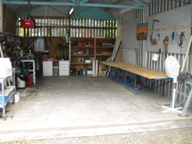

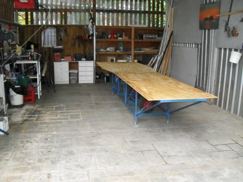

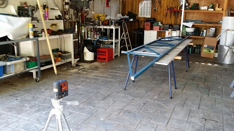

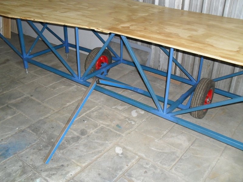

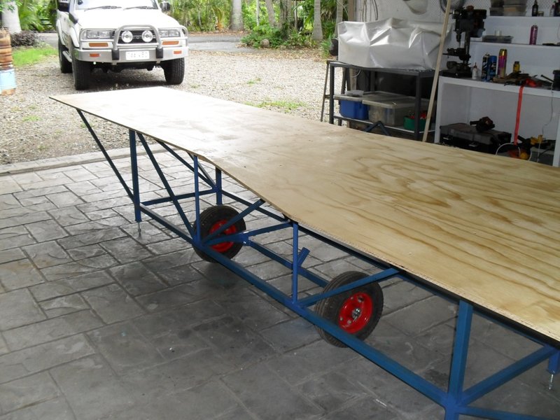

Onto the actual build – last year we moved home to a nice old elevated Queenslander half-way between the Gold Coast and Brisbane, with a bit more space than I had previously, and there's plenty of room for storage under the house. There's also parking for two cars under there and my wife's car just fits but unfortunately mine is too high and so has to live in the garage/shed in the garden which I'd hoped to use exclusively for building the plane.
Consequently I needed to be able to pull the car out to work on the plane and that meant building a mobile project bench which would be perfectly flat each time it was in position for working on the build. So the bench became the next design challenge and the first part of the build.

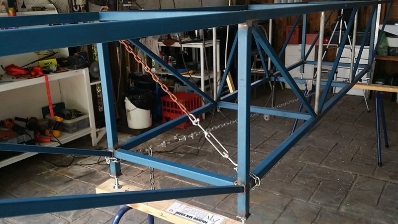

The bench was straightforward but I found I couldn't work in the shop to build it after midday. It was a very hot summer and the sun would stream in the open front door and rapidly took the internal temperature over 40C, so I had to build a roll-up awning first. That made all the difference and it stops any rain blowing in too.

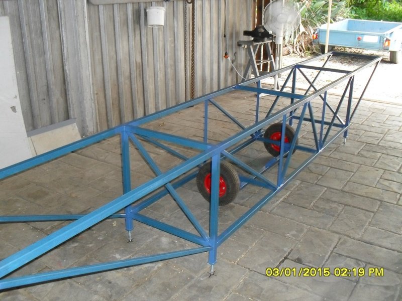

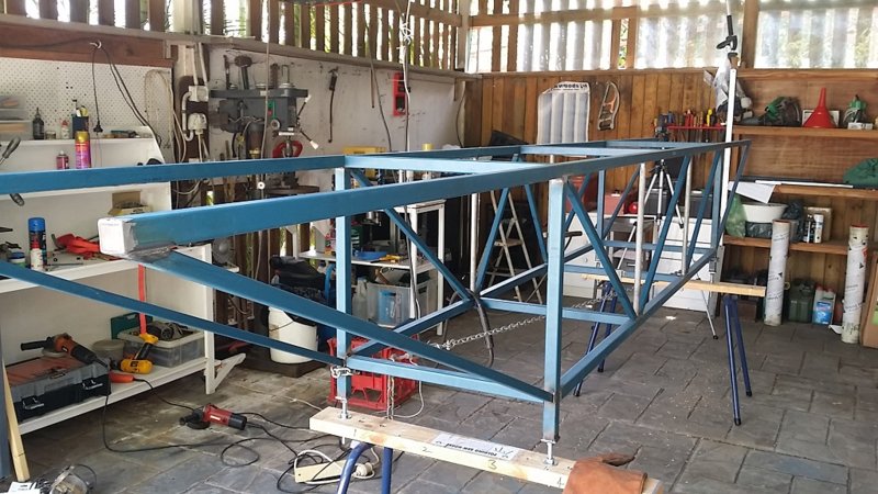

That was in January this year, the pictures below should tell the story, they show -
New home
The shed awning
CAD model of the bench

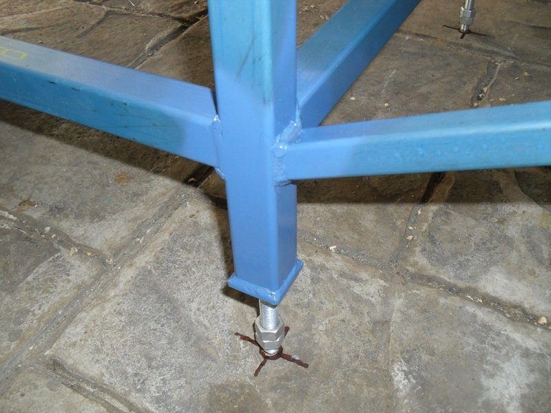

Bench under construction using self-levelling laser and chains with turnbuckles to keep it all straight
Addition of the wheels and lever-lift for moving it about
Adjustable feet to take account of the uneven floor
By placing it on the same marks each time the bench is flat and level to within 1mm over the whole surface

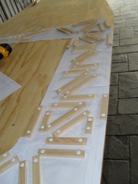

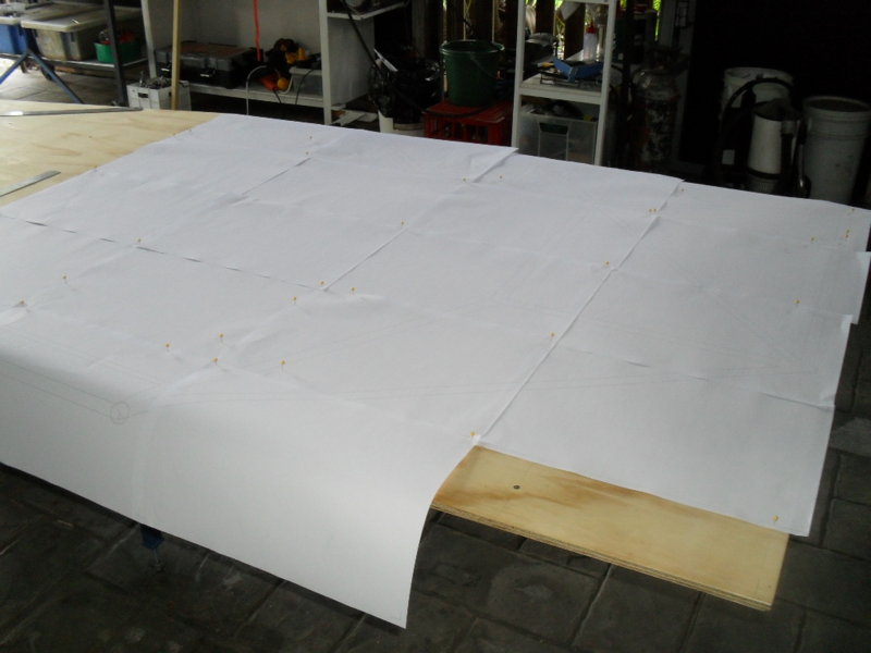

Next I added the bench tops and cut them to shape for the fuselage whether on it's side or upright - the wider end has four outriggers added to the steel structure to support the timber overhang.

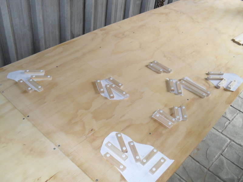

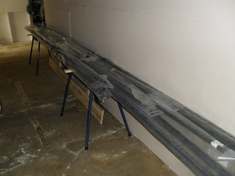

The CRMO tubing all arrived in one tightly wrapped package so I had to cut it open to check the contents against the delivery note. To prevent any rust getting hold of it before I cut it all up I resealed all the different sizes in individual plastic sleeves and stored them under the house.

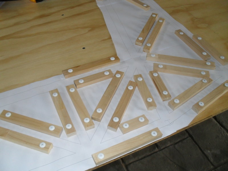

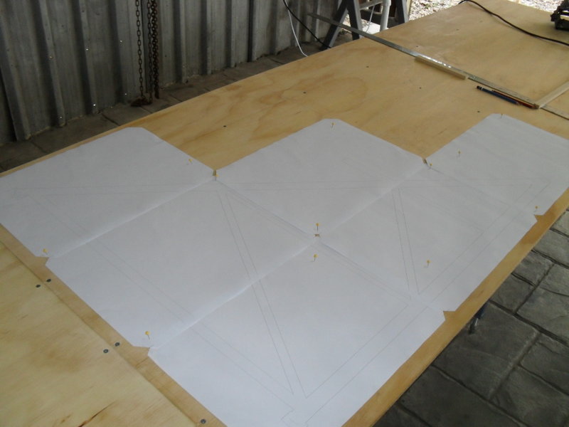

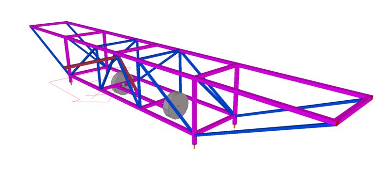

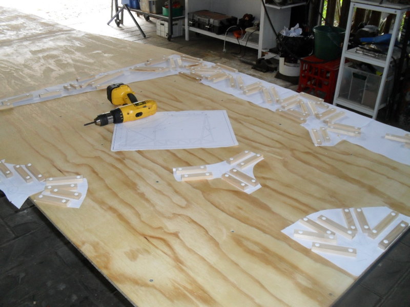

Then it was back to CAD work and produce some printed drawings for the forward fuselage section and main landing gear legs so that I could lay them out on a grid on the bench and install wooden blocking to hold all the members in position for tack welding.
More pics show -
Adding the bench-tops
The CRMO tubing in plastic sleeves
Printed drawings laid out for positioning the blocking
The blocking added and paper stripped away.

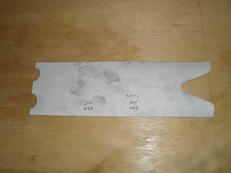

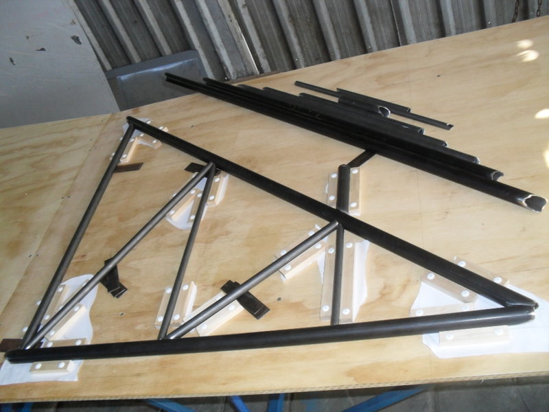

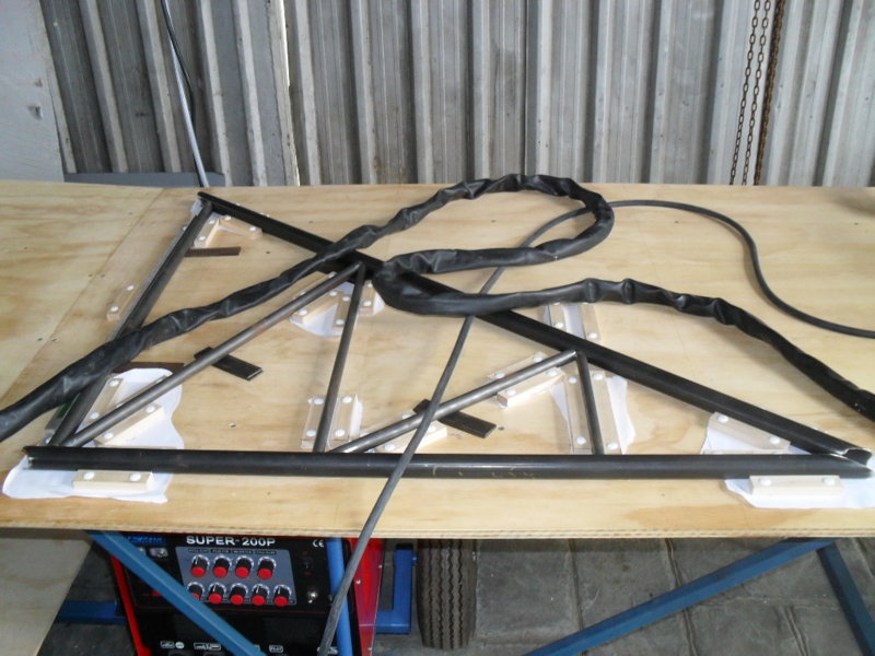

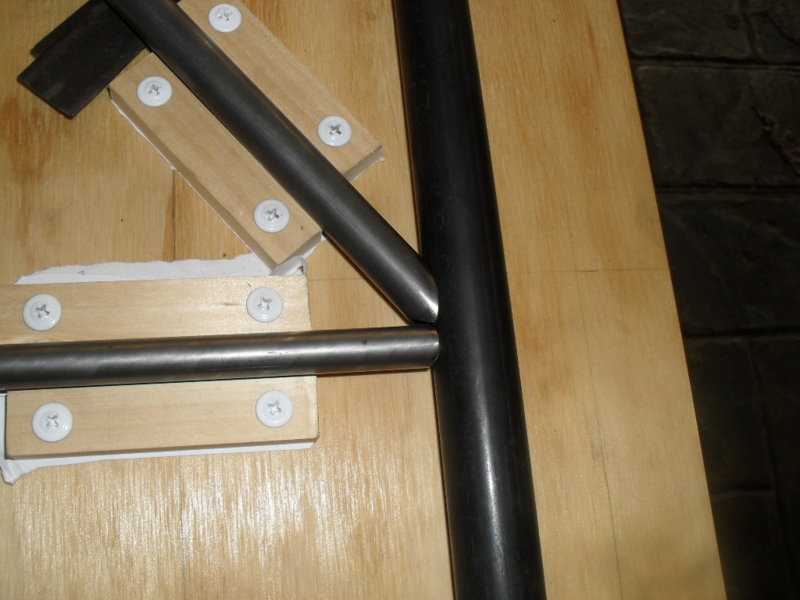

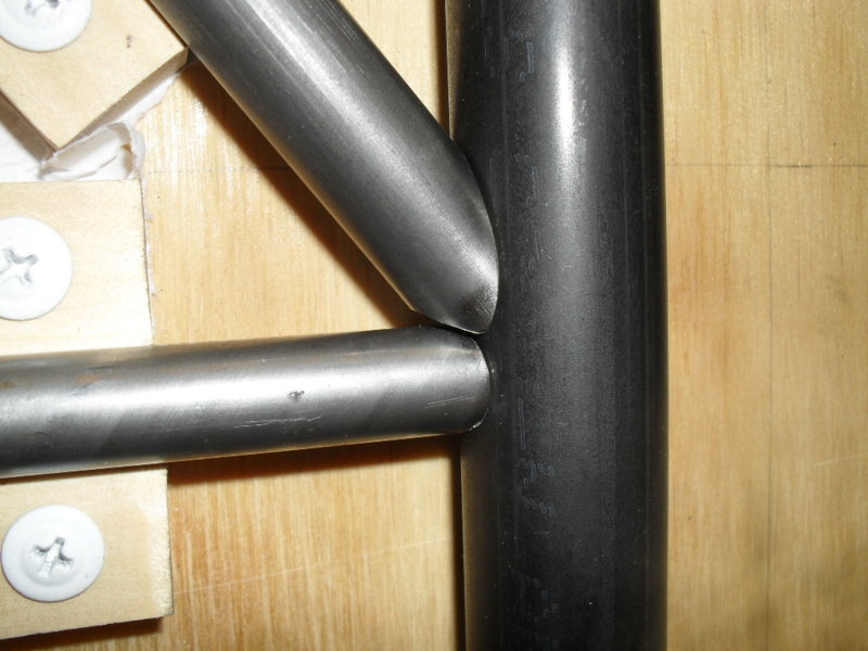

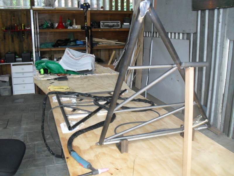

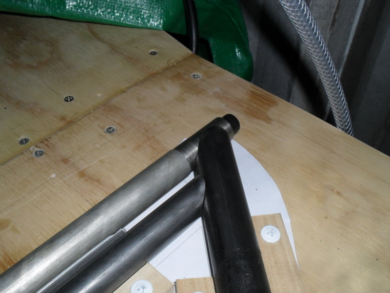

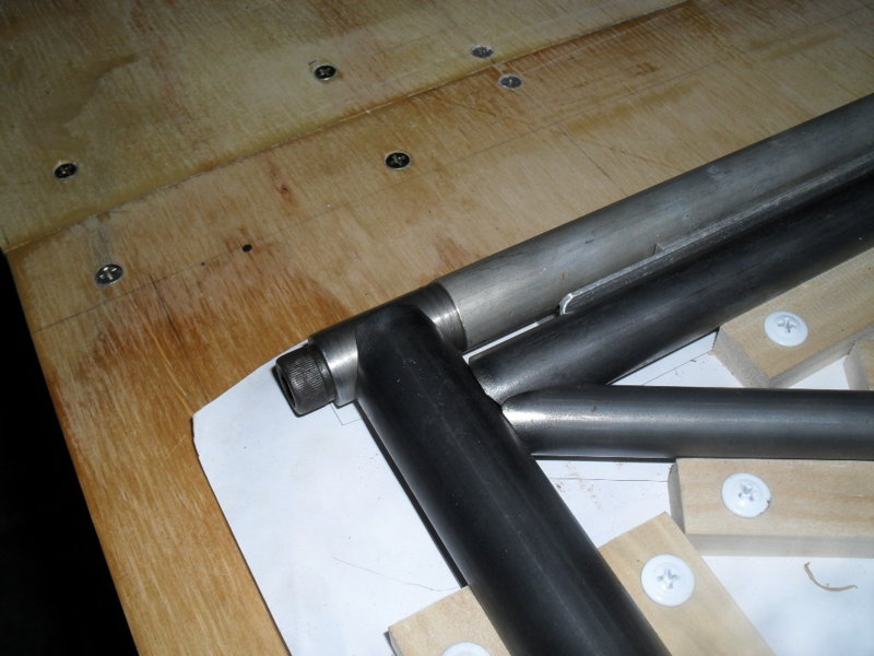

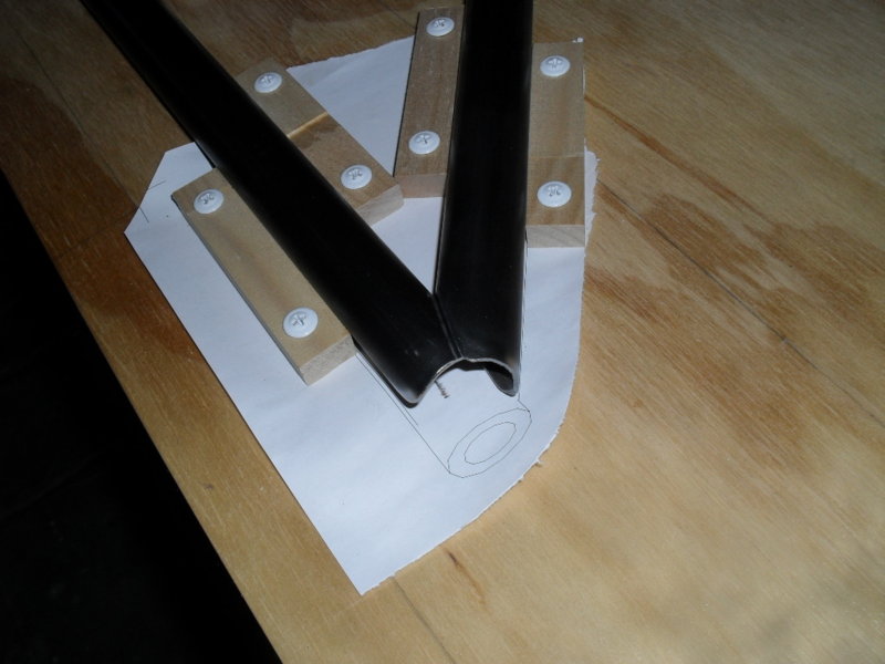

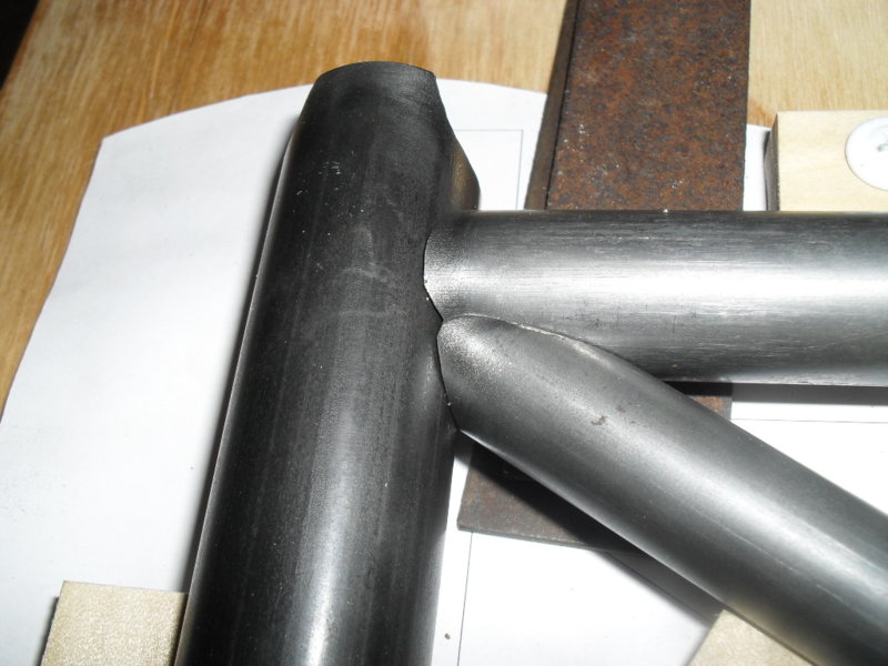

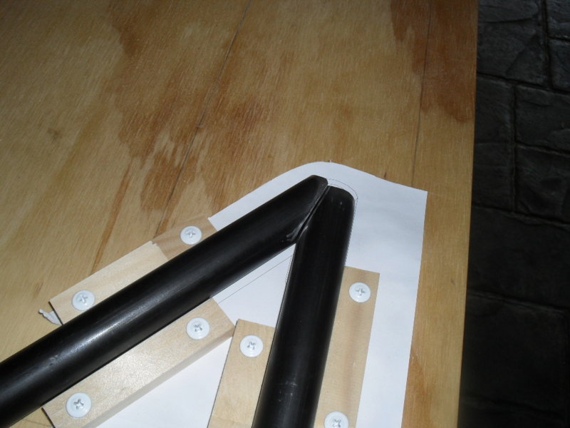

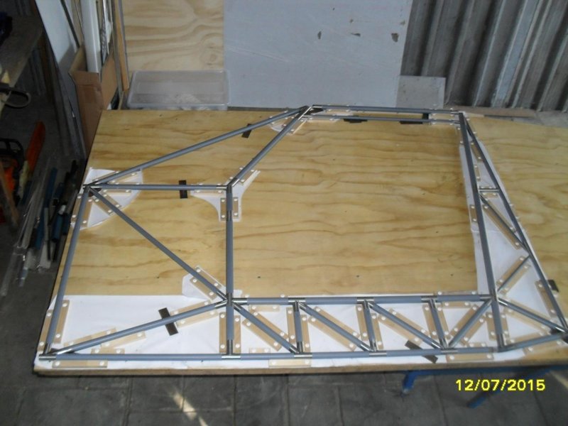

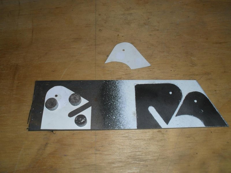

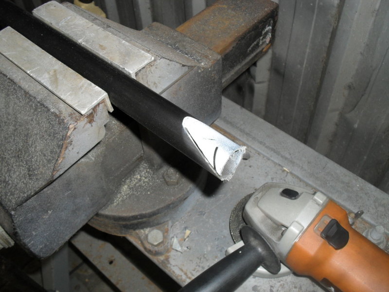

Next was to print and cut out the paper wrap templates for the gear legs. I started with the gear legs as they are thicker walled tubing and would be more forgiving while I got up to speed with TIG welding again - it had been a while.
I opened up the appropriate plastic tubes that I had sealed the tubing into and then cut pieces of steel tubing to length for all the parts for the gear legs, then put the rest back and taped up their covers. Have to be very rust conscious here ...
I held each piece of tubing central in a vice and wrapped each end of it with its wrap template, held in place with a rubber band, and gave it a squirt of auto paint to mark out the notches. It was a very quick process and easy to judge the indexing alignment of each end by eye just by keeping the split in the template at the top (Pics 1-3 below). Four of the tubes were too short to be able to hold them in their centre and still have enough room to wrap the template on each end without moving the tube so I made an indexing line along the tube by scraping a sharp blade along it while holding it in the vice. I used an old electric planer blade which was easy to hold horizontal while running it along the tubing so it made a line that was true and didn't spiral around the tube.
Once the notches were marked and the paint dry I cut the bulk away with a thin cutting disc in a 4" grinder and shaped up the curves to the paint line with a 1/4" thick disc dressed to a rounded edge with a diamond wheel dresser. As long as I didn't try and grind too aggressively the paint stood up to the heat well and provided a good reference for accurate notching (Pic 4).

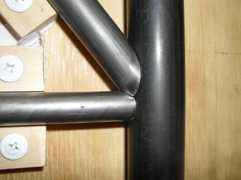

I laid the parts in the jig and they fitted perfectly which was very satisfying (Pics 5-8). I did have one small problem though. I had a software glitch that prevented me notching a tube end for more than one other interfering tube so where a longeron/chord, and two web members all came together the wrap template only showed the notch for the longeron and not the other web member, so I had to cut them by eye. Three turned out fine but one had a gap of about 1/16" so I had to remake that one (Pics 9 & 10). Later I sorted out the software glitch so it won't be a problem again.
The second last pic shows the completed members for the port gear leg in the jig and starboard leg stacked above.

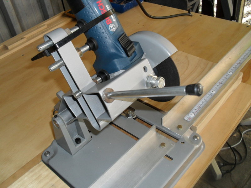

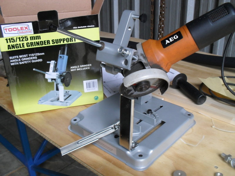

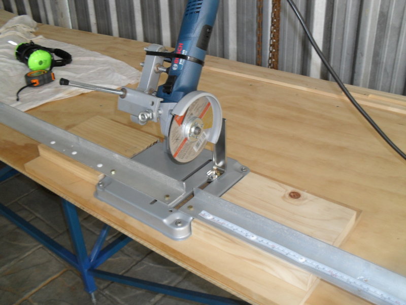

The drop-saw attachment arrived a few days later and predictably it was among the worst of Chinese crap but was a starting point for making something useful ... (Pic 12)
Nicely said.

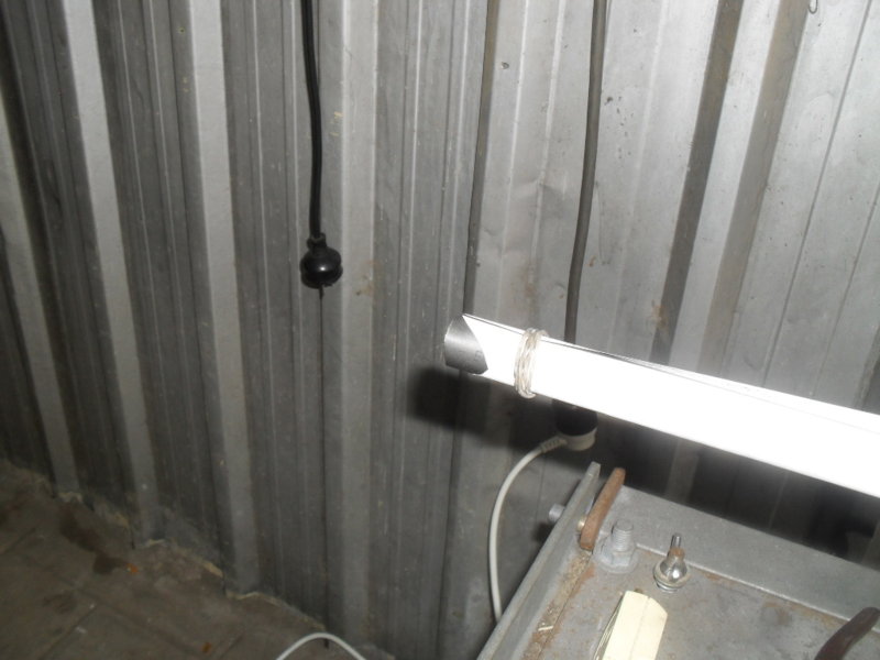

On and off during February I rebuilt the little grinder attachment by re-working the hinge arrangement to much closer tolerances and equipped it with a new dedicated 5" grinder, mounted it all on blocks of wood with rails to feed the material in square and an exit rail with attached measure and stops for cutting repetitive lengths. All a bit fiddly to do but the end result is well worth it, making it a breeze to accurately cut the material to length before notching.

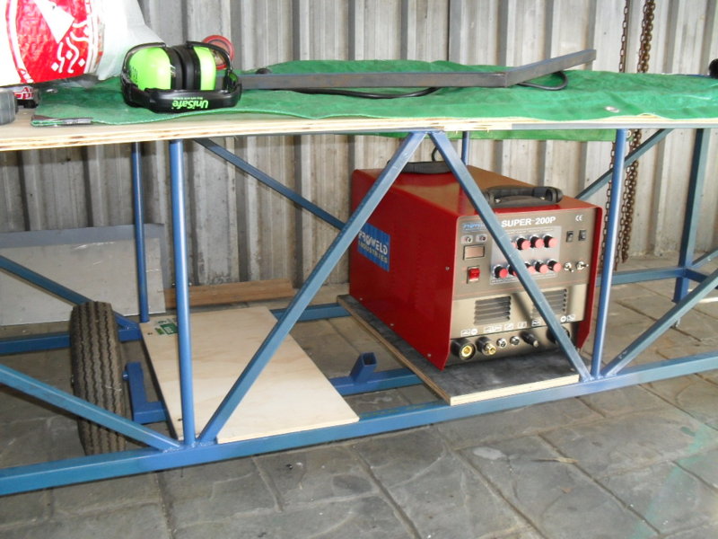

I installed the welder under the bench so that it would be always with the work and also out of the way. That was a mistake which I later changed, but is how it was for a while.

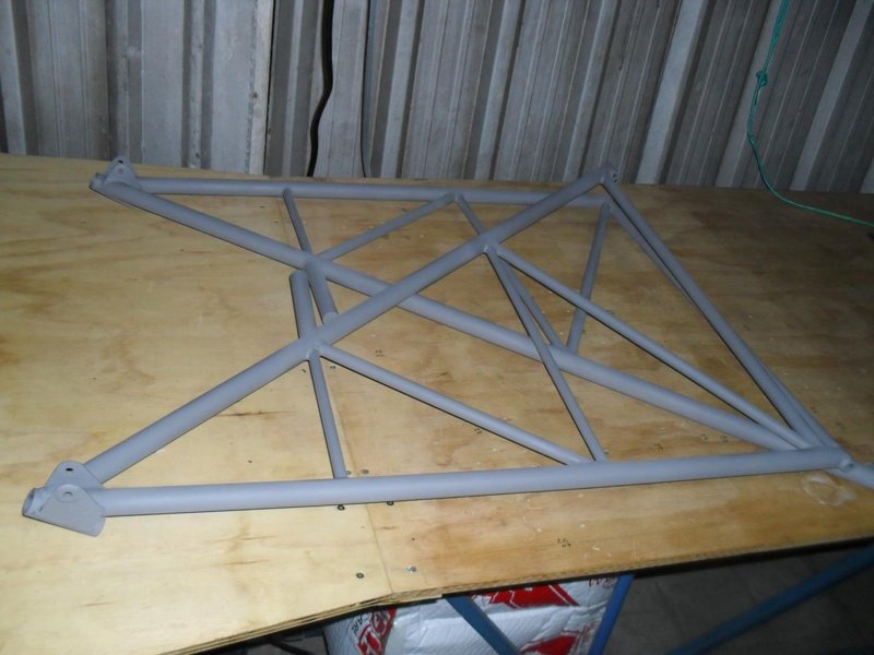

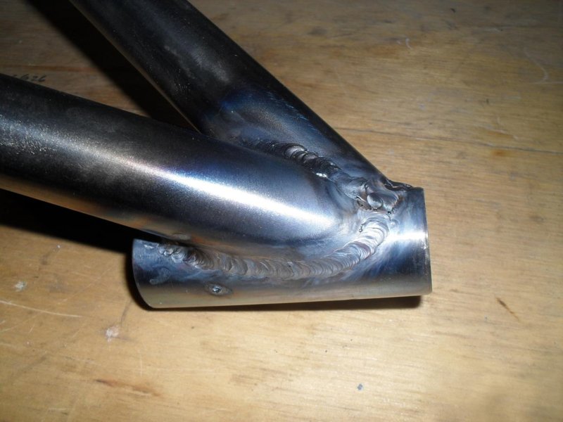

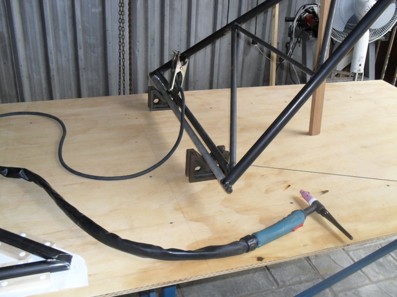

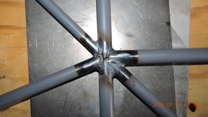

Before diving into welding the landing gear legs I ran a few practice lines and was a bit disappointed how much I'd forgotten so it took a fair few practice pieces before I was happy enough to start work on the real thing.
The next thing was to exactly position the main members in the landing gear jig (post#7, second last pic) and to do that I needed to have the bosses installed. The bosses being the pieces at the top of each of the main gear members which the bolts will go through to attach the legs to the fuselage. Naturally those bosses need to be in exact alignment with each other to allow the legs to hinge up and down without binding. I've had trouble with keeping them aligned in similar situations before, if they're not very firmly held in place they tend to get pulled around during the welding. Consequently this time I machined up the bosses and made a spacer bar to go between them temporarily - the ends of which I bored and tapped so that I could bolt the bosses to them until the welding is completed. It worked well and they were still well aligned after the legs were fully welded out.
Very nice scibe work on your tubes , good fit up for welding, sound way of holding the leg bosses together for shrinkage during the welding progress , great work
cheers gareth

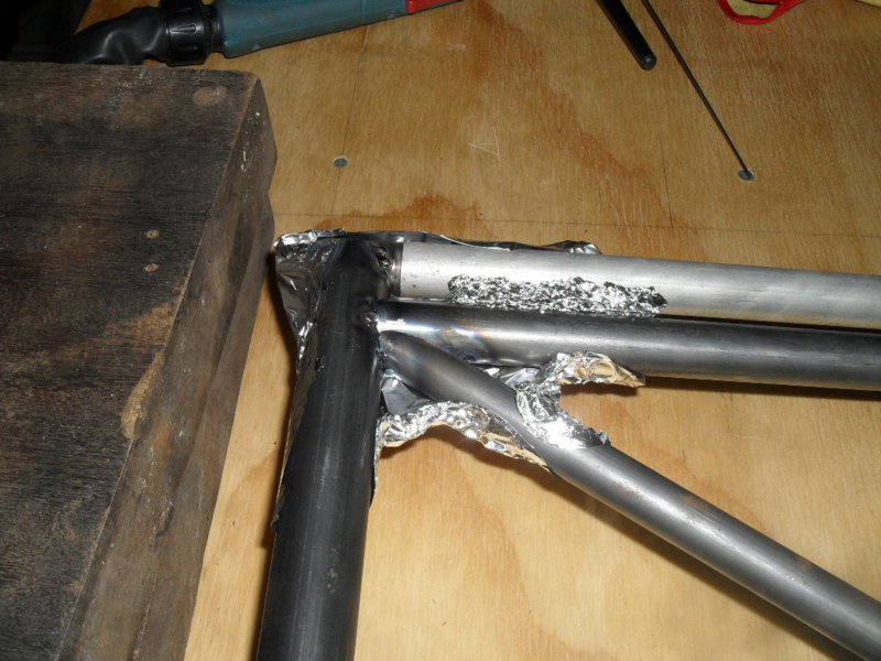

Tacking up the gear legs in the blocking jig, then label (in case I want to build another at some stage) and remove the blocking from the bench and weld out the first leg.
Using simple stands to avoid too much out-of-position welding, and aluminium foil to make argon dams to keep the weld well immersed in inert gas.

The portable workbench is a good solution to limited workshop space. Mine was to leave the car outside to take its chances :) Are you happy that the (19mm?) plywood top will stay completely flat as is? From your pix there doesn't appear to be any supports under the outer edges. My concern would be that it may warp in your sunny Qld weather.
I welded my workbench from 50 x 100 box, then put a 19mm chipboard top on, followed by a second 19mm melamine board. That gave me a nice white plasticized surface to draw on, glue on, screw to, etc. It is 14'6" long by 4' wide (sorry about the mixed units - I'm building an American plane), and is flat & level to as near as dammit. It's also very solid! Pic of framework here:
http://i1303.photobucket.com/albums/ag145/beragooBruce/016Medium_zps1db12389.jpg
I am looking forward to seeing your STOL progress - more power to your Tig hand.
Bruce
Thanks Soleair. I couldn't bring myself to leave the car outside, I've only just changed it over for a newer one after I left the last one outside for three months and it turned to a bucket of rust. The Gold Coast is terrible for rust-as-you-watch.
You're quite right about the (12mm) plywood top warping. I thought it would be OK as I had earlier added outriggers to the wider end of the bench and the narrow end only overhangs the frame by 150mm each side, I thought that would be OK and I wanted a clear edge for clamping. However when I got back to the project mid last month I found all the edges wavy by as much as 20mm! Previously the benchtop had been flat to within one millimetre. Before I put the front fuselage sides into their jig I added timber rails at the end of the outriggers under the edges of the wide end and that pulled it all back level again, I'll do the same at the narrow end when I need it flat for joining the two fuselage sides with the cross-members.
Yours is a nice solid looking bench - and great plane build pics following that, Minimax is looking good!

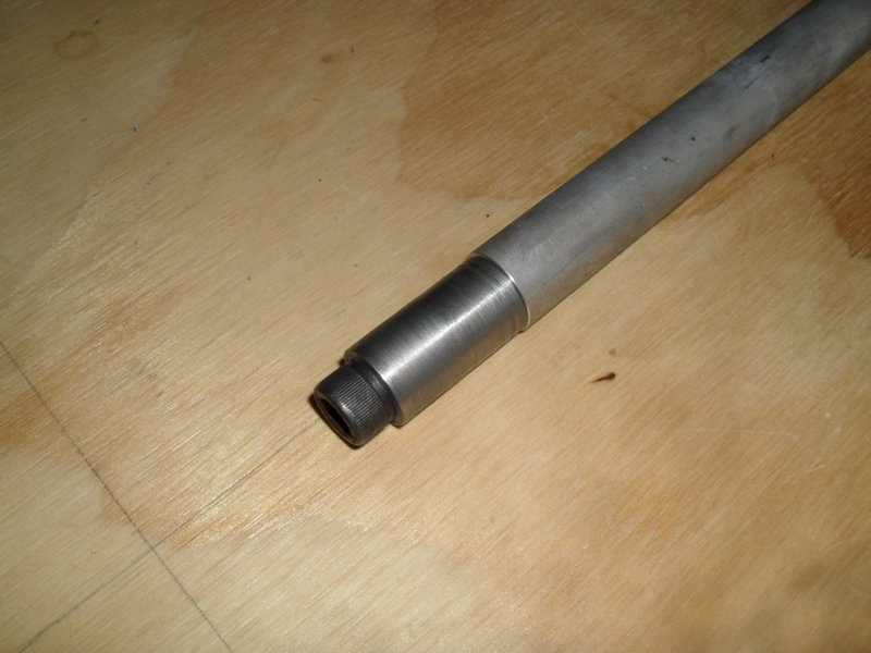

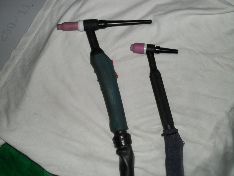

When I got back on the project in mid June (last month) I had decided to get a much smaller TIG torch. I'd put it off before because I'd been chasing one here for some while and could source various parts of it but not the whole kit so I just ordered the lot from China and when it arrived was good timing as I had some spare time again to get back to the welding, so I used it to weld out the other gear leg which I had tacked in February. It was a vast improvement and the gas lens and flexible head made welding a joy.
I also discovered 2% Lanthanated tungsten electrodes which I found I could run right down to 1mm diameter and they still handle the HF start nicely and coped well enough with the heat when you have to give it a high burst for tricky spots deep in the throat of a cluster. I was really pleased to change away from thoriated tungsten as I've recently lost a friend to cancer of the esophagus and associated parts and it's likely it was a result of long term grinding of the tips of thoriated tungsten. He was a many-year welder for the RAAF. Thoriated tungsten is sufficiently radioactive to carry warnings about the risks of their use and particularly the dust from grinding them.

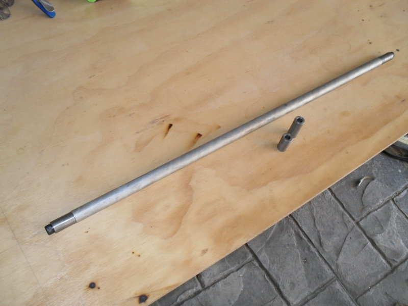

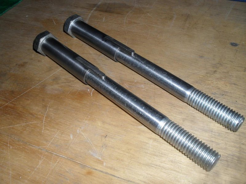

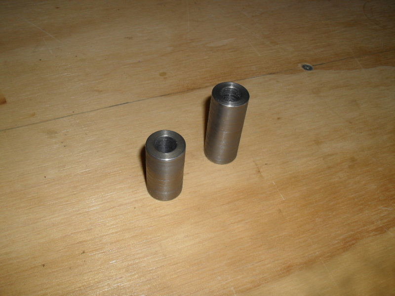

I followed that with making the bosses that carry the axles, got a friend with a larger lathe than mine to broach the keyway into them and mill a matching key-way into the axle bolts (the key stops the axle rotating under braking loads) and set up a simple jig for installing the axle bosses at the right angles and welded them in.
Then I needed to make the cleats to weld to the sides of the axle boss which will pick up the bottom of the oleo strut so I modelled them in CAD, created a drawing of them full-size, printed the drawing and cut it out to use as a template. Held the paper templates to some sheet CRMO with magnets and a squirt of spray-paint produced shapes to cut out. Soon I'll need to get on and model all the rest of the cleats for the project and produce the CNC files so I can get them laser cut, it's pretty tedious doing them with an angle grinder and floor drill -

It means they limit their capital outlay and make their suppliers responsible for QA and production efficiency, and no problems with employees, wages, insurances, workplaces ...

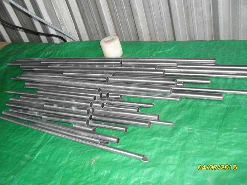

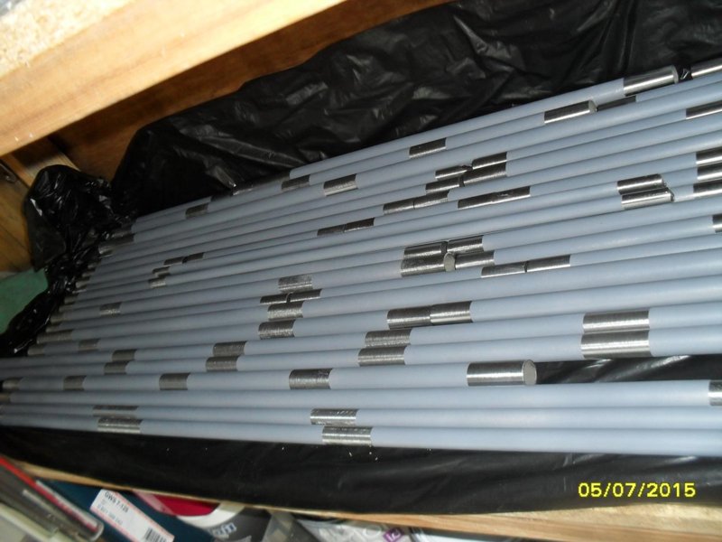

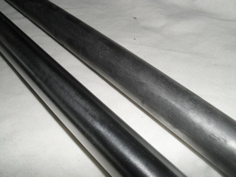

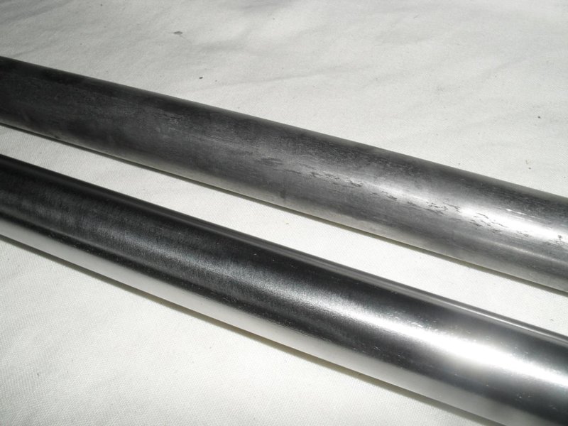

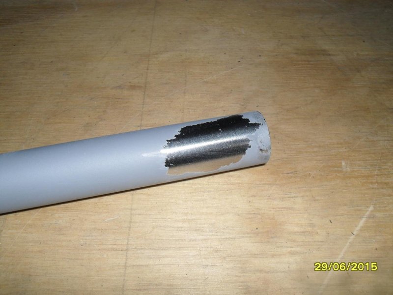

I've built three steel fuselage aircraft before and always had the same problem, rust coming through the frame paintwork after a while. Admittedly it has been because of poor preparation for the painting and using the wrong paint, on one occasion the dope applied to the fabric ate into the paint ... and in other areas the paint hadn't adhered well and could be scraped off easily.
Part of the reason for the poor preparation is that it's a real PITA abrading the airframe once it's all welded together, getting into the all the nooks and crannies is a real problem. Additionally cleaning all the mill scale off the areas to be welded is quite difficult, so this time I decided to take a different approach and get the scale cleaned off all of the steel tubes before they were notched for welding, and then get a coat of primer on it to prevent it rusting. I could easily enough clean the paint off the areas that will be welded when I was ready for that, re-prime them after welding and eventually apply a two part epoxy topcoat.

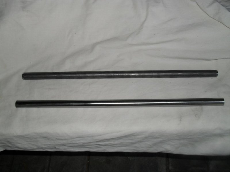

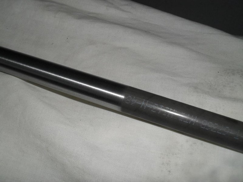

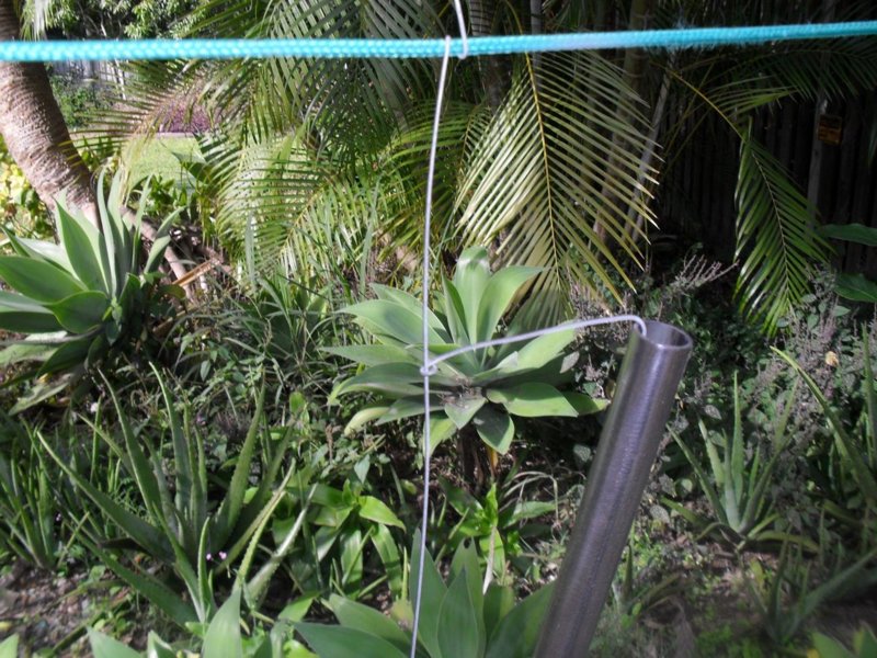

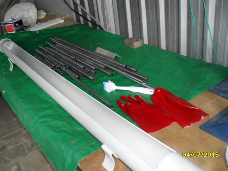

At the suggestion of a friend on another forum I put the tubes in the lathe, spun them fast and wrapped sandpaper around them. It ripped the scale of beautifully. Then I went to finer and finer sandpaper (to 180 grit) and finished them off on a wire-wheel in the bench grinder. Painted them with the suggested Zinc Phosphate primer and was ready for the next stage - so I thought. I didn't get back to them for a week but even having cured for that long I found I could easily scrape the primer off with my fingernail. I use the same primer in aspects of my work and it adheres tremendously well to mild steel so I reckoned it was most likely the chromium in the chromoly that was making it so hard to get paint to stick well.
I arranged a visit with the paint company's chemist to see if he could shed some light on what was going wrong. It turned out the preparation was 'too good' meaning that the fine git and wire-wheel had left the surface too smooth and therefore without sufficient keying and also he suggested that a self-etching primer would be better. Etching primer is usually only used for non-ferrous metals like aluminium, zinc, brass, copper and stainless steel, and it's used on stainless because of the chromium so it's a reasonable assumption that some of the problems I have had have been due to the chromium in the chromoly.
So - the tubes went back in the lathe to sand all the initial primer off and were then masked to avoid having to clean off the areas to be welded, and then painted again with etch primer. Much better adhesion this time.
Pictures show the descaling of the tubing, painting, easily removed first primer, PVC tube 'bath' for washing the tubes in thinner prior to painting and the second round of primer -

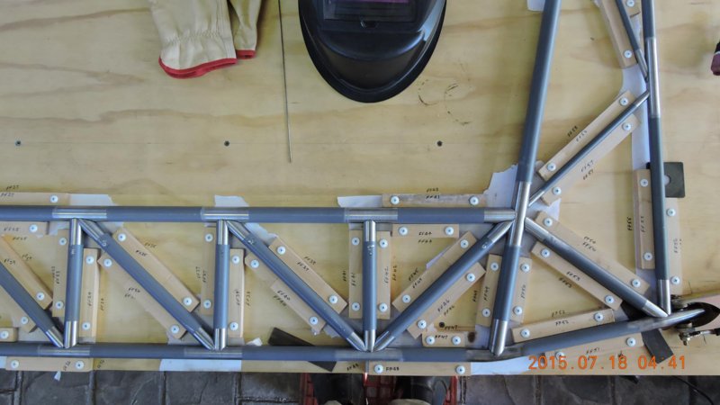

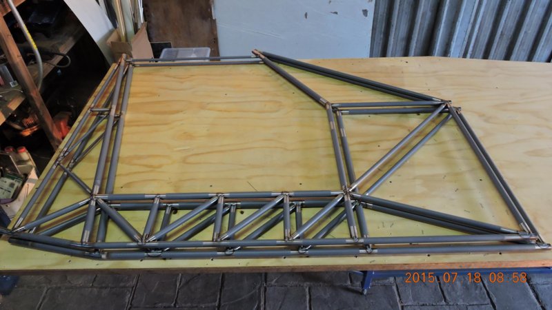

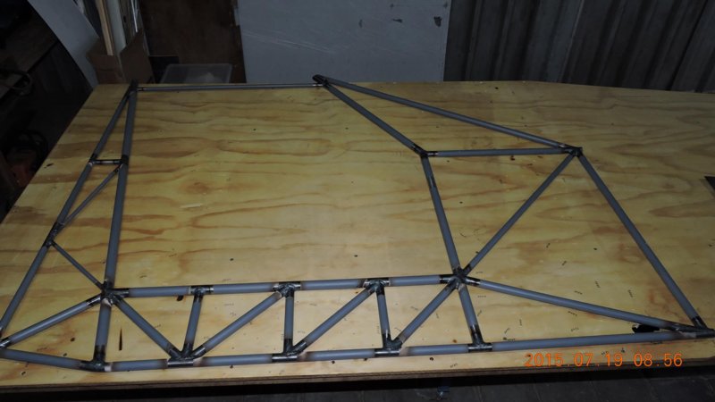

We're getting close to catching up to the present time with these log excerpts now - the next stage was to manually abrade and paint the landing gear legs. I hadn't de-scaled the tubing for them in the lathe so that was a job that cost a fair bit of skin off the fingers, back-ache and some muttered obscenities.
It seems a lot longer ago but just two weeks ago I finished wrap templating and notching the ends of all the tubing for both of the forward fuselage sides. Once they were notched they were too tight a fit so I then had to adjust them slightly to fit them up in the wood-block jig which I had set up in January. That's when I discovered the unsupported edges of the ply had warped a fair bit and had to add some timber bracing underneath which pulled it back straight again.
By that stage I had spent 135 hours on the project (apart from 2 years of spare time designing it) but included in that is the time to make the bench and little dropsaw and setting up the welder.
Pics of the painted gear legs, keyed axle bolts and the first side of the forward fuselage in the jig waiting to be tacked -
As I mentioned earlier, after I used it a bit I didn't like the arrangement of having the welder under the project bench so a couple of weeks ago I retrieved an old wheeled cabinet from my storage, refurbished and painted it and turned it into a dedicated welding trolley. Now I can move it around the shop easily and have good access for changing the welder settings, a rack of sealed tubes for the different filler rods, the cupboards below contain all the torch accessories and from a surplus shaded pole motor I also made a dedicated small wheel grinder for dressing the tungsten electrodes.
During last weekend 17-19th July I tacked the first forward fuselage side together, removed it from the jig and on Saturday fitted up all the parts for the second side, tacked that one, labelled and removed all the jig blocks and tacked the other side of both frames.
On the Sunday I completed the welding of one of the sides. The welds were quite pleasing, and still improving -
Total hours to that stage were 149hrs.
