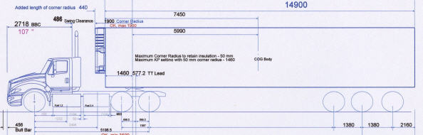

As far as "guessing" and "no empirical evidence available", I can tell you about the design of one piece moulded, frame-free sandwich construction refrigerate vans where Australia leads the world, because I was directly involved in it.
When you see one of these on the road, have a look at the refrigeration unit, it's bolted to two pieces of MS flat enclosed in the FRP.
In the semi trailer refrigerated vans, the lights, heavy duty door hinges and cam locks are all bolted to small, localised steel plates, as are the skid plate and the tri axle
suspension. The one piece FRP box is structural, has no chassis.
About 14.5 tonnes static load is going through the skid plate and about 17 tonnes through the tri axle suspension.
As for empirical evidence, the first of these went on the road about 50 years ago; most are still in service.

Reinforced Plastics Pty Ltd built the first and converted the market from the much less efficient steel/aluminium framed vans, and were joined by Athol Hedges Pty Ltd, a Brisbane based builder.
FTE was started some years later by the RP General Manager, and one of the draftsmen, still make them, and do a magnificent job.
Some of the 1965 vans have been on 7 or 8 cab/chassis, and usually the only maintenance required is a repaint. A few have been lost in major accidents, and several more failed after minor skin damage which was not repaired, allowing water in to the sandwich panel destroying it. I keep a watch around the eastern states, the old ones - RP and Athold Hedges can be identified by their front clearance light recesses, and I'd suggest that about 80% of all production is still in operation.
