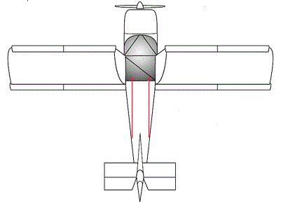

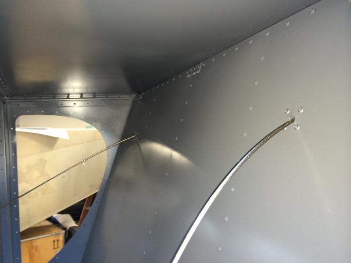

Marty_d Posted May 18, 2015 Posted May 18, 2015 There are lots of harnesses available, with different types of release. I liked one British brand which claimed to be the lightest on the market. The £350 price didn't put me off as much as the lack of information. Some recommended brands were tempting, but call me an old grump: if the website doesn't show a phone number- even in the fine print- then I'll go somewhere that does.After lots of research I found a seller prepared to take my call and answer a few questions and even put the package on the scales for me. I settled on a cheap 5-pointer, costing $142 delivered. http://www.motorsportaccessories.com.au/index.php?option=com_virtuemart&view=productdetails&virtuemart_product_id=523&virtuemart_category_id=3 It arrived today; total weight 2.5kg as promised. Heavier than I wanted, but it might have cost a few hundred dollars to save a kg. The release is a bit agricultural, but looks .simple and reliable. One thing I don't like is the position of the lap belt adjusters: great lumps of steel right on my hips. I might install some thick padding. Looks great OK! I can see what you mean about the adjustment positions but I do like the "agricultural" release. I'll need to get one with a Y branch at the top so the shoulder straps can join together and link to cables which runs through the baggage shelf and half way down the fuselage. (Kind of like this): There's no hard points on the 701 for 4 point harnesses, so this modification just moves the side bracket down the fuselage top corner until it's longitudinally in line with the centre of each seat. Red lines on the diagram below might be clearer. 1
Old Koreelah Posted May 18, 2015 Author Posted May 18, 2015 ...There's no hard points on the 701 for 4 point harnesses...[ATTACH=full]35691[/ATTACH] That's a bit of a problem, Marty. Seems like a slight oversight on the part of the designer. I used your solution on my BRS harness. The cables are anchored on the rear wing attachment points. Looks like your 701 has slats. Are they fixed or automatically deployed like Handley Page? The tailplane seems quite narrow, presumably for trailering.
