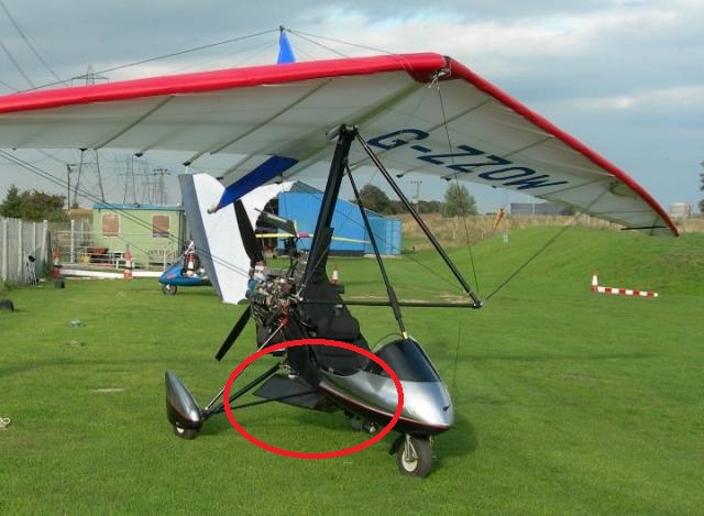

kasper Posted April 20, 2015 Posted April 20, 2015 An alternate is rotational molded plastic - take a look at the Raven Eclipser trike - that is a big black 42L plastic tank under the keel held on with two bolts ... and if/when the main undercarriage goes it's on the ground ... and it it strong enough to take the entire weight of the aircraft and slide along to a stop without bursting ... trust me I KNOW it to be true - I have the bill to rebuild the plane to prove it :-( But the tank was fine - just a couple of scratches - it pressure was tested and reused
