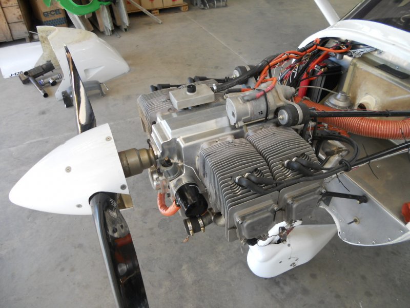

Some of the 2210 features are attractive, especially the Nikasil bores and castings. The pic they released shows a very different induction system:
The "new" cylinder would no doubt permit closer clearances to be used in the piston/cylinder dimensions, which should reduce blow by and hot spots. A still can't work out why the spigotting into the head is so deep. There would have to be some problems with heat transfer in that area unless it's a close fit, making dismantling a bit more complex. Nev

Carbs sit higher and use runner, you can actually see it in the 2210 photos i think with induction pipe for third cylinder facing out front forward of engine
...you can actually see it in the 2210 photos i think with induction pipe for third cylinder facing out front forward of engine
The 90 degree bend in that pipe wouldn't be conducive to good gas flow. I thought it might be part of a cabin heat system.
The photo also shows the little springs used to secure the ram air ducts. Why don't they just use a fence around the engine like everyone else?
