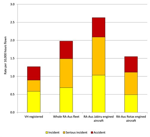

Depending on the outcome of the ATSB light sport engine review, CASA could consider expanding restrictions to all RA-Aus self serviced aircraft given the lower engine failures or malfunctions (particularly serious incidents) of VH registered aircraft compared to RA-Aus fleet.
Using the 'not as good as Rotax' measure LAME serviced aircraft (including Jabiru's) outperformed everything. Especially considering the rate below for RA-Aus aircraft includes aircraft serviced by L2s and LAMEs, so what would it look like if you separated those aircraft serviced by owners from the total RA-Aus figures, especially on the number of serious incidents.
Going further, a possible outcome is, if there are 'enough' failures of other light sport aircraft engines (in CASA's opinion), that the restrictions (in some form) gets expanded across the whole RA-Aus fleet with CASA claiming that it is necessary because LSA as a whole is not as reliable as GA.
https://www.atsb.gov.au/publications/2013/ar-2013-107.aspx
Going further, a possible outcome is, if there are 'enough' failures of other light sport aircraft engines (in CASA's opinion), that the restrictions (in some form) gets expanded across the whole RA-Aus fleet with CASA claiming that it is necessary because LSA as a whole is not as reliable as GA. [reference deleted for brevity]
Exactly the points some have been making since before the restriction was implemented when some people here were hinting of their inside knowledge of forthcoming action against Jabiru. The message then was "be careful about letting the genie out of the bottle". The question now is: How do we control the genie?
You can justify anything with stats. If you look at the owner serviced sector you will probably find some of the absolute BEST and some of the worst. LAME serviced, there will perhaps be less of a spread, but no guarantee of absolute BEST. and can still be BAD
VH registered isn't just recreational (equivalent) It probably includes multi engined aircraft and charter etc. You either need to specifically identify a problem, or approve a situation that will be satisfactory or meet a standard. The engine has been the target (or maybe an organisation ). NOT HAPPY. Not as good as Rotax is a weird reason. A Technam isn't as good as a Lear jet either
You can justify anything with stats. If you look at the owner serviced sector you will probably find some of the absolute BEST and some of the worst. LAME serviced, there will perhaps be less of a spread, but no guarantee of absolute BEST. and can still be BADVH registered isn't just recreational (equivalent) It probably includes multi engined aircraft and charter etc. You either need to specifically identify a problem, or approve a situation that will be satisfactory or meet a standard. The engine has been the target (or maybe an organisation ). NOT HAPPY. Not as good as Rotax is a weird reason. A Technam isn't as good as a Lear jet either
The "not as good as Rotax" is a red herring FH.
The ASTB doesn't seem to agree with you on that Turbs. Did you read the attachment in O1rmb's post @ 1029 particularly, the 10 December update?
I haven't found the ATSB's actual numbers from reading that document, but it only covers four years 2009 to 2013 and to me it would make more sense just with the raw numbers.
I pulled the figures from the RAA Magazine over 59 months from Feb 2007 thru Mar 2012, and any serious discussion of failures would go back a lot further than that.
What the RAA magazine produced in terms of either forced landing reports, or engine landed in a state where it couldn't safely take off were:

The ATSB report, per 10,000 hours is Jabiru 2.6
Rotax 1.5
Make what you will of those, but the ratios are startlingly different. You would hope that ATSB haven't included the smaller Rotax two stroke engines in their figures, which would certainly skew them, and if they did then how much trust could you put in the rest of the data.
