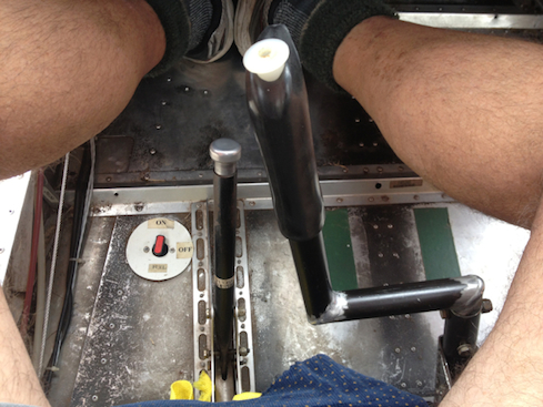

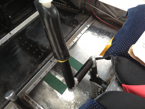

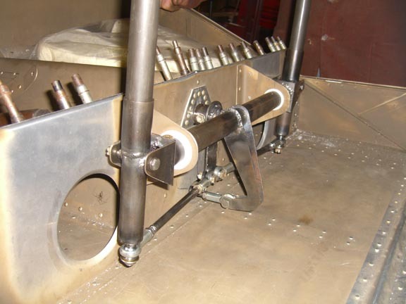

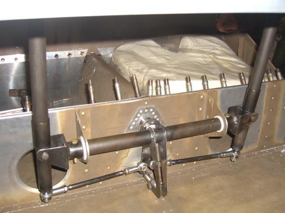

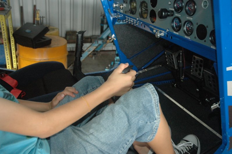

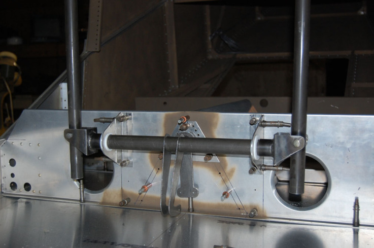

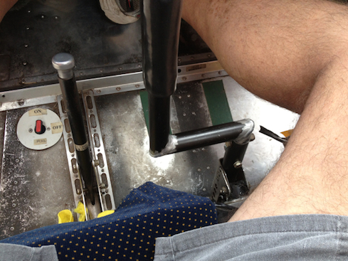

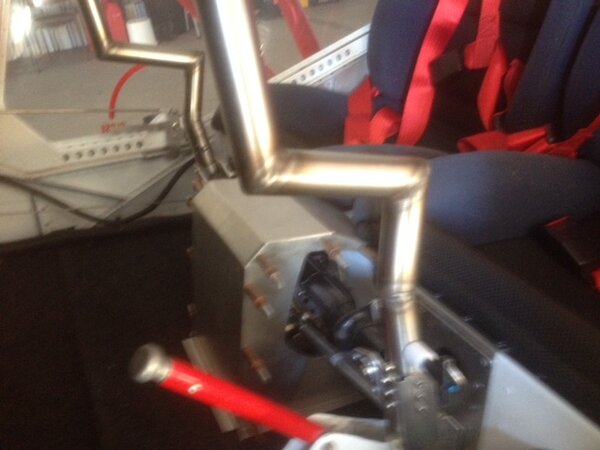

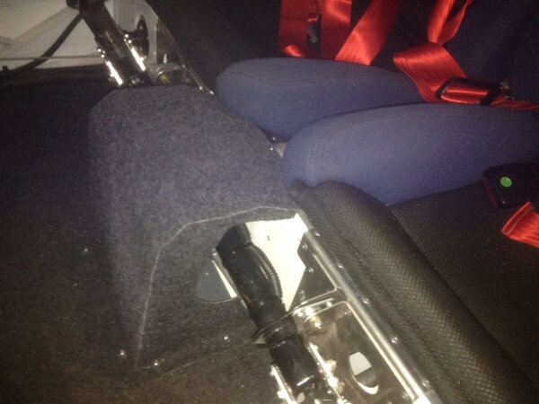

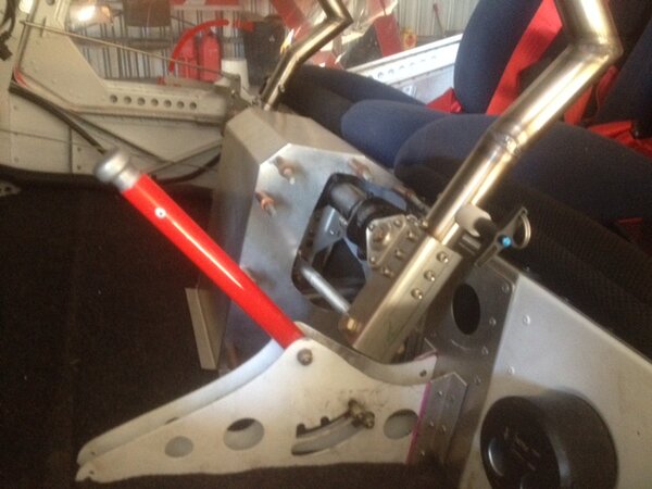

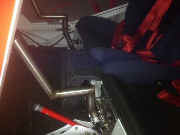

Kyle Communications Posted August 22, 2014 Posted August 22, 2014 has anyone out there got a factory fitted dual control system . I know Blair Rowan had it done on his first S model but the sticks were way too close to the crotch for my liking but that can be modified. I am looking seriously and converting mine to dual sticks as I do sit slightly shifted on my bum when flying due to my large size...I reckon if the stick was between the legs I wouldn't get the sore right bum bone after and hour or more of flying. Removable stick or fold down would be a consideration as well. I found some mods done by others attached are a couple of pics and a video
eightyknots Posted August 22, 2014 Posted August 22, 2014 I have read of a few Foxbat/A22/Valor aircraft owners regretting that these planes have dual controls and wished a centre Y stick was possible.
Kyle Communications Posted August 23, 2014 Author Posted August 23, 2014 The reason I am looking at it Hank is one of pure comfort for long flights. In the current config my right leg is slightly shifted to the left when flying straight and level. After about an hour of flying my right bum bone if you want to call it that starts to get sore. It is obviously got something to do with offsetting my right hip a little bit. Even in the XL ...it would be far worse in a VG. Its only been a problem since starting to do 1 to 2 hr nonstop flights. If I can shift the stick to the middle of my legs then I can sit straight and I should be able to fly for many hours non stop. There are a few options but I want to keep it so the centre stick can be used or a between the legs stick can be used as well. Either stick will be removable so you can have it either way. Ken from Kilcoy did it a simple way but the stick does lay over a bit during aileron control pics are attached. He has a old VG and he has a crook back and hip as well I think and this solved his issue. I would like to make the stick control more symmetrical I am getting together a model of the current control setup and mating wall so will be able to make up a demo to prove the theory. I will post some pics she I have it sorted

Kyle Communications Posted August 24, 2014 Author Posted August 24, 2014 The centre stick is fine for short flights for me up to an hour but after that there is too much pain....yokes would be way to difficult for a savannah control system I have a few ideas spinning around in my head will make some test samples up and see how they go. For a start though that extension stick idea would be a good trial even if it does go a little lop sided Mark

robinsm Posted August 24, 2014 Posted August 24, 2014 if its to close to your crotch, put a bend the stick away from you...
rankamateur Posted August 25, 2014 Posted August 25, 2014 I think the stick in your crotch needs to be longer for comfort, not enough leverage with the factory ones. The bend might also help, it works for the flap lever.
Kyle Communications Posted August 25, 2014 Author Posted August 25, 2014 Thats why I changed the geometry on the flap lever...stick length isn't a issue just make it to suit. It will have to have some sort of gooseneck on it as the only real way to put in a second mechanism at least for the pilot it will have to be close to the front wall to be the same as the centre operation. I am thinking of a removable centre stick and just a between the legs pilot control stick. Both just plug in using the quick lock pins in that 701 video I posted. Once I set that up for the centre stick I might do that one like Ken did and plug it i and see how it goes. But I think I will make another setup directly underneath the pilot Mark
